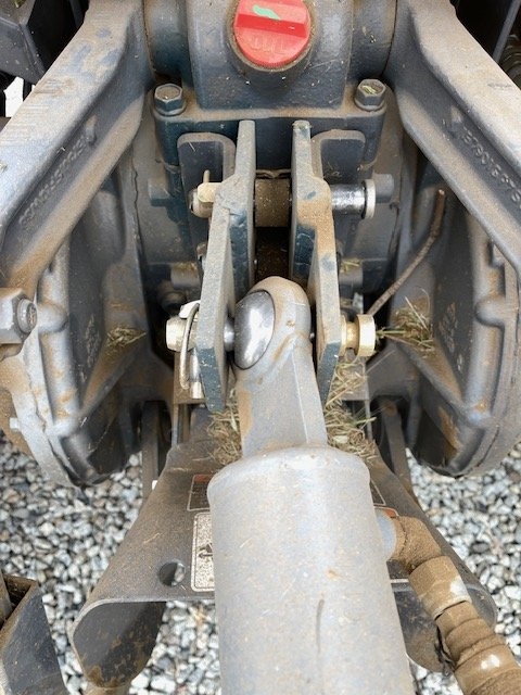

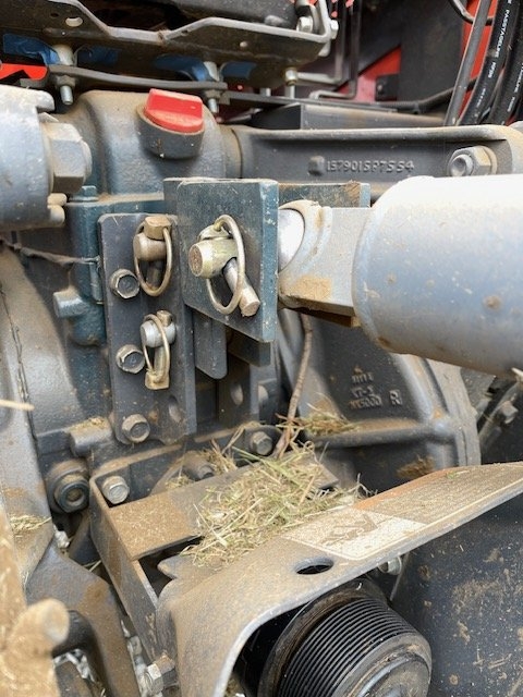

This one has worked for me on my L6060. Still doing fine after 2 years. I did a bit of welding, but not required. Just some cutting of flat bar, drilling and bolting together.
Top link extender

Excuse the dirt, she just came in from mowing. Here is the extension I welded up based upon the 1st picture shown in this thread.

Wsurff and Scootr - thanks for the idea and for taking and sending the great photos. I will try to do something similar. I don't weld - a major regret at 80, but I will find a way to get it done. Again, thanks to you and everyone who responded.

You can use 2 plates pinned or bolted on the outside of the present mount. You need 3 holes in each plate to keep it ridgid. The holes in mine were 3/4 inch. Square plates should work, minimizing the cutting. GL
