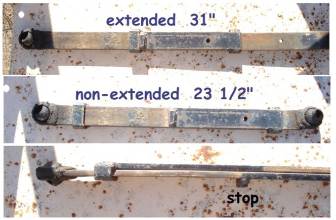

So... instead of having a shear bolt on the ripper, you are using the top link as a shear point.
If you beef up the top link guess what part of the tractor breaks...
I would consider myself lucky that this time an inexpensive part broke.
Know what happens when you assume something?
/ Top link destruction. #13
So... instead of having a shear bolt on the ripper, you are using the top link as a shear point. If you beef up the top link guess what part of the tractor breaks... I would consider myself lucky that this time an inexpensive part broke.
The lower 3 point arms should be capable of taking all the pull the tractor can provide. The implement might break next, but you can beef that up next. The tractor should loose traction before it breaks.

A longer top link may not have bent.
You could make a sliding top link like this with a shear bolt in it.
Or a piece of tubing that will slide over the too short top link and drilled for a shear bolt.

So my assessment of the failure is last week I bent the top link against the brace in the ROPS using my boom pole with the lift arms in the lower hole. I bent it back as straight as I could but I imagine it still had a ever so slight bow to it which allowed the force to "get the advantage".
