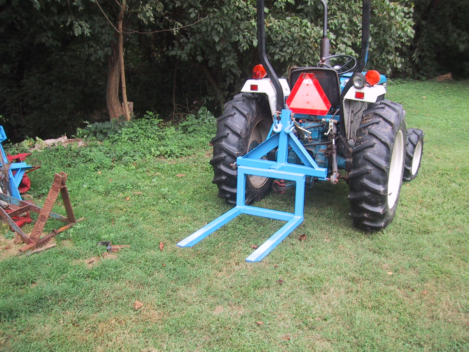

My tractor was missing the top link when I bought it. Can anyone tell me the length that I need to buy??16"...21"...etc...TSC has them but unsure which one I'll need. OE#SBA370010702.:eek:

The easiest way is to hook up your 3-point attachment with the 2 points you have and use a tape measure to see which fits most closely.
The only other way would be post tractor brand and model and have someone measure theirs.

I have a 1715 and I use a short one on mine. The one that came on mine was junk . Replaced with one fron H/F . Also replaced right lift bar with one from a
8n . Cut 5" off and threaded all he way up . Check out picture below.
