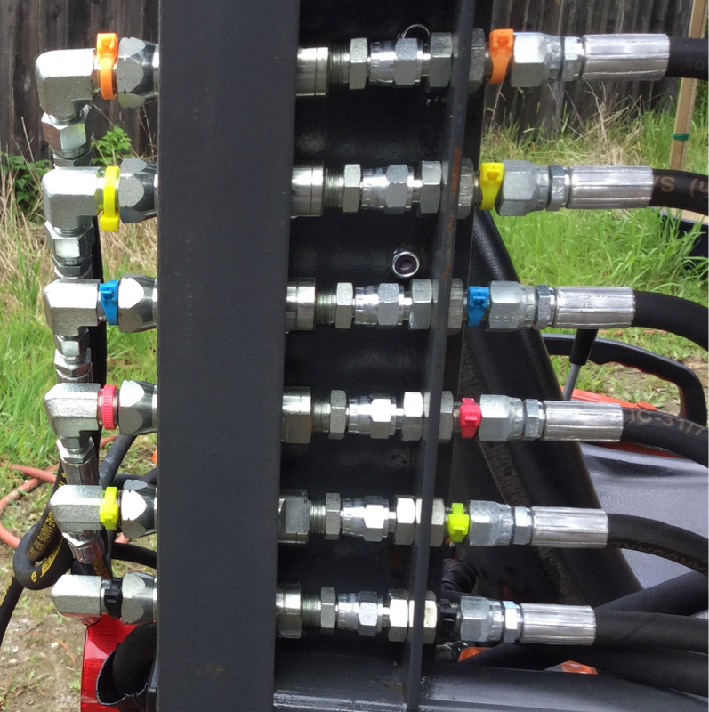

After I worked out the most intuitive use of the valve controls I color coded the couplers with zip ties.

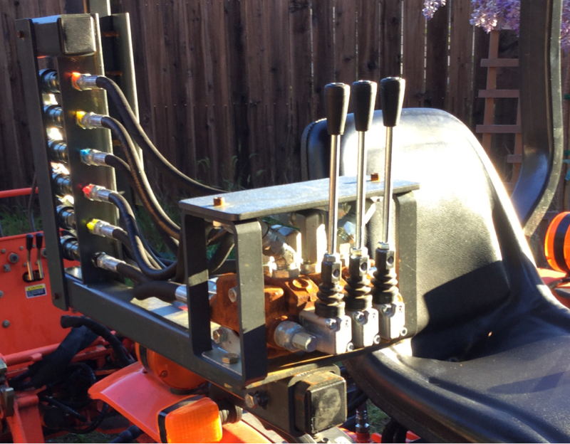

Could you show a few more pics of the bulkhead and valve mounting setup from different angles? This appears to be a very well thought out design.
Thank you.

Here is a better picture of the valve and coupler mount. There is no room next to the fender so I put it on top. I wanted it accessible from the seat facing forward or backward. So the valve slides on the arm. The cover protects it from tree limbs and provides an arm rest. It is one piece with the coupler bulkhead and is clamped to the ROPS. The ROPS mount also has a guard to protect the couplers from tree branches.
   / Top and Tilt DIY Kubota B21 #16
The valve is a Bucher with three spools and float on all three.
Your setup looks great!
In retrospect I think I would like to have float on two valves, so your decision to put float on three valves is probably the right one. Maximum flexibility!

Thanks Bill. I was waffling on one vs two until I saw your posts. I don't yet have any real experience with it, so can't say much about performance, although automatic levelling is indeed very convenient.

I should add on float - I thought it might be useful to be able to choose which side floats. The incremental cost to the valve was just $34 so I figured might as well give it a try.
