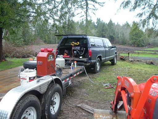

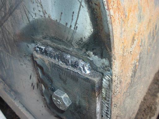

Hot dog, got it on. Only took a couple pictures though, none very good.
I used the toothbar hole as a guide to drill the half inch hole from the inside. No messing around with pilot holes, just grabbed the half incher and poked 'er through.
One tip, don't hit the tooth tip directly with the hammer to set the bar on the cutting edge. Turns out the teeth are brittle and will chip. Instead, use a chunk of wood as a bumper.
Here's the weld.

Of course I welded all the way around and some welds weren't as pretty. You don't need to be a good welder as long as you are a good grinder.
Don't let anyone tell you that a coleman geenrator won't run a Lincoln AC225 220 volt welder.
