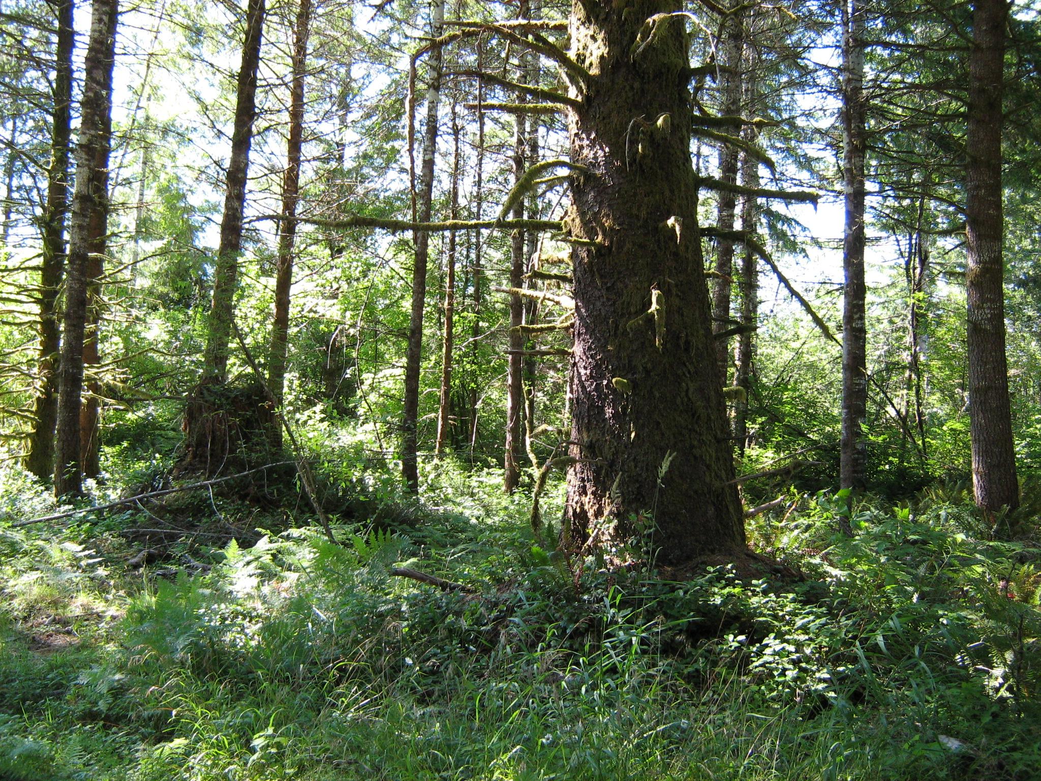

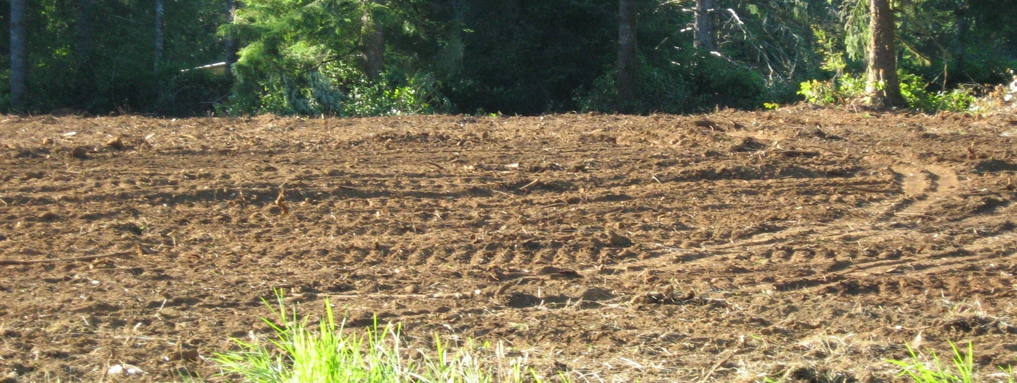

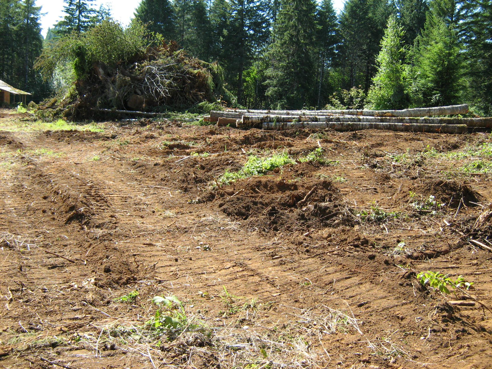

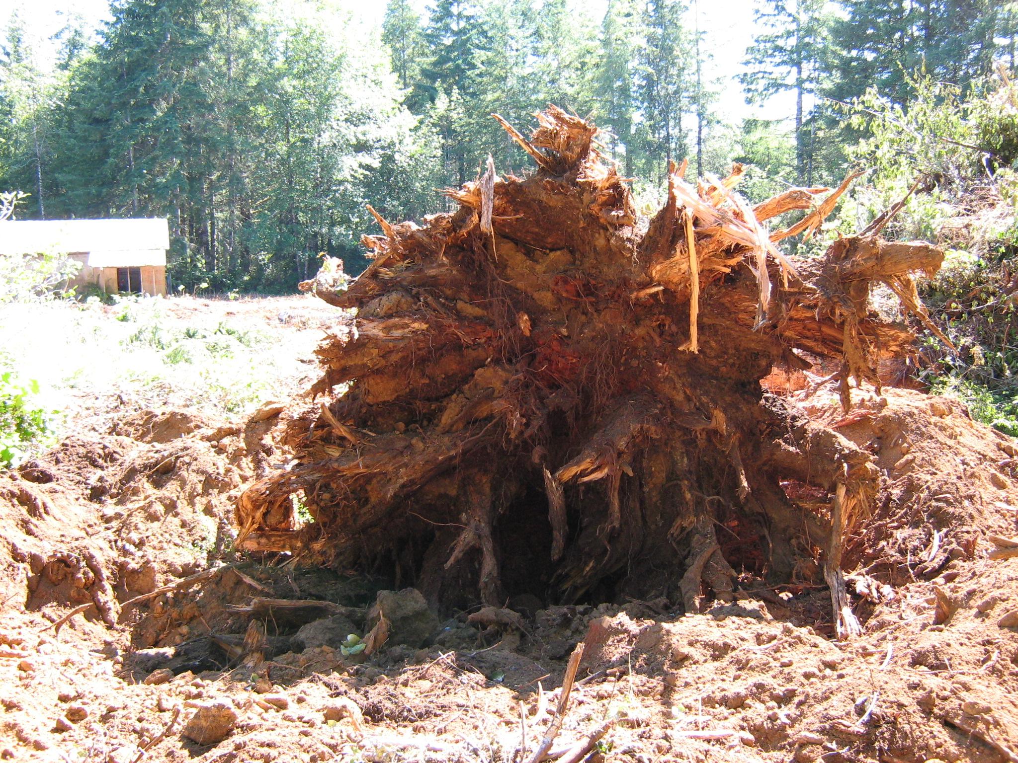

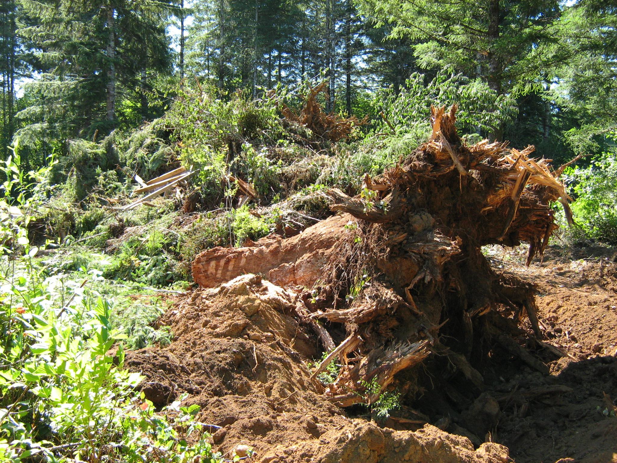

Here are some pictures so far:

You have some nice looking soil there, and it doesn't appear very clumpy, actually looks pretty loose, meaning, it shouldn't be difficult to spread and level. Once the dozer back-drags that stuff, you are going to be pleasantly suprised. Should be relatively flat. Appears that it will only need the top few inches worked down to level/conditioned.
The seeding advice is sound, if you seed in the next month or so, then you will have all of the competing weeds to contend with. If you allow the contenders to come up on their own, knock them down with the Crossbow, then seed afterward, you will have a higher % of what you want, while you have selectively eliminated a good portion of your problem plants. Too bad he is saying Springtime for your final seeding, but, i guess there may not be time left in your growing season to spray, then seed?? I can't speak to your area.
You can always throw down some winter rye, it will hold the soil, and is a nitrogen "fixer" ,so, when you plow it under in the spring, it will add nutrients back.
Back to the soil. Your soil looks rich, loose, and easy to move around.
I was picturing clods, clumps, and boulders of dirt.
If it were me, I would try my Rear Grader blade, my Rake, and I'd follow with my buddy's Drag Harrow. BUT, I say this because that is what I have access to.
I think some of the earlier suggestions about making your own home-brew drag behind would work, now, after seeing your nice soil.
Just dragging around an 18" to 24" diameter by 8 foot log would get you some results toward your goal. wrap the log in some fencing, as was suggested, and drag that around would also help.
I really don't know if a box blade is necessary, or is the right choice for your situation. Before plunking down $400, I'd drag around a Log and then maybe a scrap piece of chain-linked fencing behind it?
Also consider something like a drag harrow?
Ask your buddy who is selling the implements what he would recommend. Sounds like he is close by, and can look and feel the dirt and perhaps suggest the proper tool for the job.
By the way, looks like it will be a great area once established!

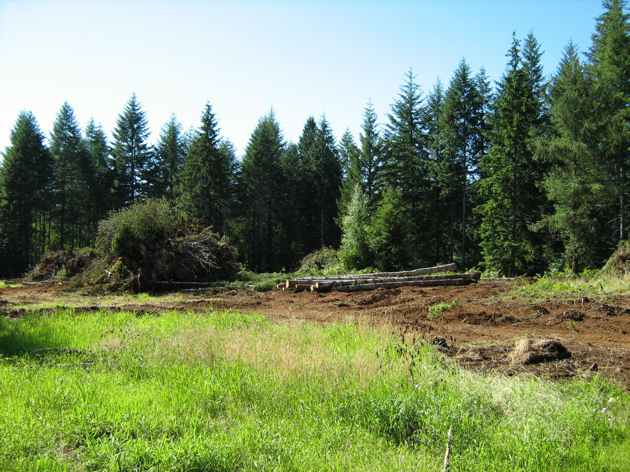

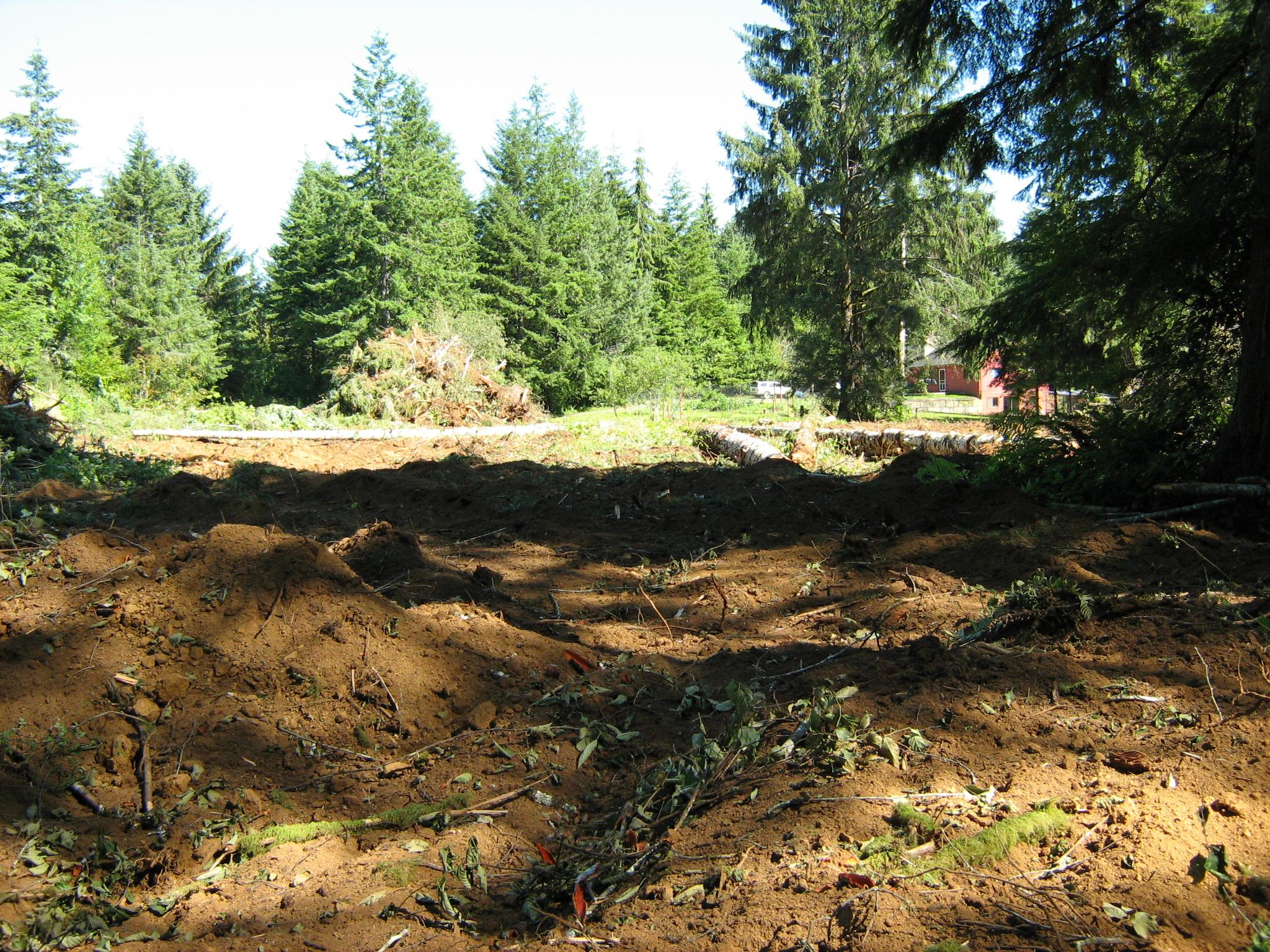

I know this thread is old news, but the guy I hired to clear my future pasture with an excavator just came out yesterday true to his word and brought a dozer to rake acres that he cleared. So here is the finished job as far as he is concerned and I have to take it from here with my box blade. You will also see the drainage ditch that he dug for me.

It looks to me that area is perfect for your light duty boxblade. Doesn't look like a lot of rocks or stumps anymore. You will be moving small amounts of dirt and not really having to dig. You can do it easily with the boxblade. Just take your time and make some criss-cross passes to get it from both directions. Once you get it level and the way you want, get or make a drag harrow. I find using your head when using the tools you have makes it easier on the pocket book. It might take a little more time and elbow grease, but so what. We all want a little more but for some of us, it's not possible. Do as much as you can with what you've got. I admire that spirit.

Those piles.... don't even think about burning them yourself. I grew up in the puget sound and now am clearing portions of my 15 acres in a similar climate. Those stumps are the problem. They will roll out and need to be restacked as they burn. The safe and proper tool for this is an excavator no smaller than the one you had so the clearing. I highly recommend hiring it out which is what I do now after spending countless hours burning from the back of my 30 HP tractor with toothbar and boxblade. Hire any old company that has insurance for these things. My choice is a logger since their equipment will be in rough shape already and they are pros at burning slash. They will get the permit, they will be liable, and they will get it done without hurting you or your machine.
I helped the hired logging/clearing company burn slash this last fall of 2006 and we managed to start 7 or 8 adjacent trees on fire. They were alders with moss on them and the little sparks just set them off depsite the fire pile being some 50 feet away. That large excavator just reached over and plucked the whole tree out and tossed it in the fire. You can't do that with a tractor.
After the burning you will have a large pile of dirt and ashes to spread out. Nothing will grow in the ash but around the piles will grow very well.
Seriously, burning those piles is NOT something that you should do.
