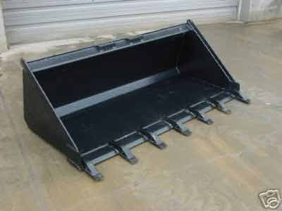

anybody have a pic to post of an installed toothbar? i tried to install mine.. and let's just say that i installed it incorrectly. i ended up mounting it too far forward (aligning the cutting edge of the toothbar with the cutting edge of the FEL). the result was pretty severe:
i managed to bend the toothbar mounts. i think i can salvage them by heating and bending them back into place, but i'd love to see a pic of one installed before i do this again. i just noticed a pic on an TBN advertisers page.. and that pic does not match how i installed mine.
here's a word for those marketing toothbars:
how about some directions for us morons?
pf

thx guys.. now i know what i did wrong. and BOY.. am i ever gonna hear about it from my wife (who was trying to help out!). i should have installed the groove @ the edge of the teeth. didn't do that.
instead, i spent time drilling holes where i should NOT have drilled holes (the large blocks on the edges of the FEL). now i'll have to salvage the installation.
MAN.. the more i use it, the more i learn.. but boy, i better start asking questions before i drill.

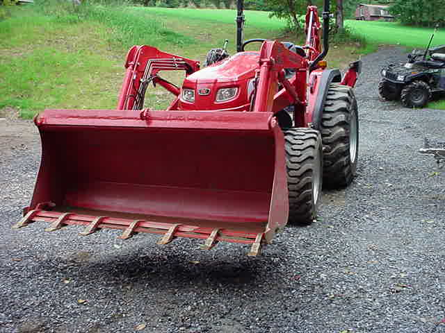

I installed a tooth bar on my tractor this fall.
It has worked great. It digs like a differant tractor
Dave in NH
