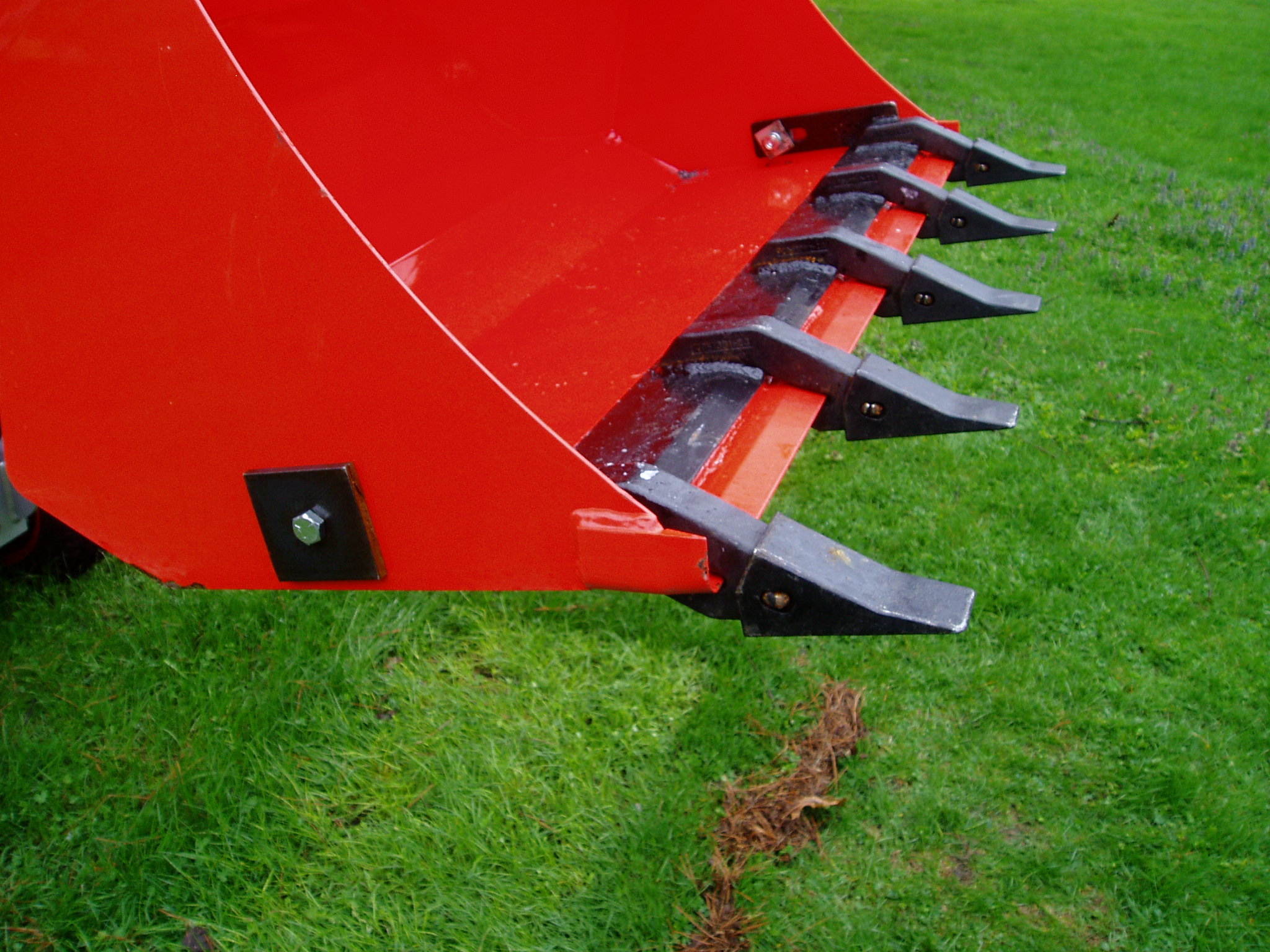

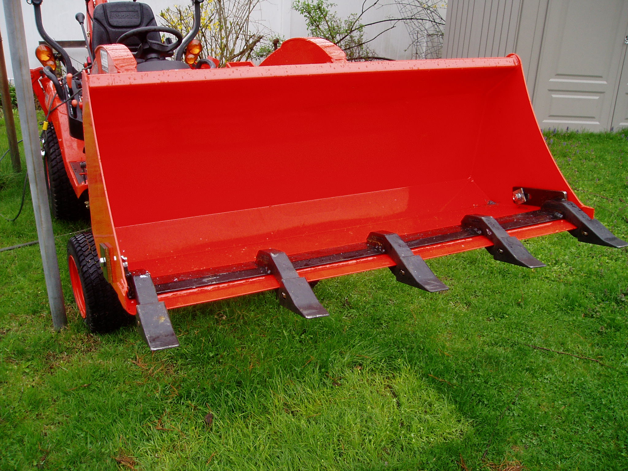

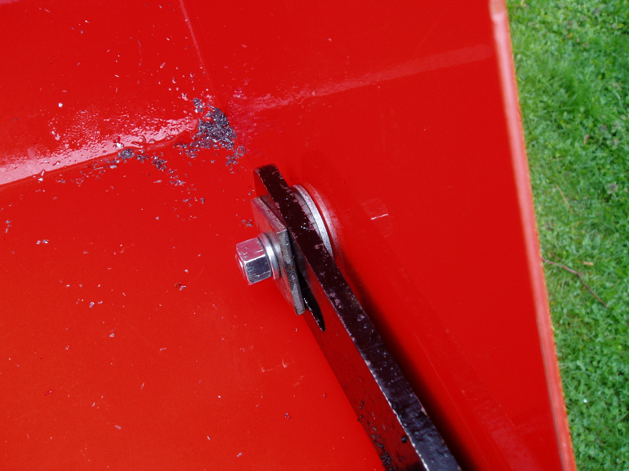

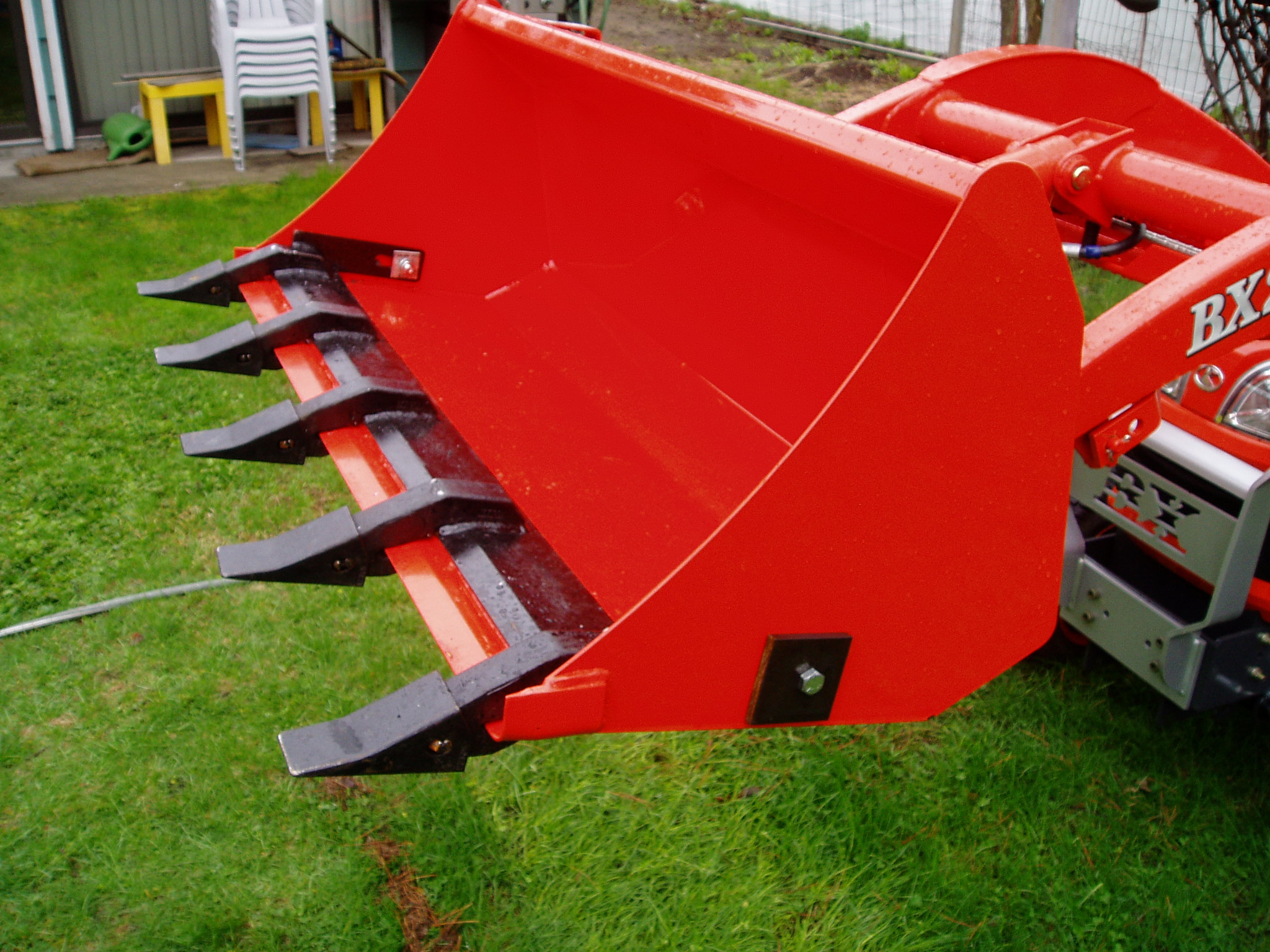

As promised, here's my Markham Tooth Bar installed today. Happily, there is no "gap" to speak of, so I guess I was lucky...:D
The unit lines up perfectly, seating all the way into the tooth "indents" and there was only a "2 washer" gap on the right hand side where the bolts go. The left side was flush and perfect. I added some steel plate washers to the install just to be doubly sure of a good tight install...overall, I ecstatic about the way it went...I could not find a 1/2"hole saw at the Home Depot so I just used a half inch bit with a smaller pilot hole drilled first...and plenty of cutting oil...:D

That's a great fit. How thick is your cutting edge? As I kept pushing mine back, it would ride up higher and higher off the bucket floor. Except for your cutting edge, I don't know what could be different. The casting no's on my teeth look to be 1001-23. Glad your's fits like a glove. I have a big side hill excavation job coming up. Will see how everything holds up.
/ toothbar fitment #12
I haven't measured the thickness of the cutting edge but it's the one that comes stock on a Kubota BX24...I'm sure your toothbar will hold up just fine too...make sure to take some pictures of your excavation...:)
