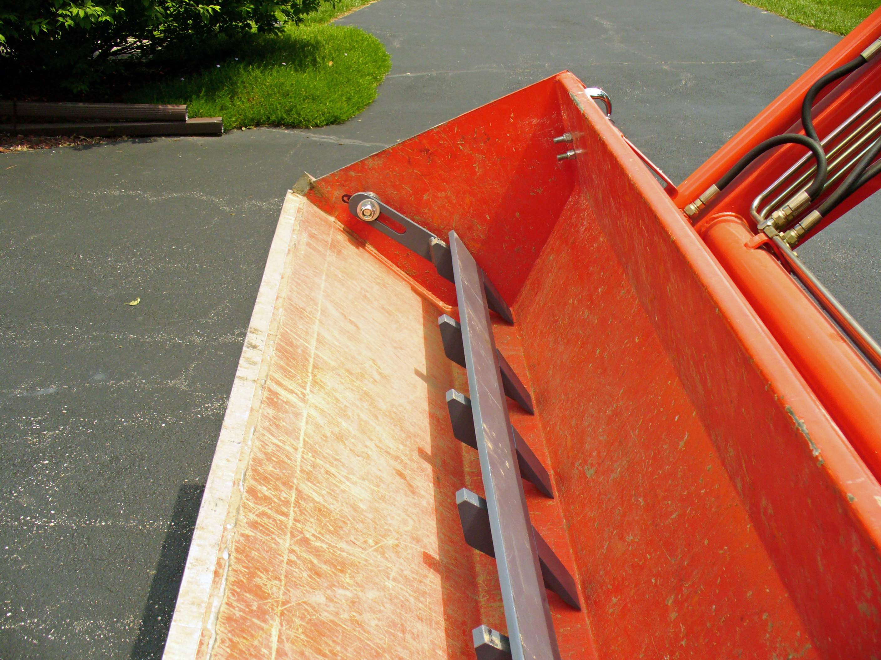

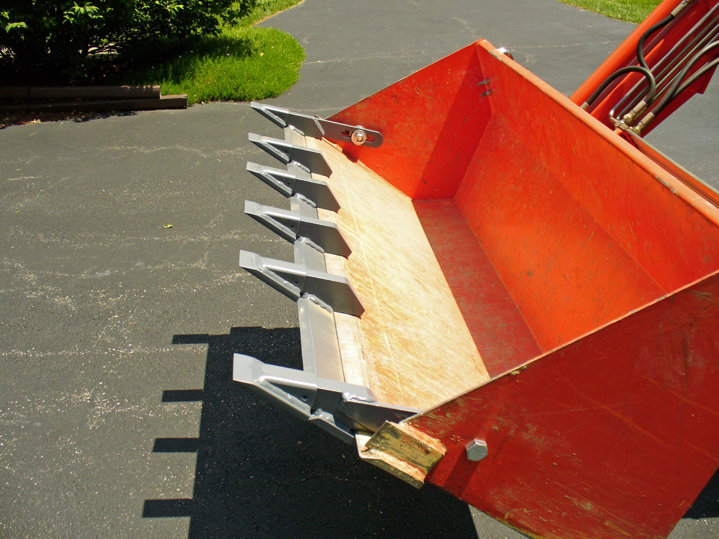

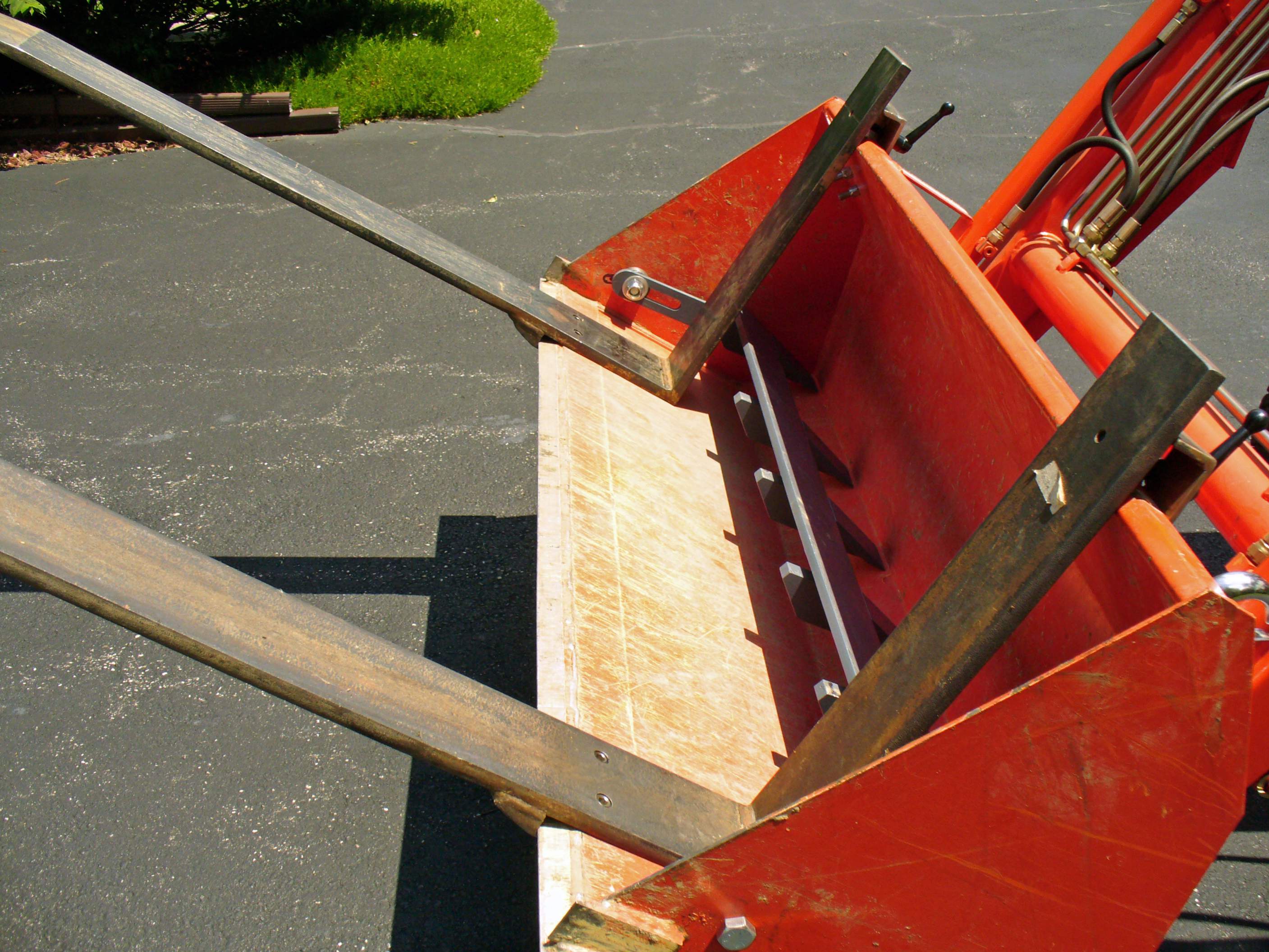

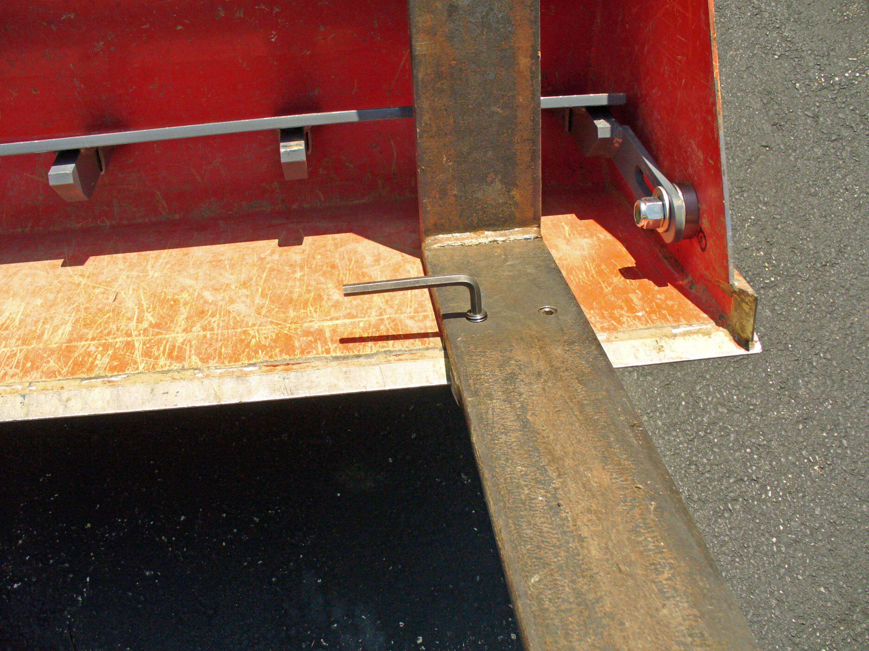

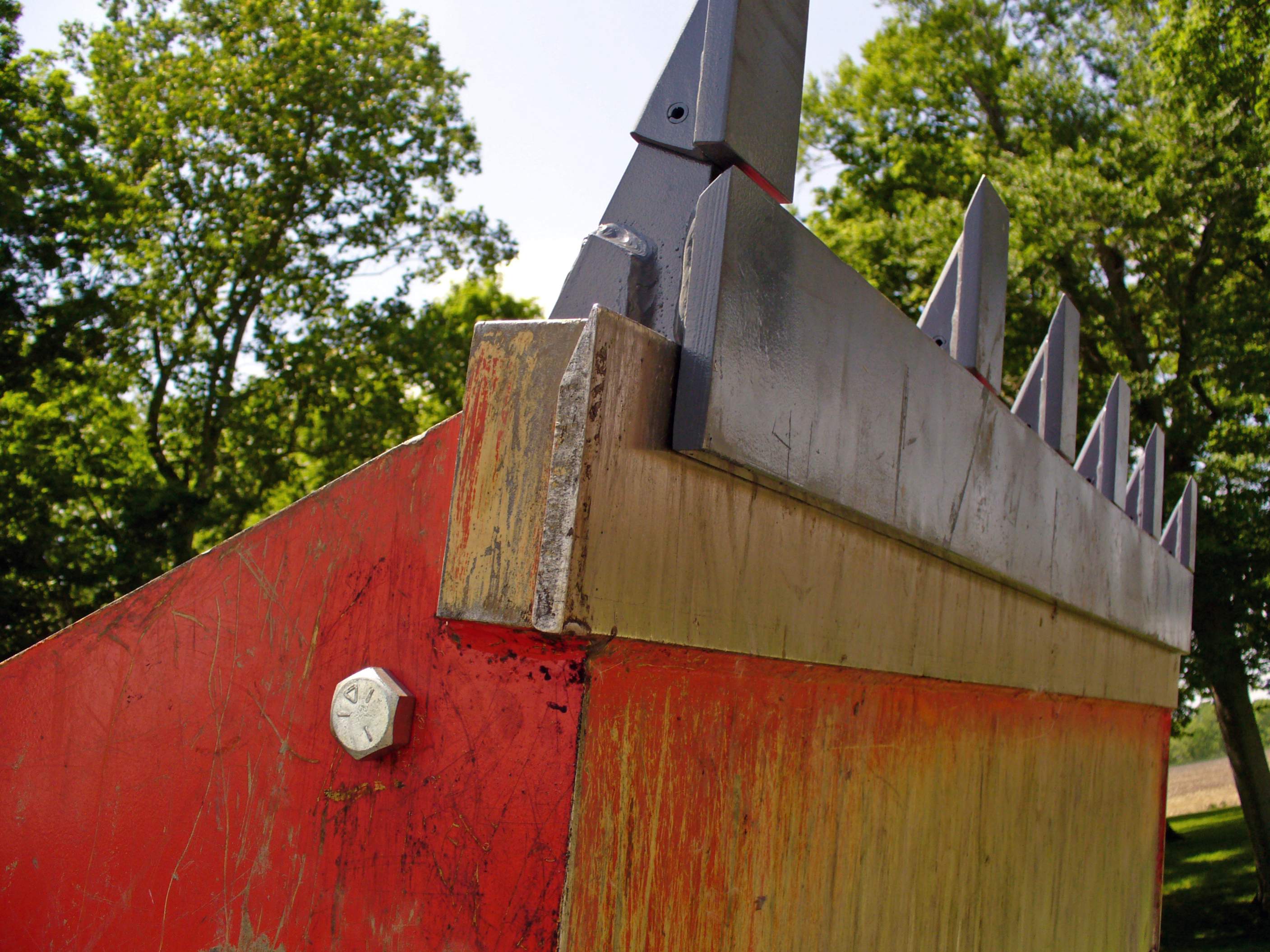

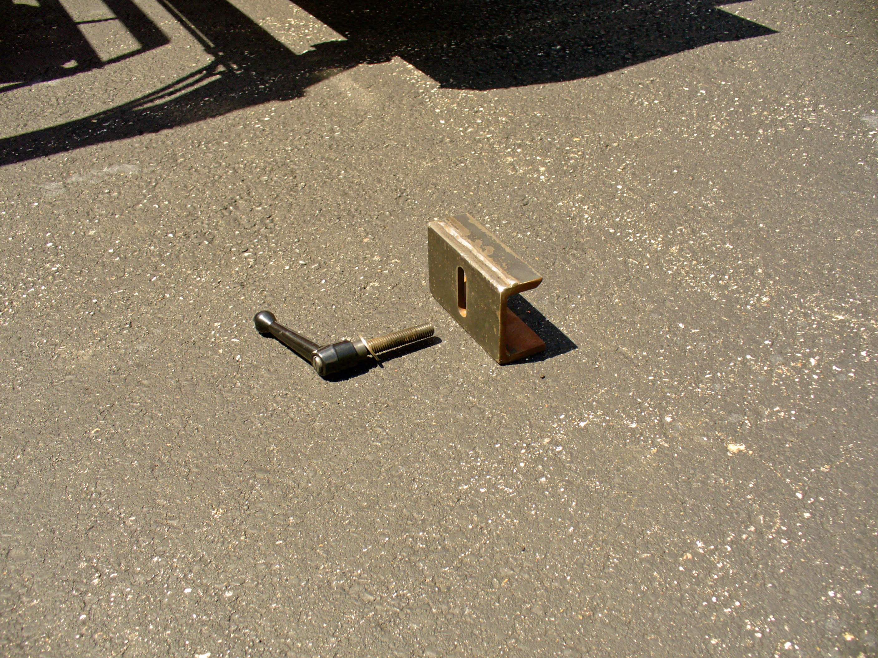

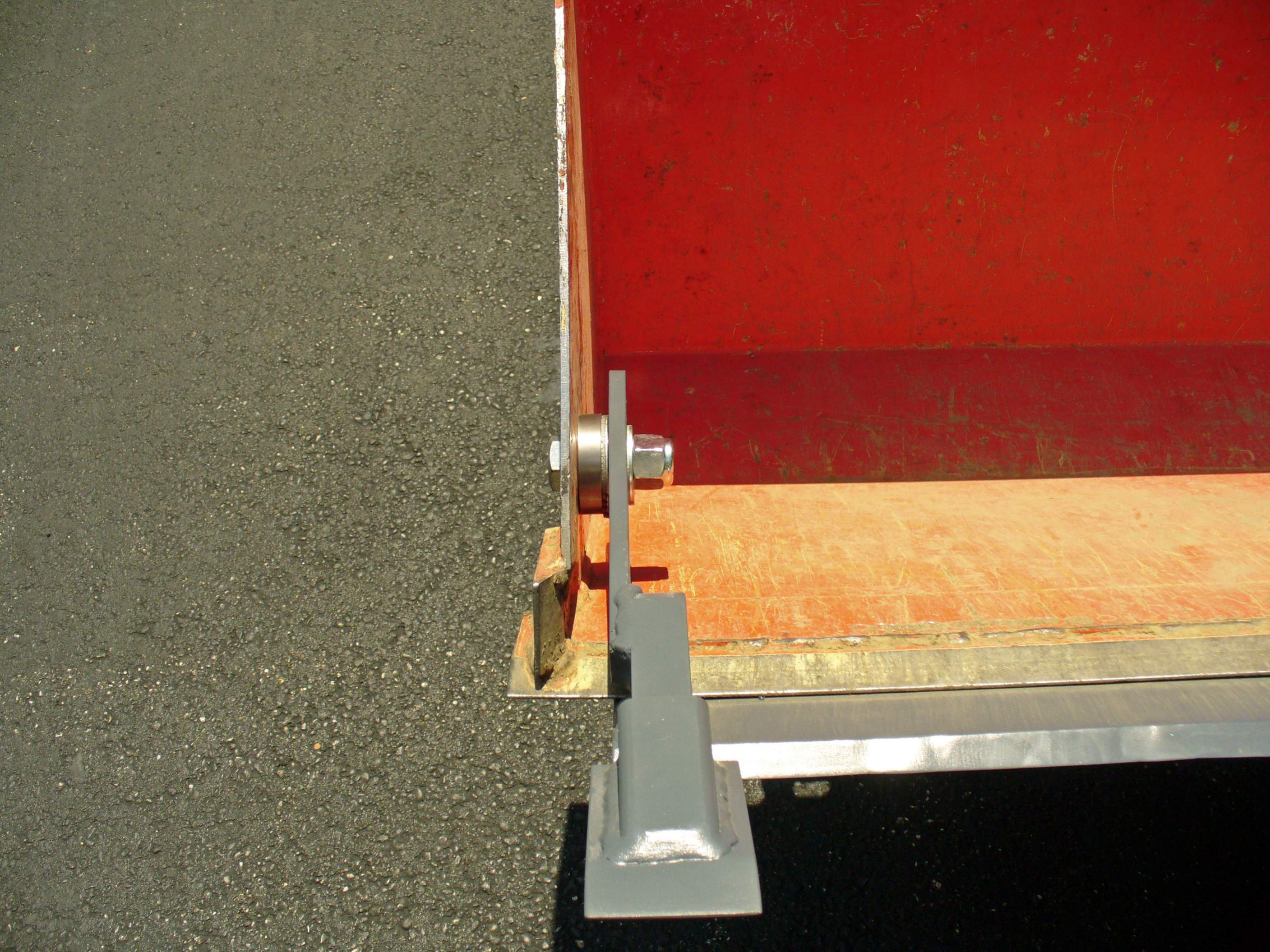

I have been with this forum for 4 years and log in everyday. I have not posted many times, but would like to share a toothbar & bucket forks that I recently made with the help of a machinest friend of mine. The toothbar will flip back into the bucket and allow me to attach the forks. Also the toothbar is almost flush with the bucket bottom to allow for smooth back dragging. The forks attach with spring loaded ratchets with the bolt attached and allen screws on the bucket floor. They are heavy duty.

Very nicely done. What is the material that is used for the forks? :confused: And.....if high strength material (as it appears) how did you bend the 90 degree? I like the way the forks attach.
Edit....On closer inspection, it appears the forks are welded at the 90 degree I had inquired about.
/ Toothbar & Bucket Forks
Yes, the forks are welded at the bend. Will get back to you on metal specifics, but I do know the bucket would bend before the forks would. I have of course scooped up many a large brush pile, also railroad ties, telephone poles ( which I later cut up intp 8' fence brace post) and I lifted good size trees for chainsawing into firewood.

Hmm, the tooth bar looks like it is patterned after one (the FTB style) from WR Long, though yours flips into the bucket further than the WR Long one does.

I should have taken a picture of the underside of the bucket with the forks mounted and you would see the deep slot in the forks that slide (sandwich) onto the bucket. The ratchet attachment that secures the top of the forks to the bucket were the invention and design of the machinest.

Ed_Indiana,
Did you guys build the teeth too? And how is the 1045 holding up? Is it wearing worse or better than the normal bucket edge?

Yes, we made the teeth. And so far no wear or damage to the teeth or any part of the toothbar or bucket edge.
/ Toothbar & Bucket Forks #18
Curious how you made the teeth.. Did you use square tubing and just cut it diagonally?
Thanks.
#19
One quarter inch wall two inch square tubing. Very heavy wall for that size tubing. Then I used 1 and one half X One and one half inch sq stock milled the correct angle on one end. I made the tooth from 1045 hr steel and milled the same angle on one end, then welded the tooth to the 1 and one half sq under the angle of the sq stock. I predrilled the sq tubing and the sq stock to except a 5/16th roll pin. This is what mounts the tooth to the bar. Then I welded the assembly to the bar itself. All welds ground smooth so the soil would flow over it easy and not get sbagged.
