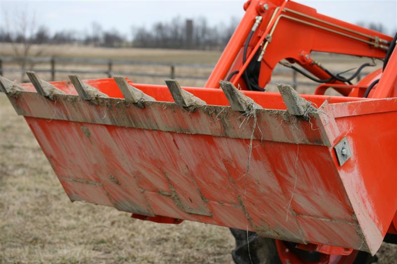

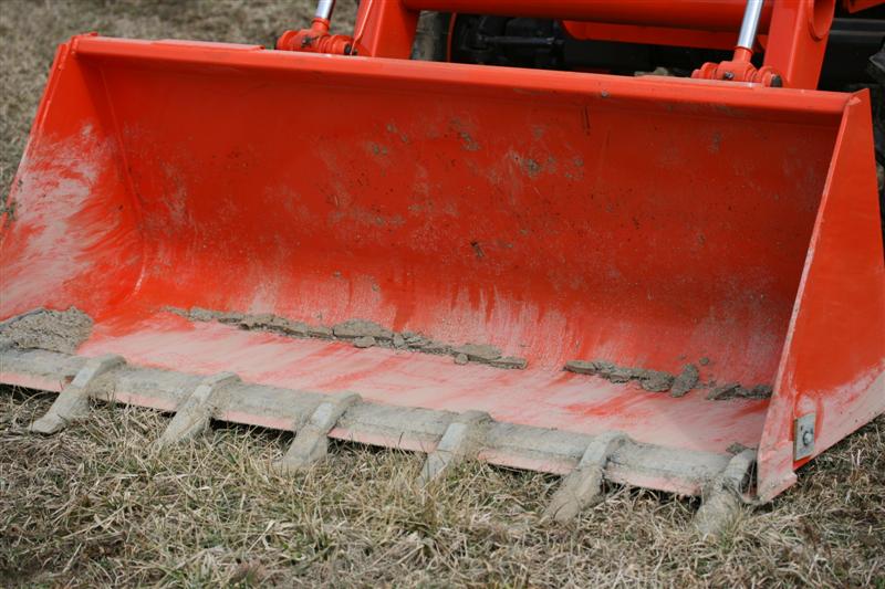

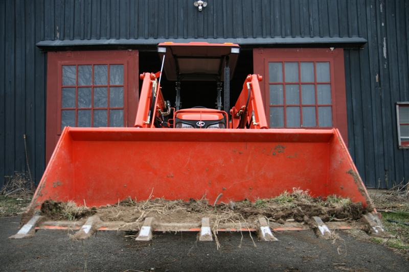

Pictures of my Markham toothbar:
It's the best $200-300 you can spend for you tractor!
