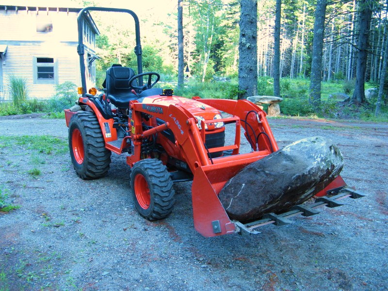

My toothbar dug up this rock, well with a little pushing too! They are a big help.
