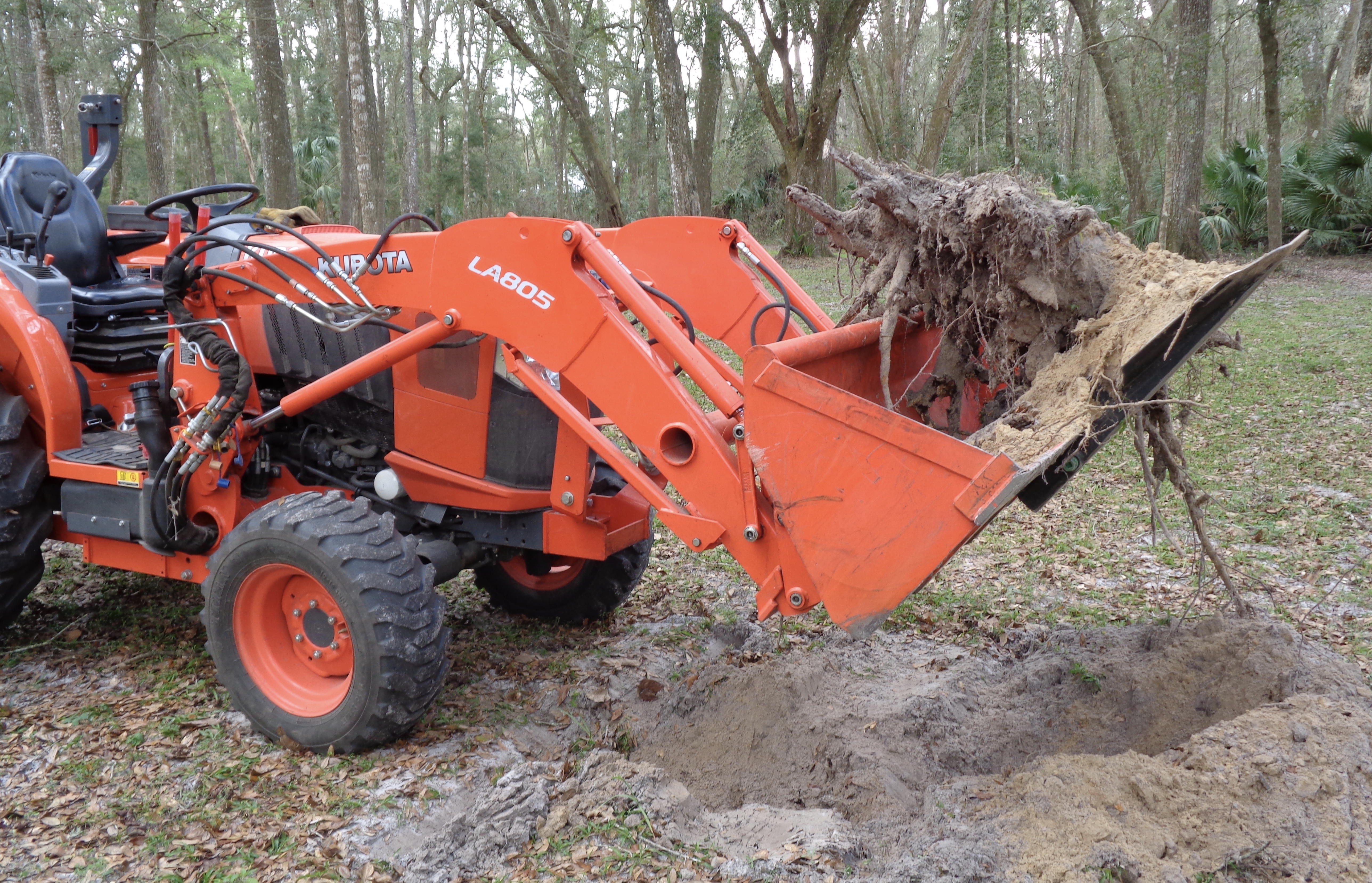

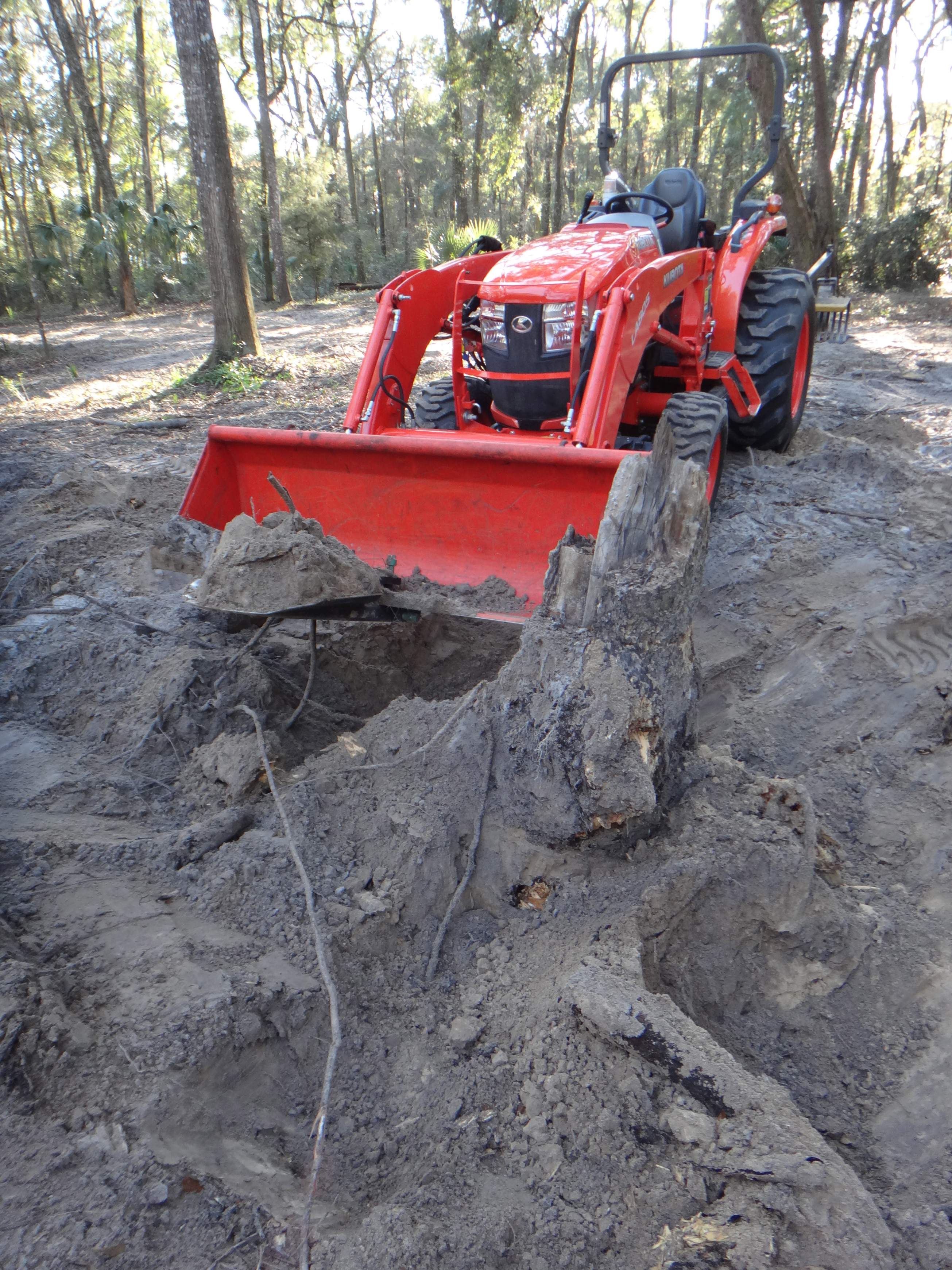

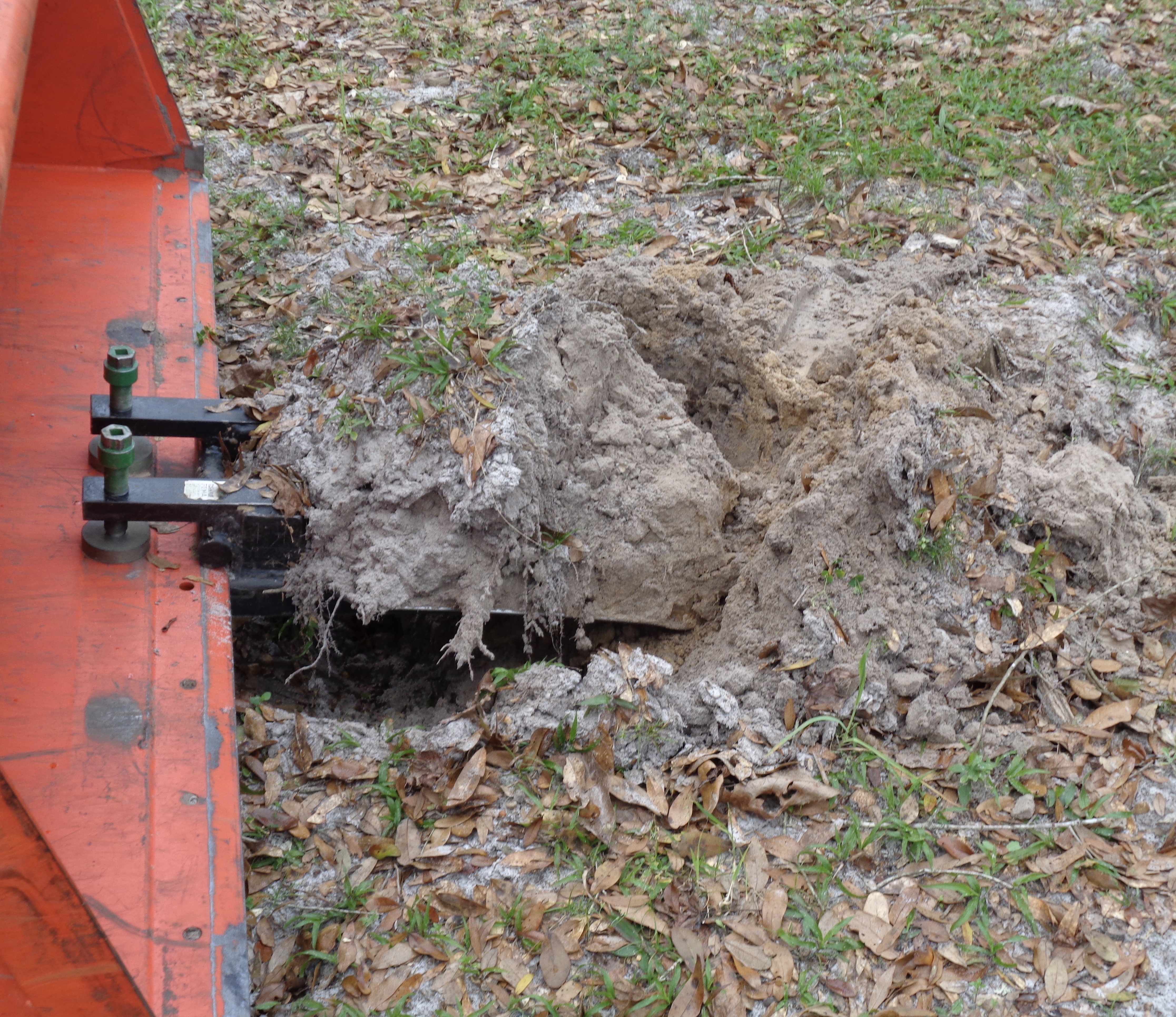

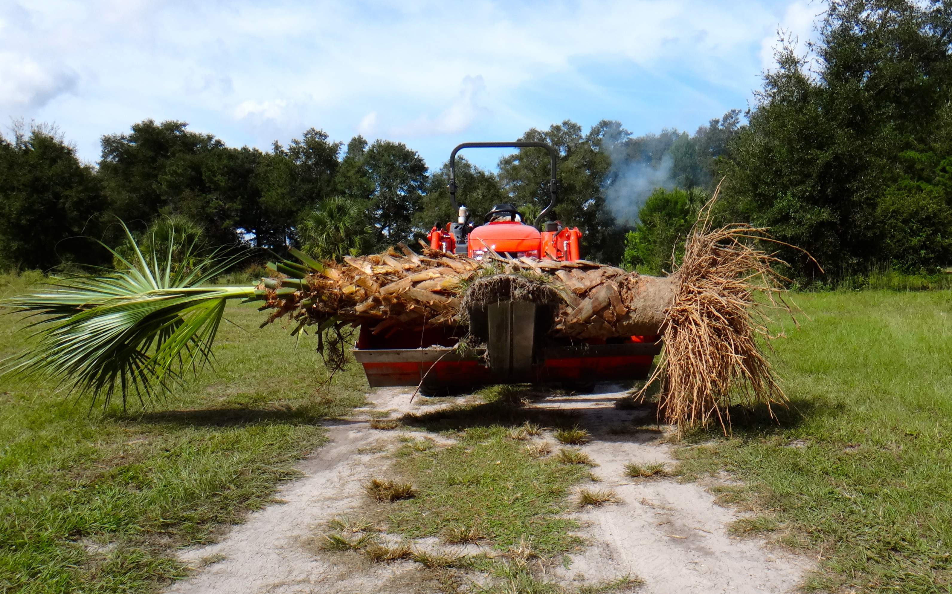

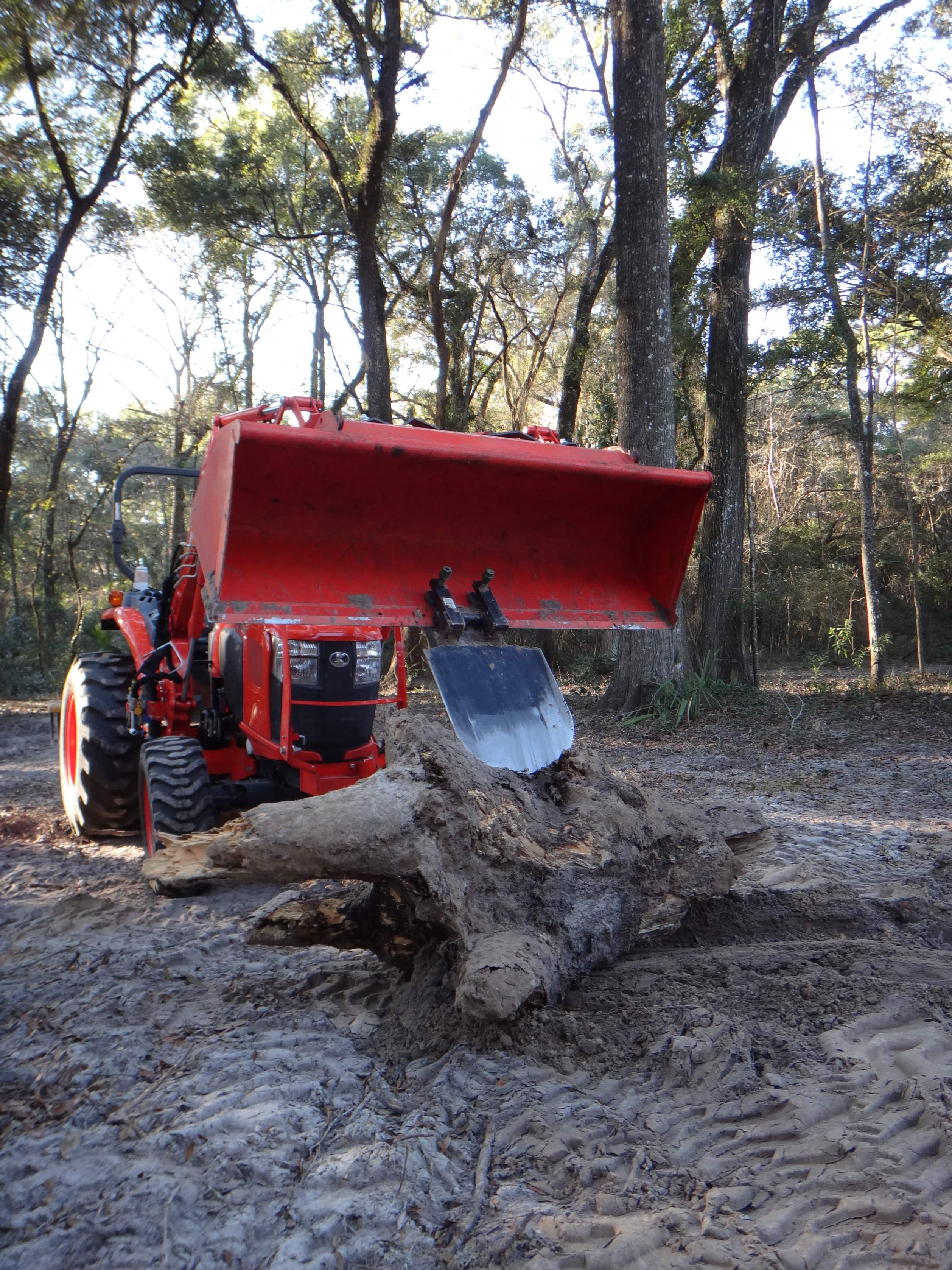

I opted for 5' L2296 H-D, R-B bucket on my new L3560 delivered in January 2013. It is indestructible working Florida dirt. Photos are recent. You can see the bucket is unscathed after 1,300 engine hours. I moved some 12 cubic yards of soil in the H-D, R-B bucket yesterday, to fill in low spots in a cut-de-sac common area where I live.
The FEL will destruct long before the L2296 bucket.

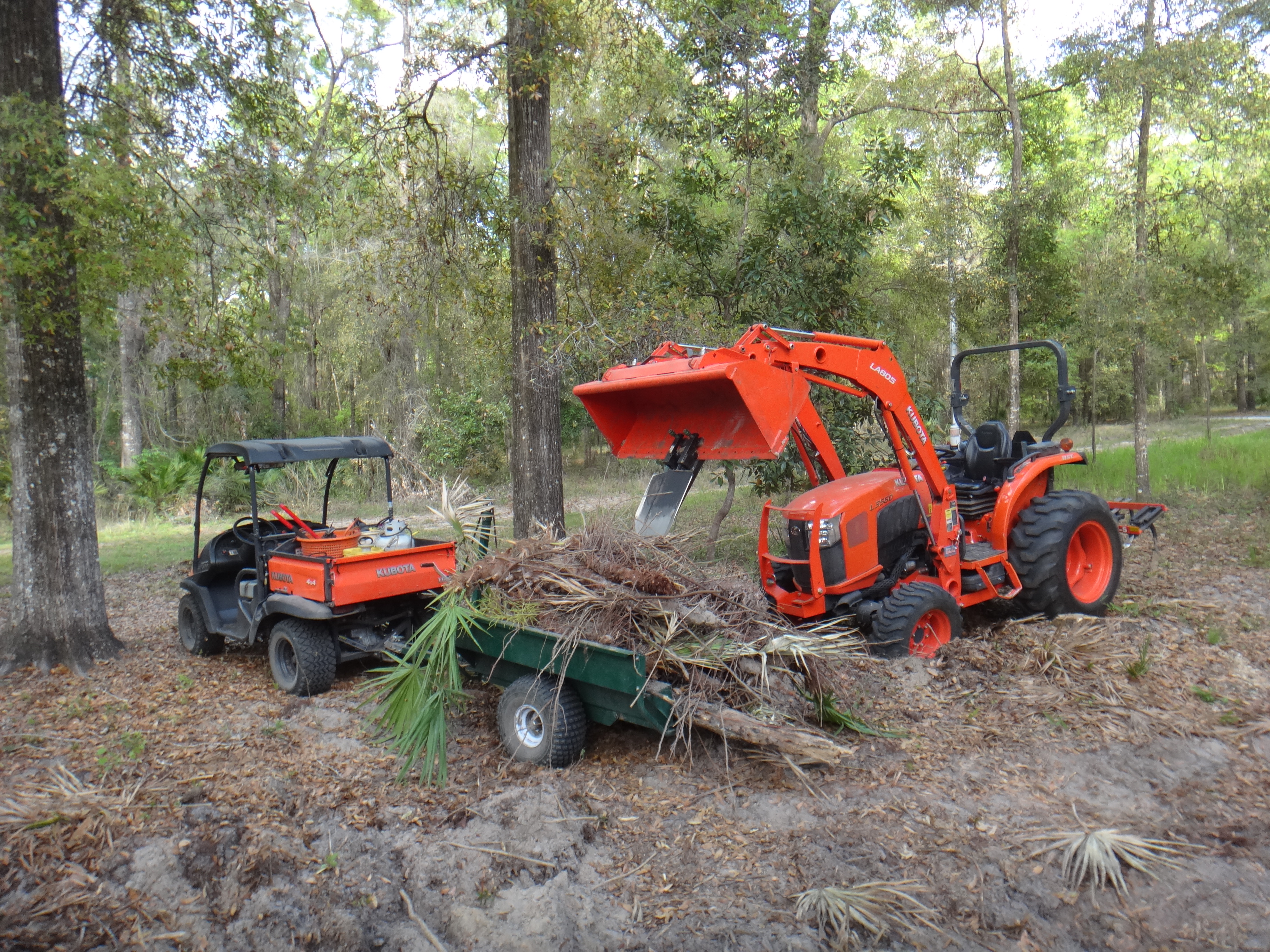

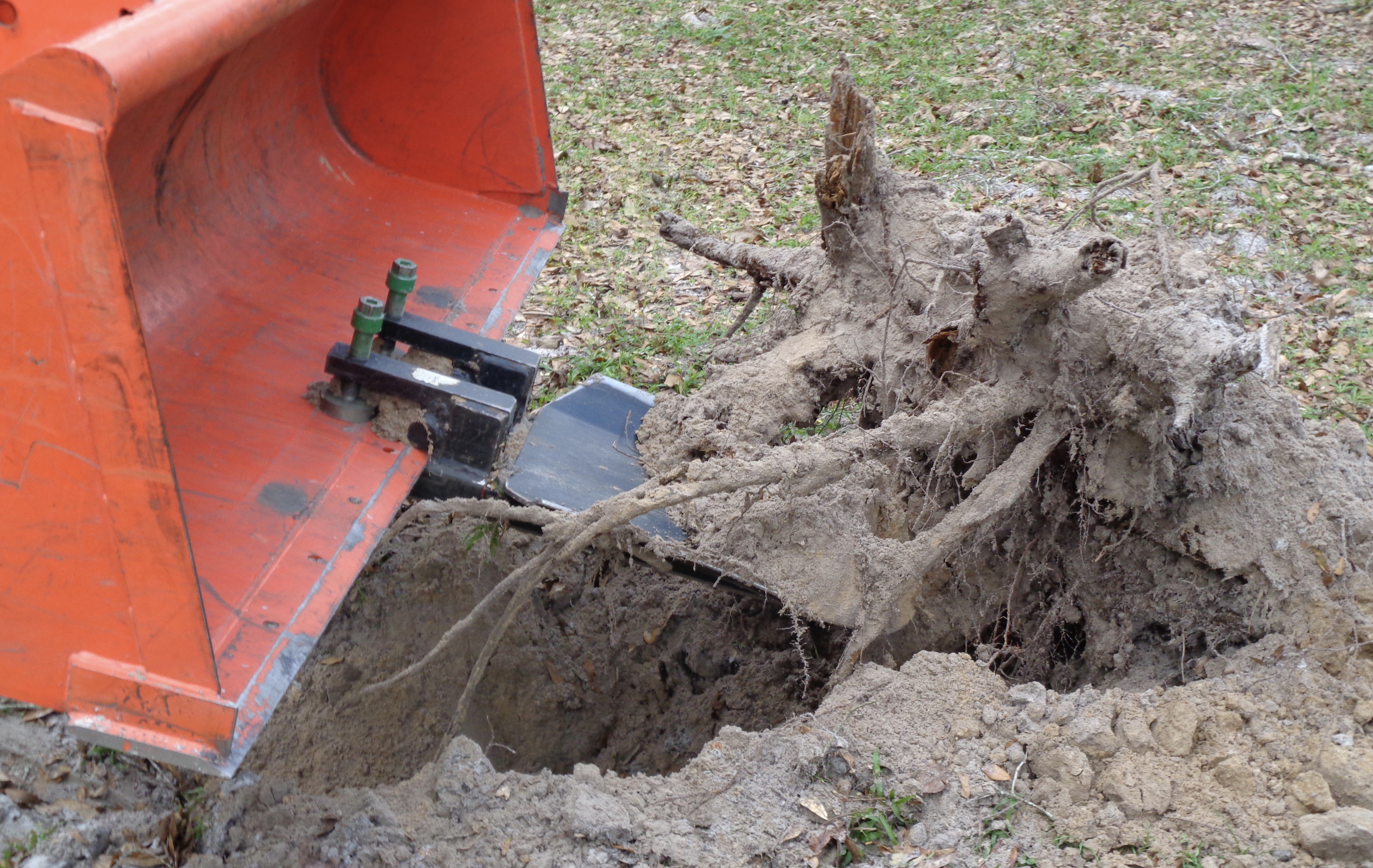

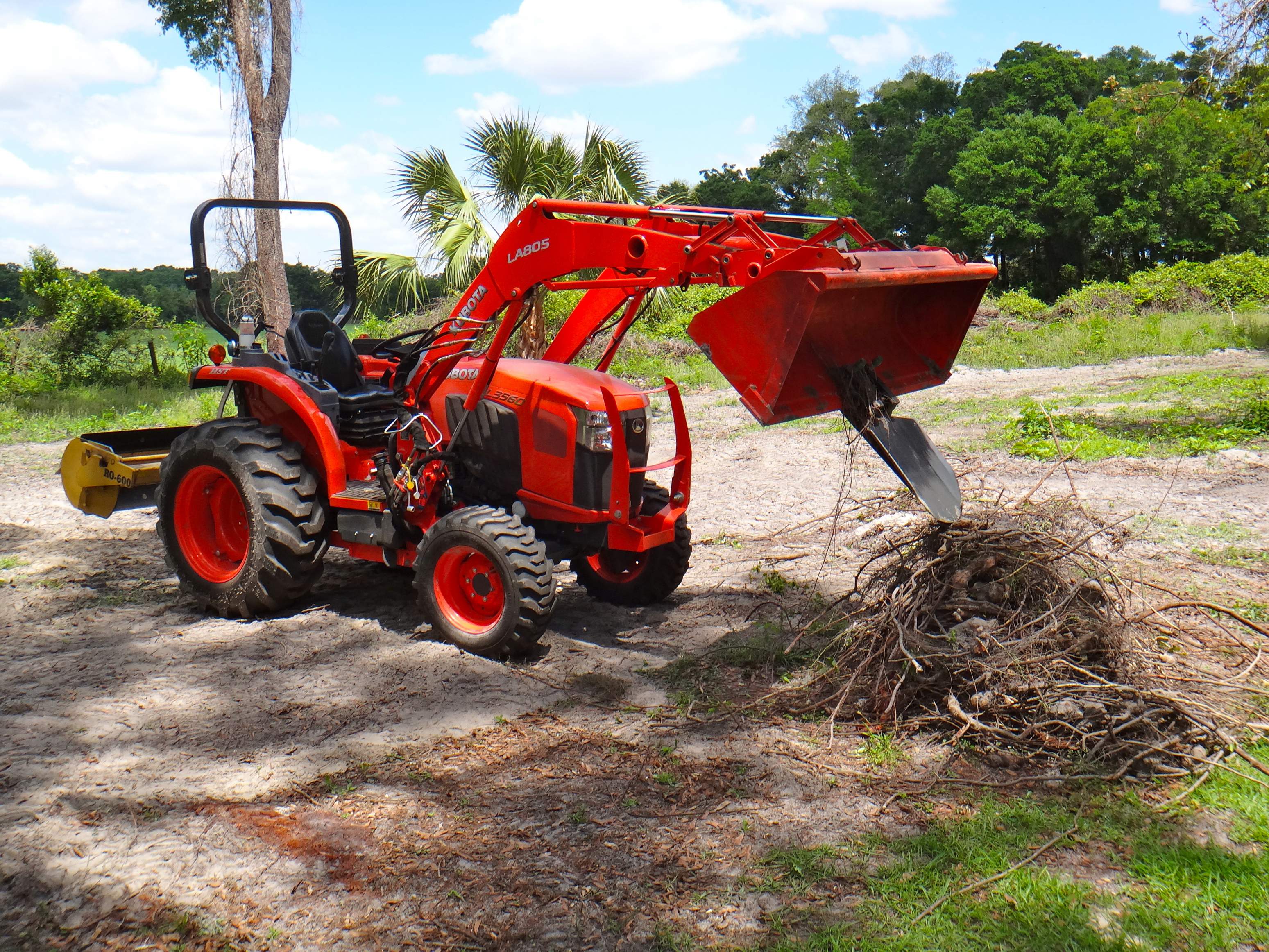

If you plan to dig old, rotted stumps I recommend a Piranha Tooth Bar. The Piranha grips, when a bare bucket will slip trying to lever stumps. Forget green stumps over 3-1/2" diameter.
The L2296 provides a rigid mount for a Bucket Spade, another useful attachment. Nothing is better than the Bucket Spade for removing Palmettos.
BUCKET SPADE: https://www.tractorbynet.com/forums/attachments/328798-bucket-spade-today-fel-bucket.html?highlight=
