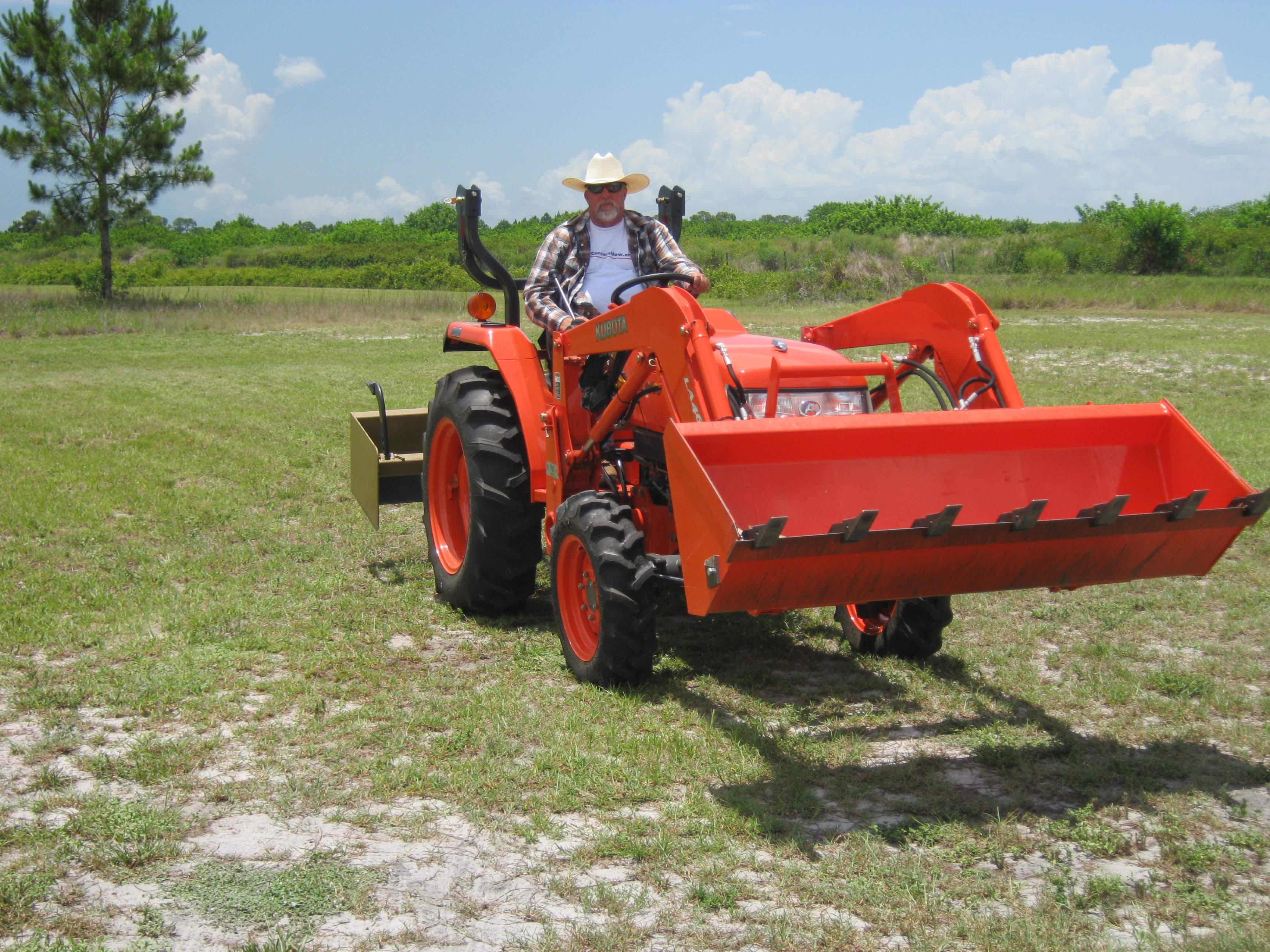

You didn't ask but if I were you I'd go with a minimum of 7 teeth and probably 8,for that width.
Boone
Pic is 64 1/2 " inside (7 teeth).
