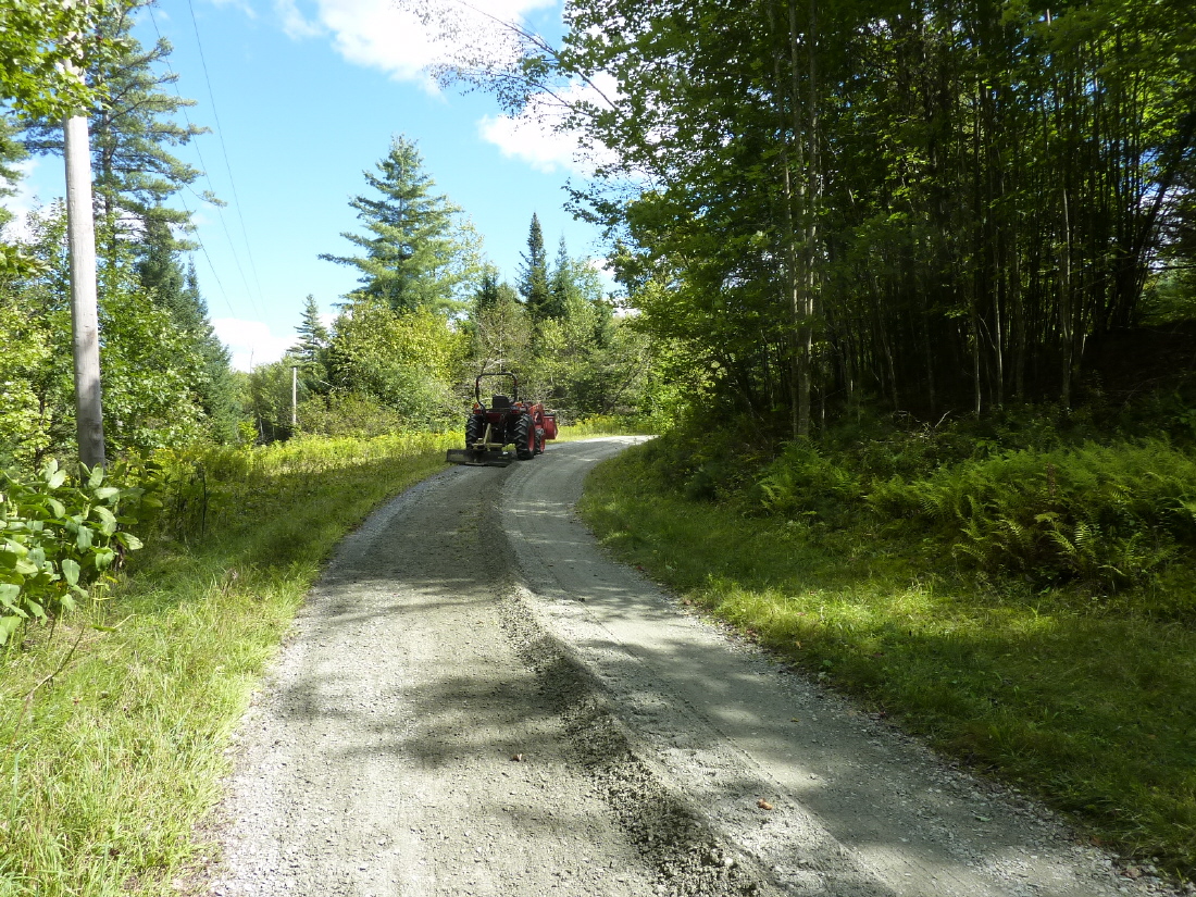

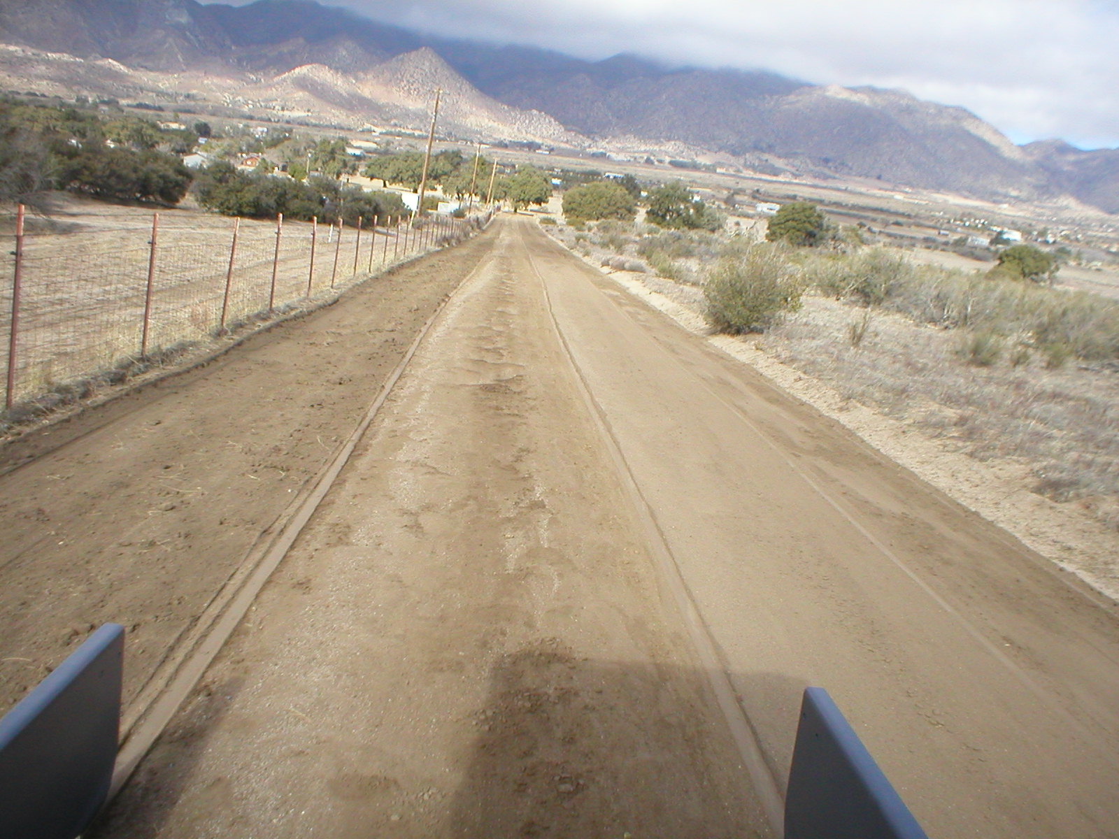

I completely agree. Lots of potholes or water channels on some of the driveways, pretty much always water to blame. Just looking for the easiest way to build up a crown to help keep the water off. The other culprite is just driving over the same spot for years with no maintenance. That ends up beating in 2 ruts with a lump in the middle & on each side.
You asked.
Roll some material to the center from each side and smooth it out. Not that we get much rain out where I am anymore or ever really, but I have a small crown on my roads and have yet to have a washout deeper than 2", really only an 1"+. In 17 years I've re-crowned the roads once.
If you are going to do this as a side gig and actually want to make some $$$, get yourself a Land Pride RBT3584 with hydraulic angle and offset and skid shoes. Add a diverter at the rear so that you have 4 rear remotes.
Rear blade for road shaping.
Box blade for material redistribution.
LPGS for over all finishing.
If you are going to do it, do it right.
Do you have draft control? It would make things much easier for you.
If all you want to do is smooth roads-drives out, get a LPGS. No water control will assure you constant business.
