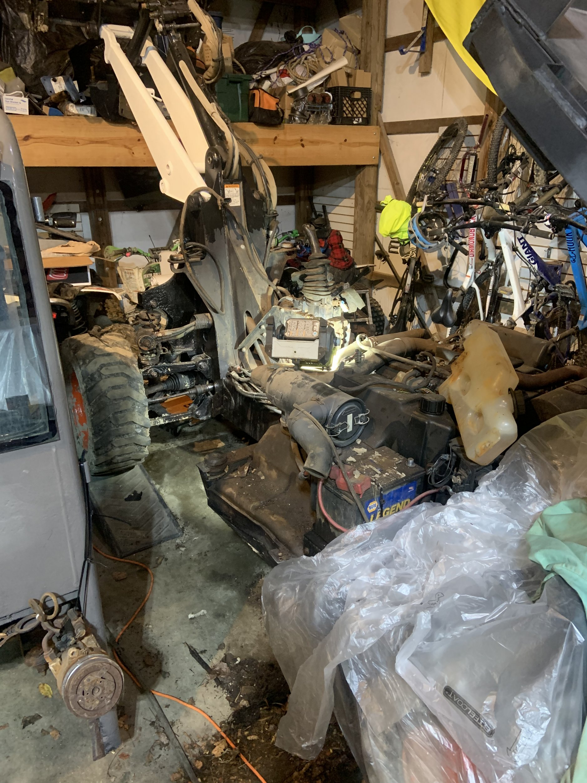

In case you are wondering what your Toolcat looks like without the cab on here it is. Very beefy backbone. Sorry for all the junk in the background. I had it shoved in corner of the barn.
