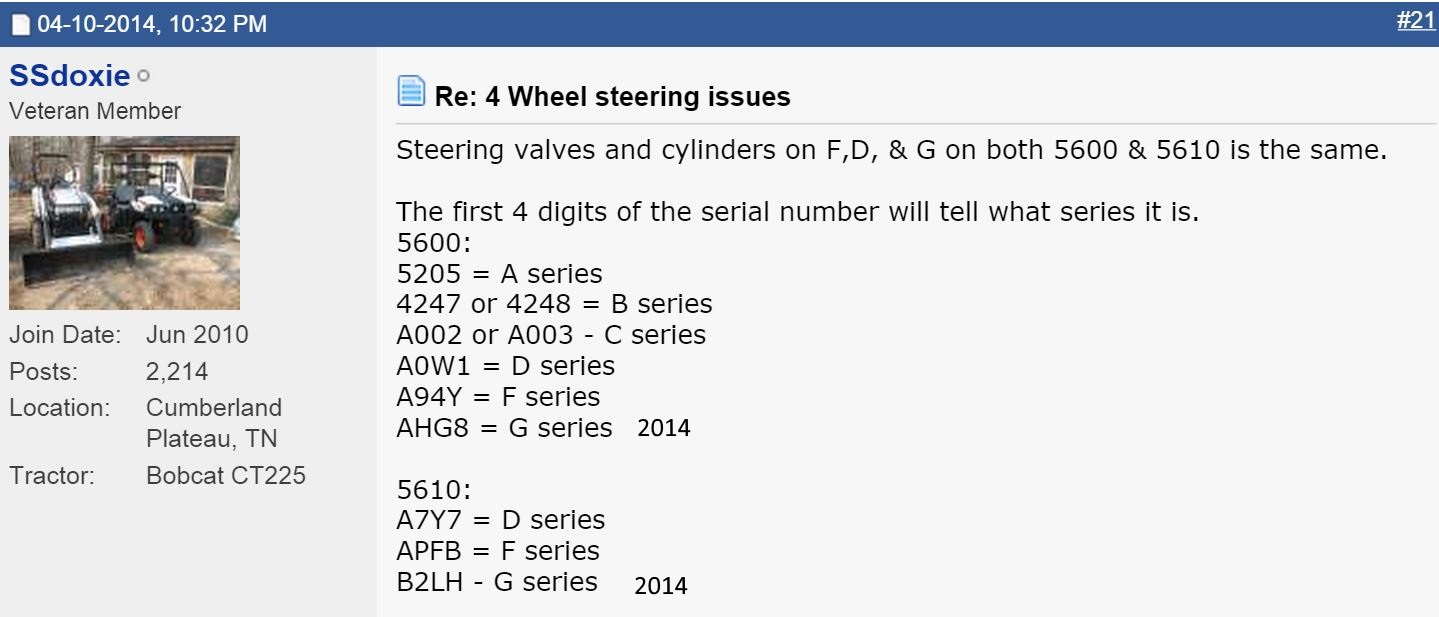

The first four digits of the serial number indicate the series. From an old post by SSdoxie, open it in a new tab to read it:
You can see the parts here: Bobcat Genuine Parts Catalog – Official Bobcat Company site
