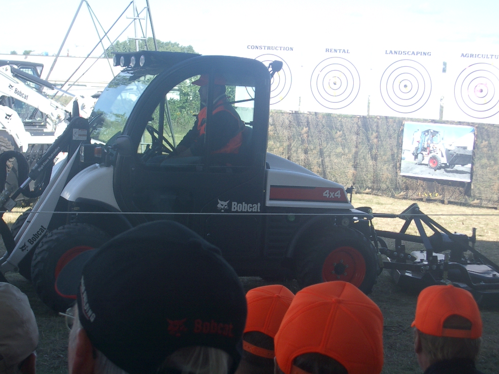

So how different from this old photo was the unit you saw?
