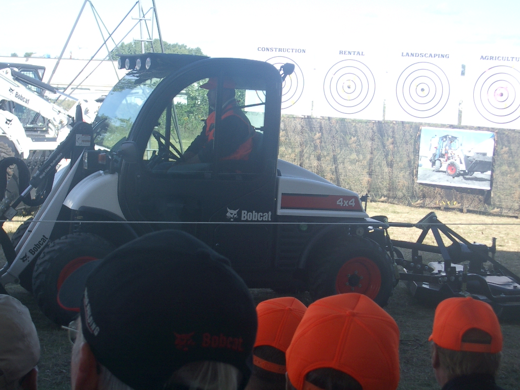

Don't look now! I can't give any specifics and I apologize for quality but here's what I've seen.

Interesting peek. Nice tires. I guess the dump is coming later. This will be a big boost for the new Bobcat company. I trust they will be beefing up the axles and offering larger tire options.

Ditto on the larger tire option. I also wish they would consider a dual action floor pedal for forward and reverse rather than the wheel stalk shift lever. I've tried both now and I like the tractor setup a lot better.

That Toolcat set up for the 3 Pt is really pretty! We all know that a TC has more than enough power to pull, but traction is a significant issue. Rather than larger tires (which would raise the excellent center of gravity), I propose dually wheels all around to beef up the traction, minimize ground pressure issues and add lateral stability...I am shocked that there isn't any manufacturer offering this as an aftermarket accessory.

Thanks for the picture. That is what the prototype looked like. A composite box will probably be an option instead of just the rear cover where the radiator also sits.
Rolando
I also told them the dual pedal setup was better than the column shift lever but no known changes in that area. The floor space is very limited due to the front wheel well. Probably not enough room for forward pedal, reverse pedal and brake for people with big feet or boots.
jmfox
No known change in the axles. Bobcat feels the suspension system is already overbuilt. The axles are protected by the hydraulics which can supply only a specific torque before the relief valve opens. I have not heard of any axle failures. Can't get the tires too tall because it may affect an attachment on the loader arms which can only go so low.
I don't know if they are making allowances for rear hydraulics. Those are a must for 3pt equipment and attachments with hydraulic cylinders or if a top and tilt is used.
/ Toolcat 3 point is coming #15
Larger tires can mean wider like the forestry tires with more aggressive tread. The axles will get a beating when towing 3pt attachments. They might be okay for a brush mower but if you start pulling excavating implements, say a plow... well that's why tractors have straight axles.

That's looking good. I'd like to try a snow blade on the front and a snow blower on the rear. it would be a great setup for winter.
