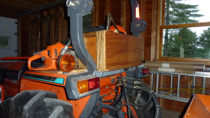

This is my second time trying to post. I was ready to hit the button to post and lost my electricity again so now I am on my phone. I have a bx2360 and I want to put a toolbox on it. Has anyone added one to theirs? Where does the dealer installed light go and is the wiring on the tractor?
   / toolbox and worklight for bx2360 #2
It is not a BX2360 but maybe you can use a variation of the idea. I sandwiched the ROPS between two pieces of angle to make a shelf for my saw box. Most lights I have seen are mounted on a bracket attached to the ROPS cross bar. I like the ones that use 2" square U-bolts. Look under the rear fenders for wiring. Might be there. Thats where mine is.
If you search toolbox or lights you will get lots of clever ideas and info.
Unfortunately The toplink and lift arms come up into that area. I saw an older bx that had a box there but there is not enough room to do that on this one.
