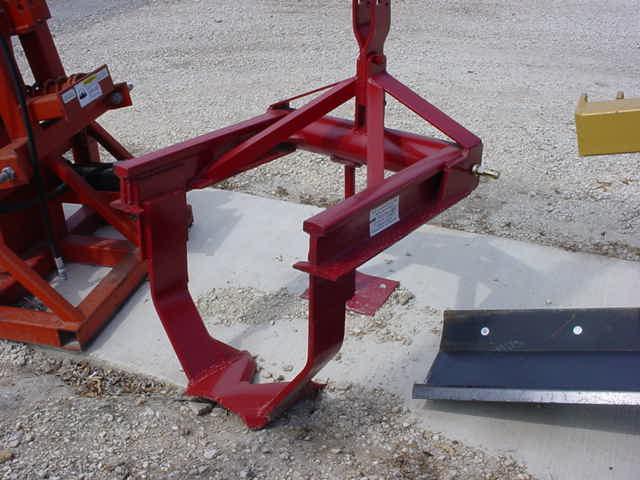

Here is one that I think would do a good job.

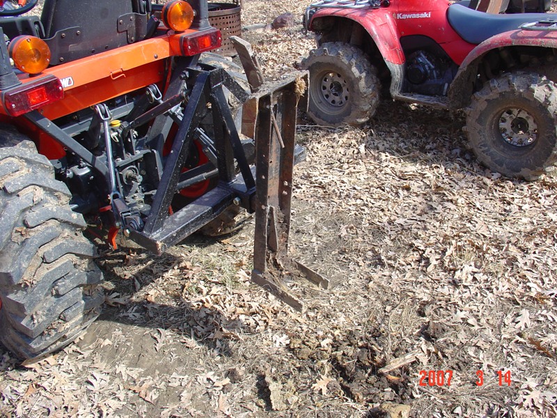

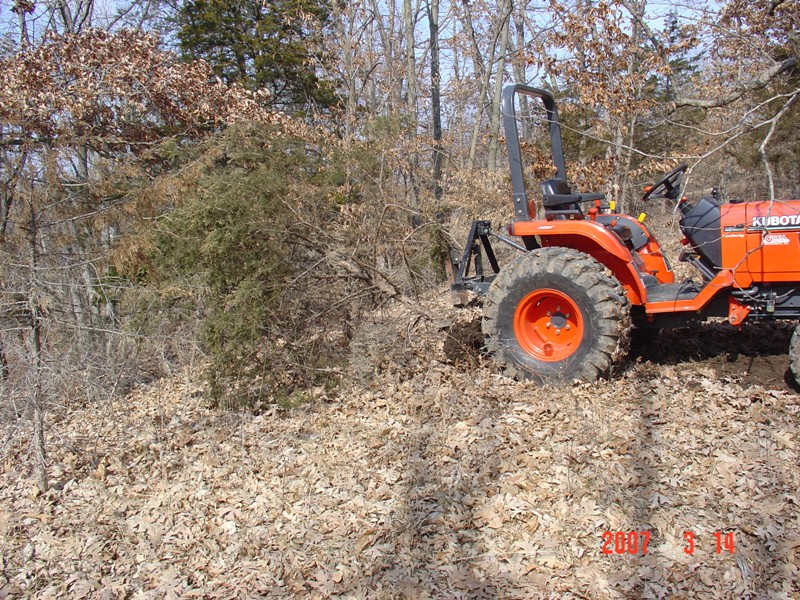

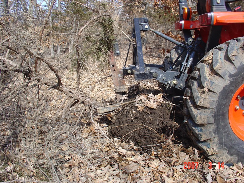

I built a tree grubber that works pretty good. Pictures aren't the best but you get the idea. I'm usually grubbing trees but it will dig into the ground and grub a stump if needed.
I built one for my buddies 100HP tractor. I used 8" I Beam and 4" square tube. My little Bota won't tear up the one pictured but I didn't think it would handle my destructive buddy!!!

How does that one work? It looks to me like the v cut/blade is facing towards the 3pt hitch instead of rearward which is what you'd need to back up to snag a standing tree. I guess this style would work fine with stumps as you'd just drive over them but it would be kinda tough to lean backwards to look down to see you were properly lined up while moving forwards.

From what I understand it is for stumps and roots. You have a lot more advantage going forward.
/ Tool for Grubbing Stumps #14
JerryG is right-for 2 reasons. 1. Tires are designed to pull with most traction in forward direction. 2. Three point hitch works better, and is stronger in extension mode (pulling forward). Pushing a three point implement is a good way of bending the lift arms or toplink.:eek: :eek:
/ Tool for Grubbing Stumps #15
I appreciate Jerry's and your points. However, for the small sapling type stumps that the original poster described, I'd think that the strain on the 3PT would be minimal if you are just jamming the V to get a grip and that traction is not an issue as you are really just using the 3PT to lift the things out of the ground.
The forward acting plow device certainly looks formidable and probably doesn't use the 3PT to lift at all but lining it up an an individual stump seems a bit more tricky.

Thanks for the input, gentlemen. I think that the Harris Root Plow, like the one suggested by JerryG, or a single shank ripper, would serve me best. The area is so heavily wooded, I'm afraid that the FEL would create more collateral root damage to surrounding mature trees, than the smaller type implement. Also, I feel that pulling forward and lifting will be more efficient and less likely to bend the lift arms. As always, the feed-back on this forum is fantastic.......thanks again, to everyone.
