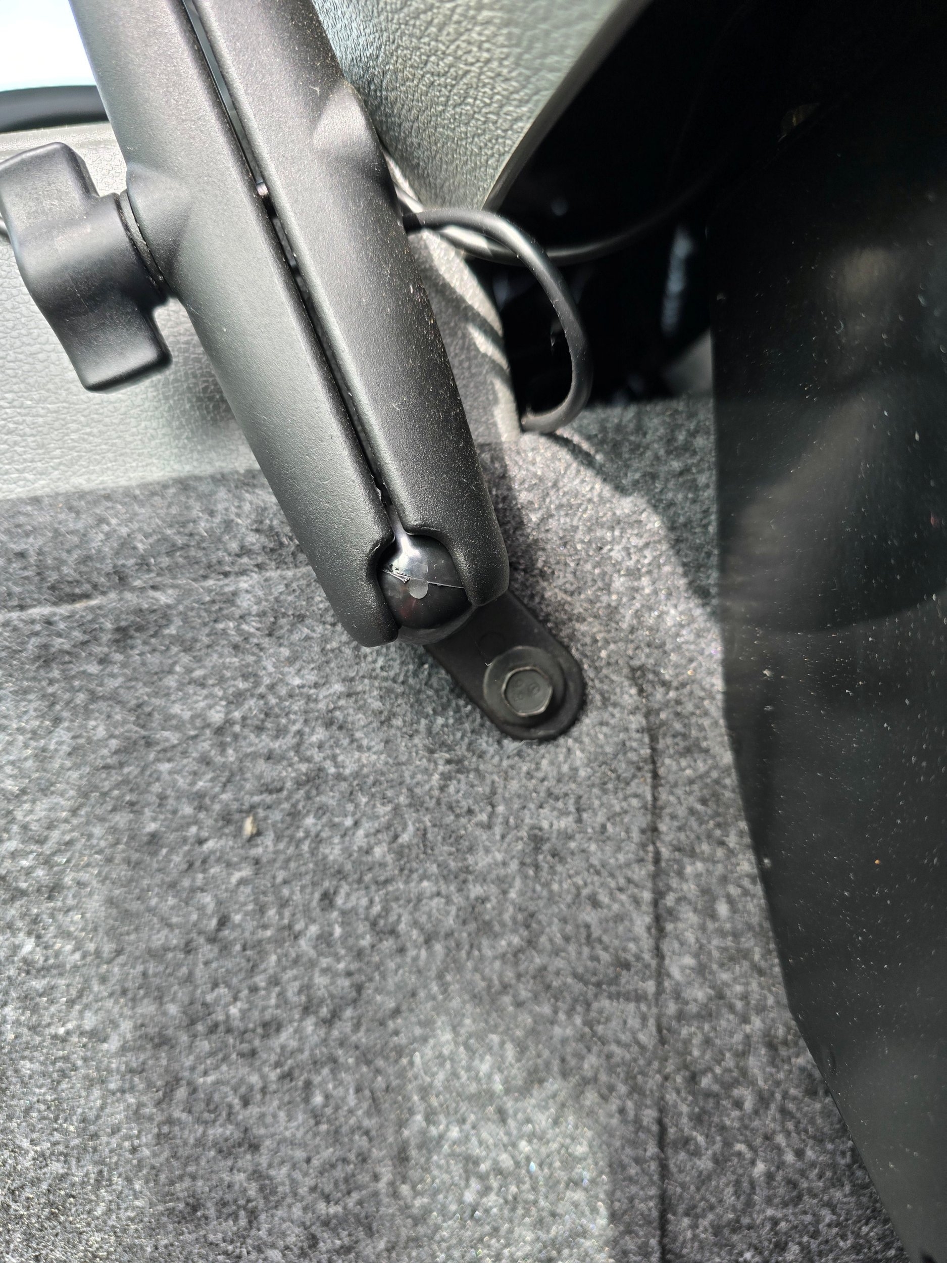

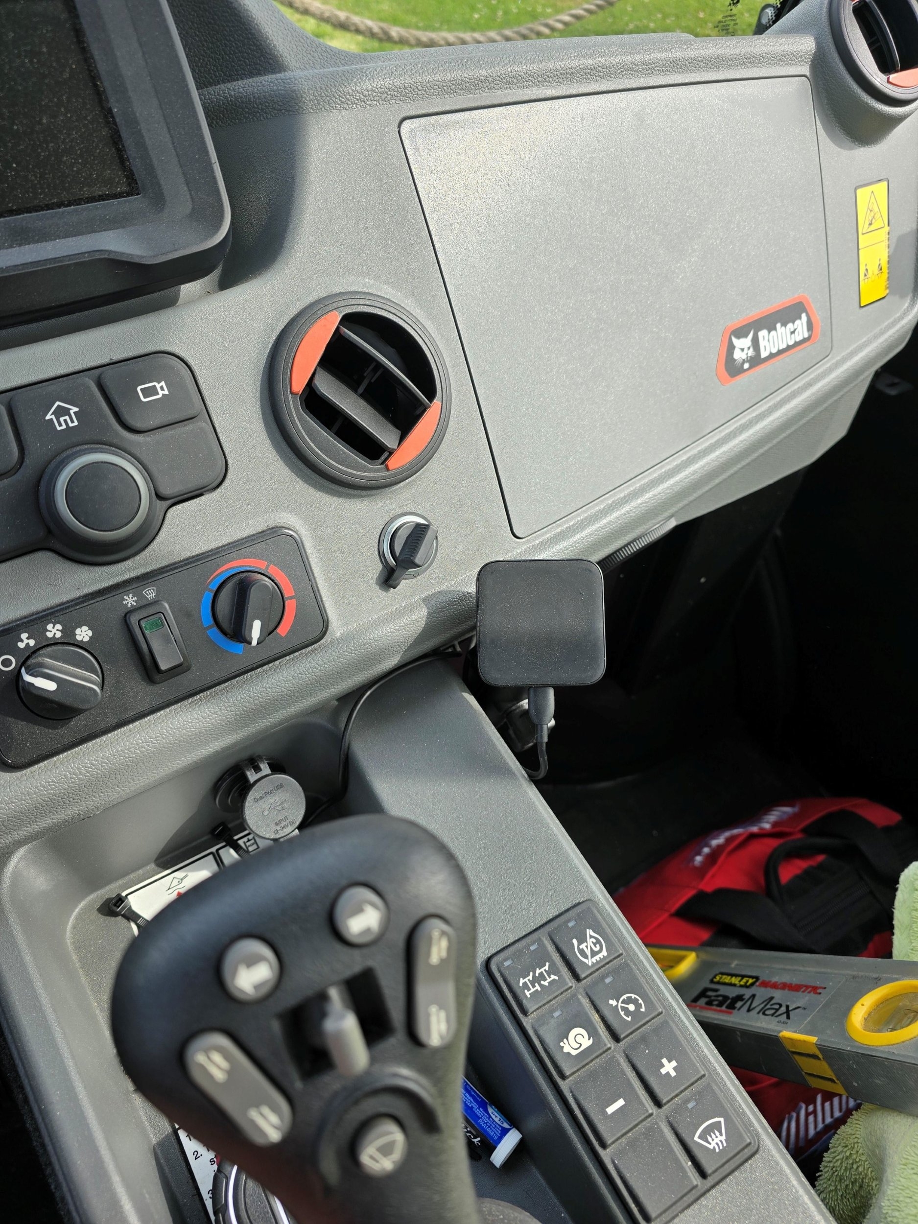

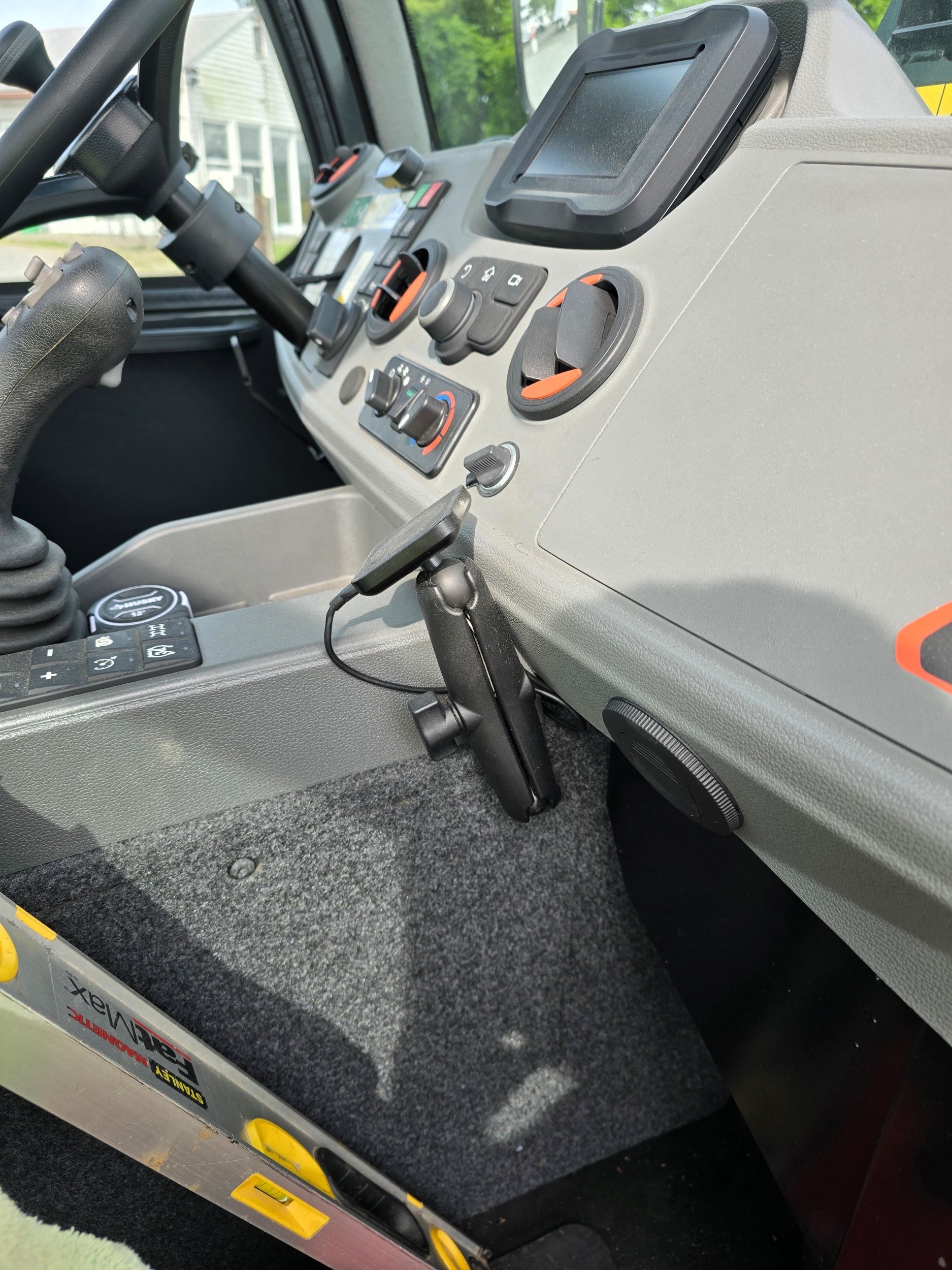

I used RAM components with with a PEAK magnetic Phone charger. Uses an existing bolt on the side panel cover so nothing new to drill.
Plugs into the USB C port built right into the dash with the included cable from the Peak charger.
It works great even bouncing around.
If your phone doesnt have MagSafe or MagFit then just swap out the Peak charger for a RAM X-Grip like mentioned above.
System is made up of the following components -
Peak Design Mobile 1" Ball Adapter Wireless Charging (Non-Locking)
RAM Mounts RAM-B-252U 11mm Bolt Head Adapter Ball Base with B Size 1" Ball
RAM Mounts RAM-B-201U-C Double Socket Arm (Long) Compatible with RAM B Size 1" Ball Components
