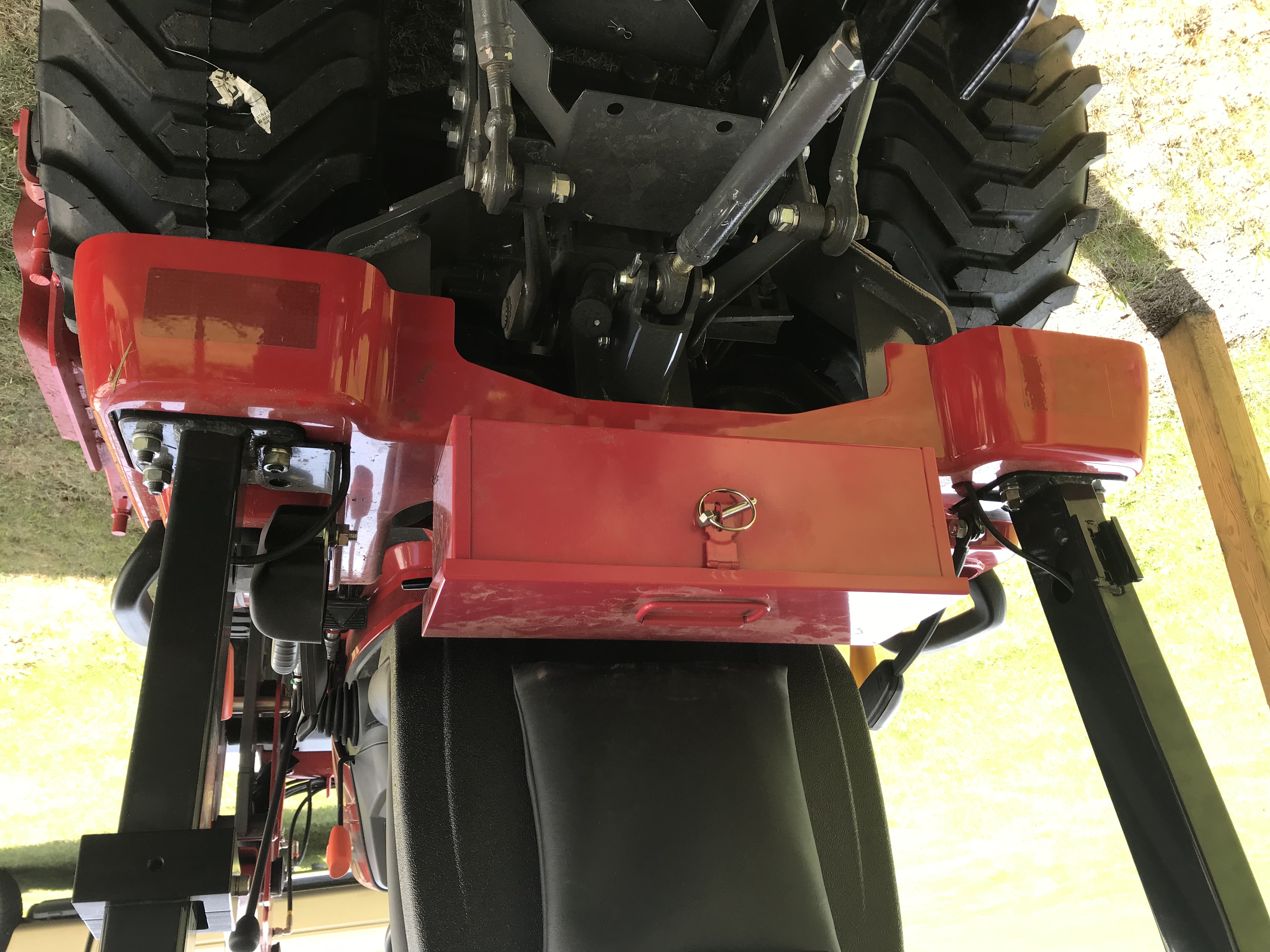

Here is my 16x6x5 tool box on a 1705 behind the seat.
Jim.
   / Tool Boxes on Fenders #24
"behind the seat". Probably a whole lot better than my fender location. It shouldn't rattle & shake back there.

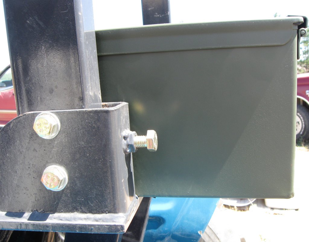

Just wanted to add my 2 cents here. I've owned several tractors over the last 35 years or so. I'm currently the owner of a Mitsubishi D2050, a pretty small tractor with limited options for locating a a tool box. I decided an ammo box would be just big enough for the biggest crescent wrench I would need for routine adjustments, along with a variety of other tools and junk that should be on the tractor.
I chose the ROPS mounting pad for the location.
I was careful to make sure it wouldn't bang me or obstruct my vision to the rear.
I carefully transferred the location of the two main ROPS bolts to the tool box, and added a 1/4" bolt straight down through the mounting pad. I used some spacer washers between the tool box and ROPS to clear the weld at the bottom corner. I also used hose washers against the tool box at each bolt location, along with some bicycle inner tube between the toolbox and pad.
I use since the installation, everything seems rock solid. We'll see how it holds up this fall during road maintenance.

That looks great!! Solid. Vibration free. All weather storage. Nice work and attention to detail!!!

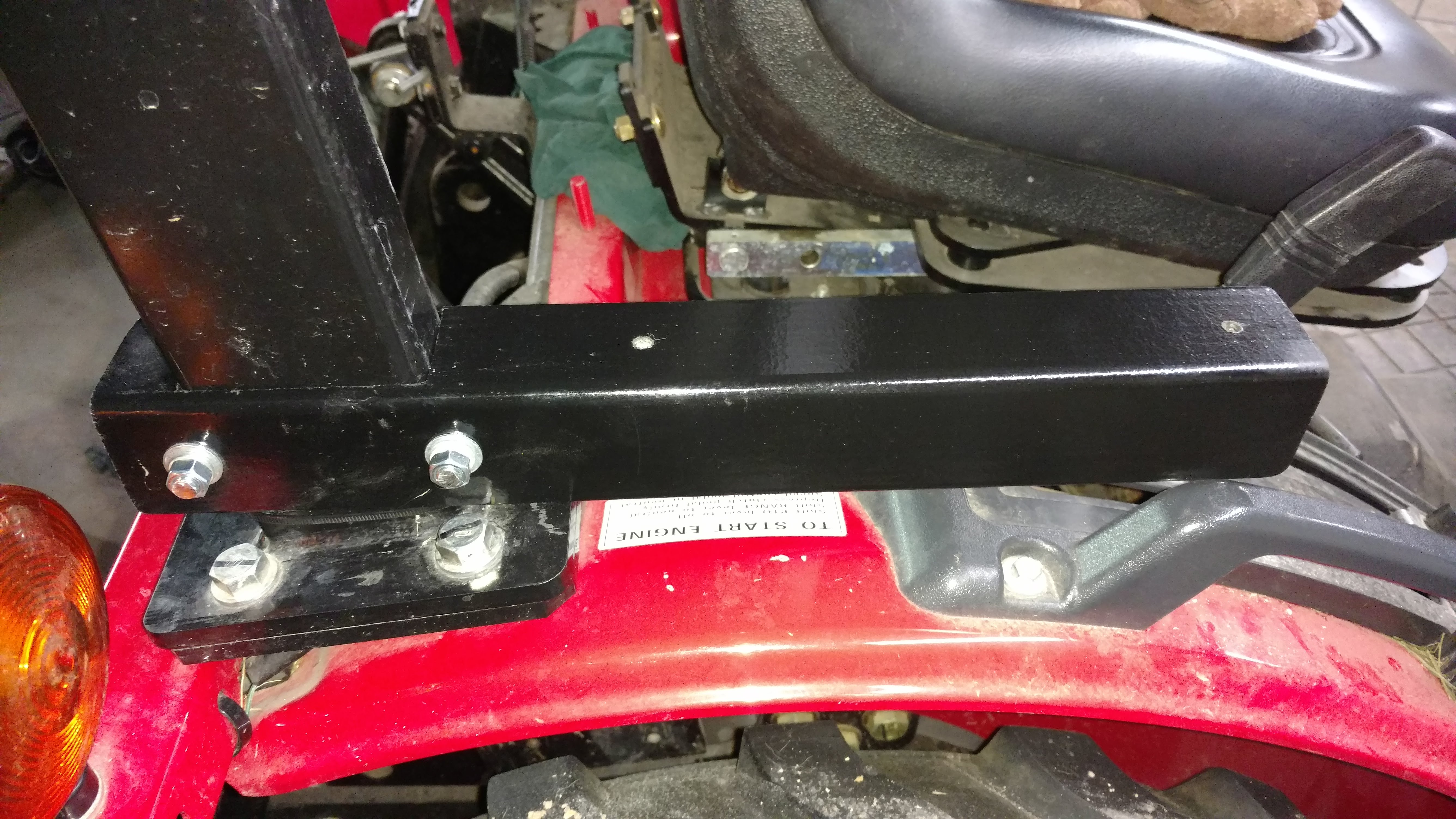

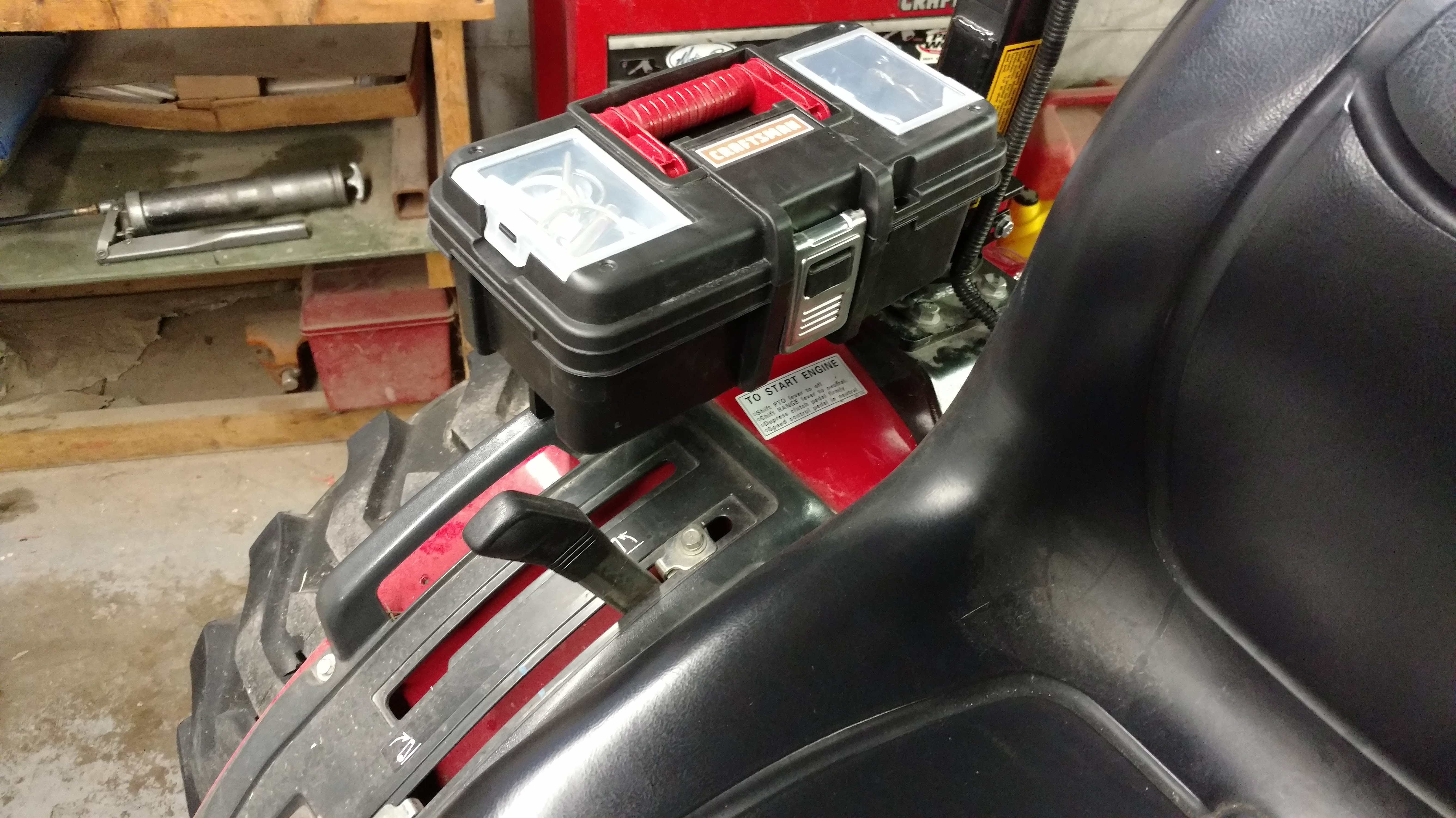

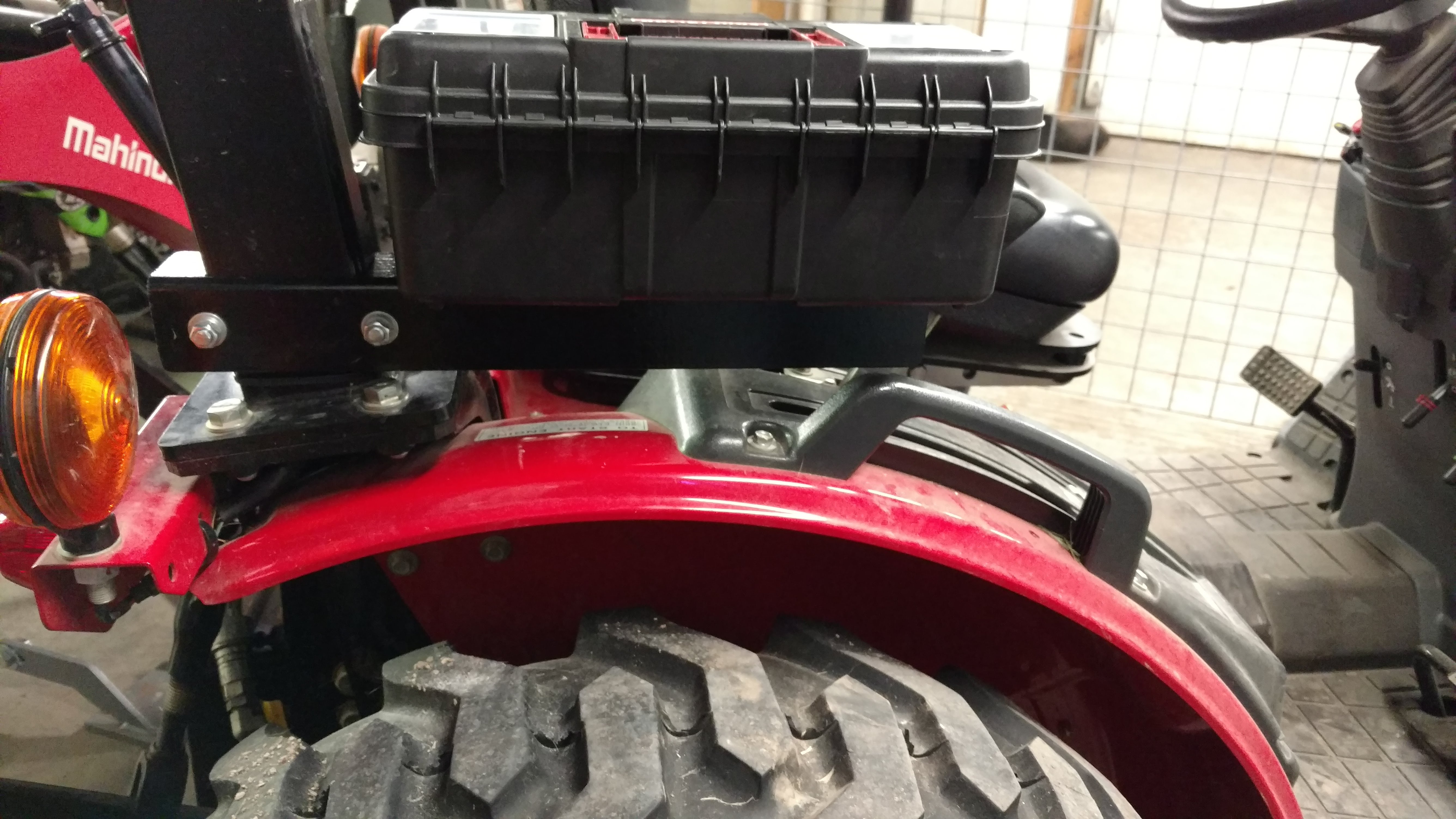

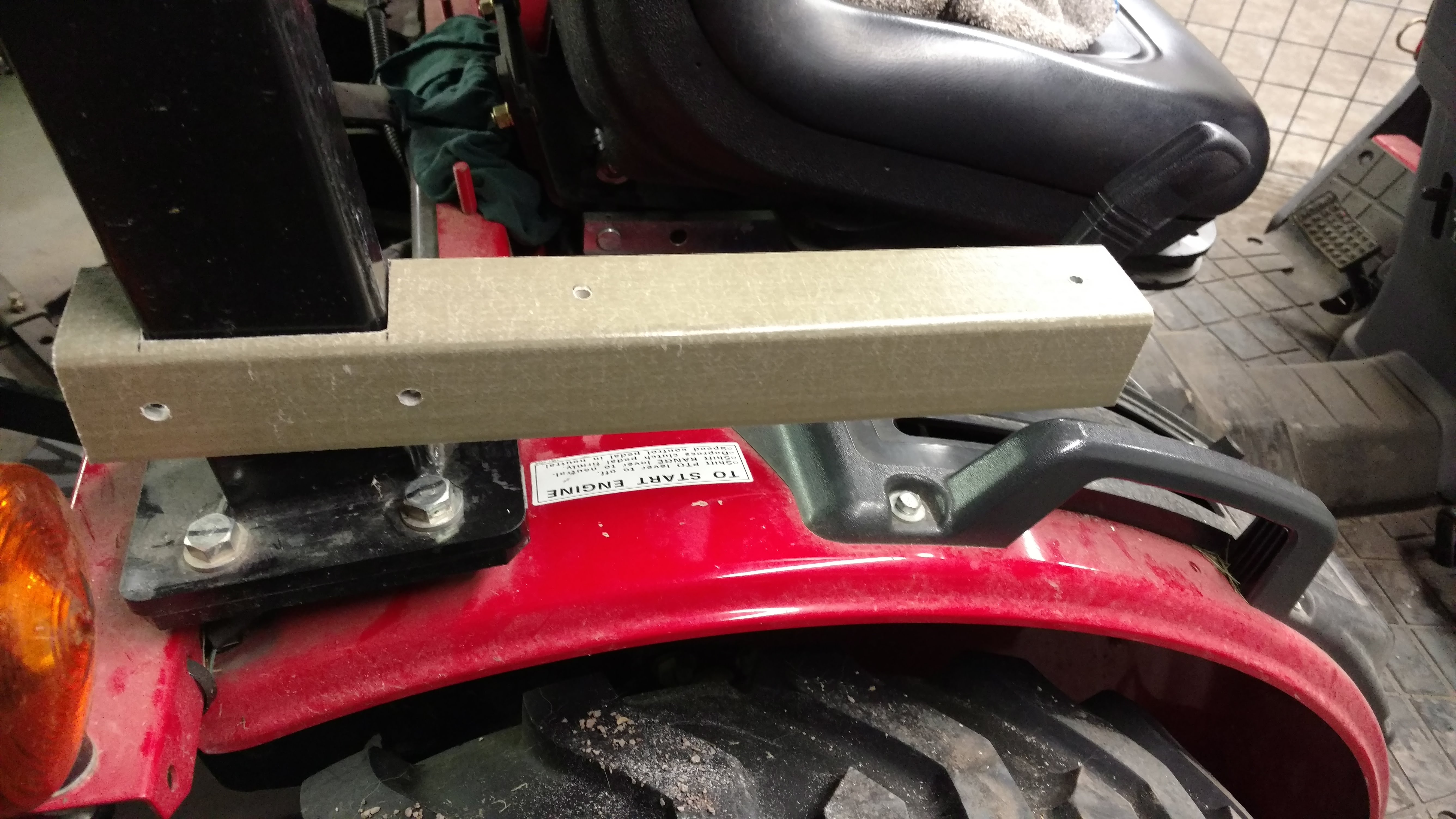

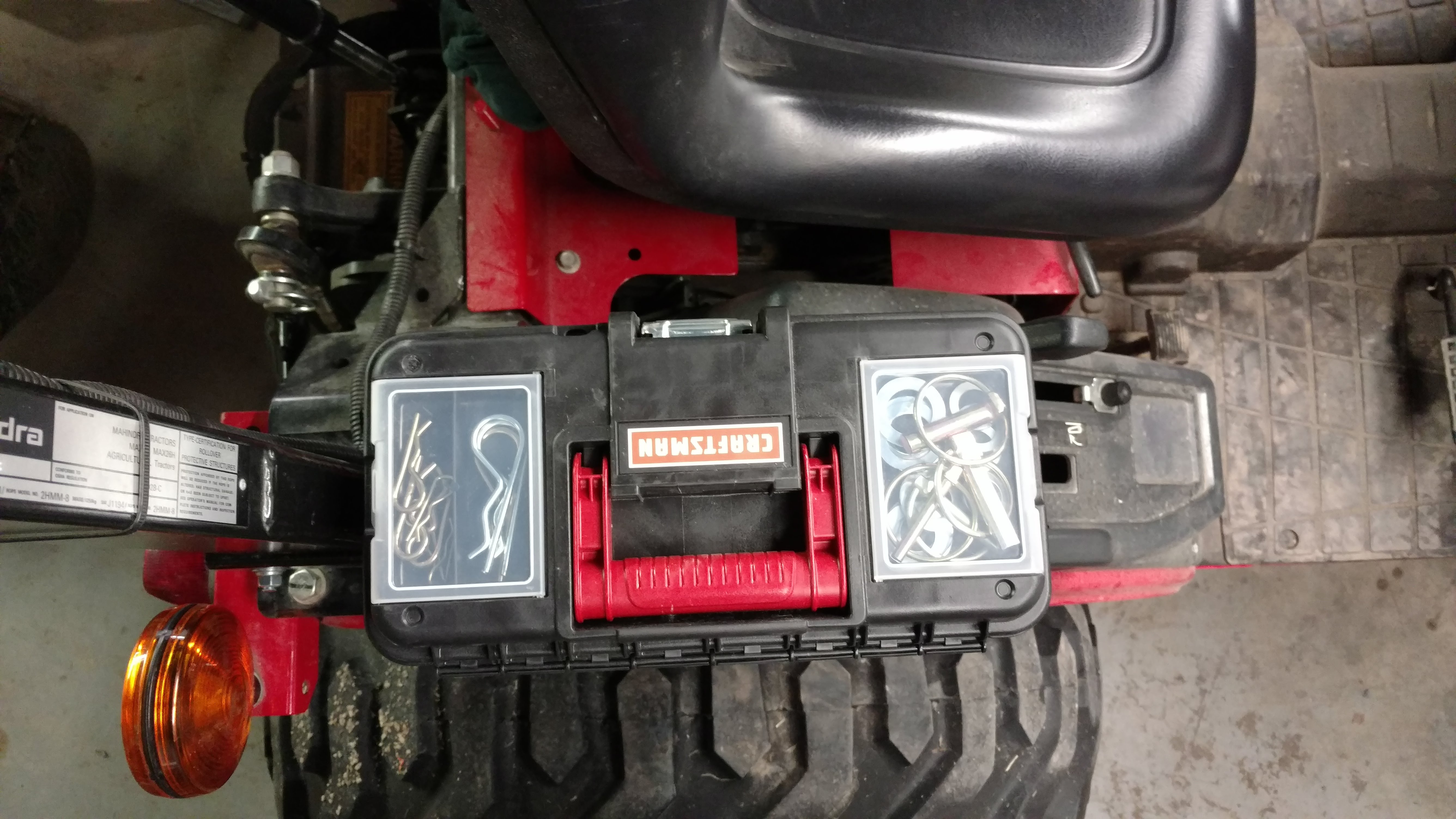

I wanted a small tool box above the fender also, but I used a piece of fiberglass angle attached to the ROPS to extend over the fender and support the tool box. Kind of ironic, but I used wingnuts on the inside of the box so I could quickly remove it without tools if needed, lol. The box has small compartments on the lid which is great for storing pins and small items, which are handy to have extras at the jobsite. I got the angle from my workplace, $6 toolbox, U bolt and a couple 1/4-20 bolts. All in all about $10.
