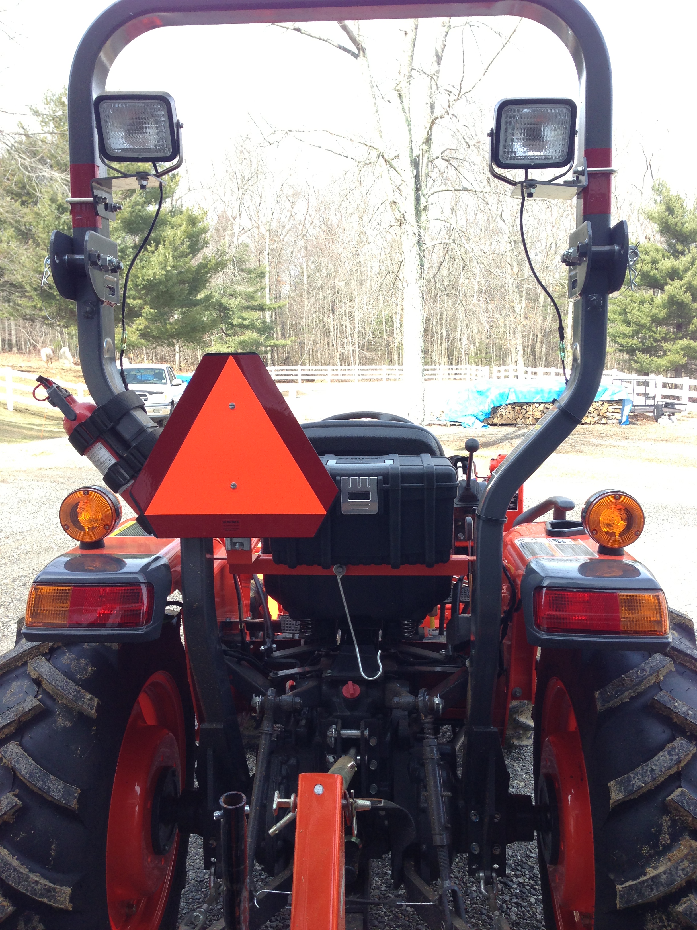

Here is my 16x6x5 tool box on a 1705 behind the seat.
Jim.
/ Tool Boxes on Fenders #24
"behind the seat". Probably a whole lot better than my fender location. It shouldn't rattle & shake back there.

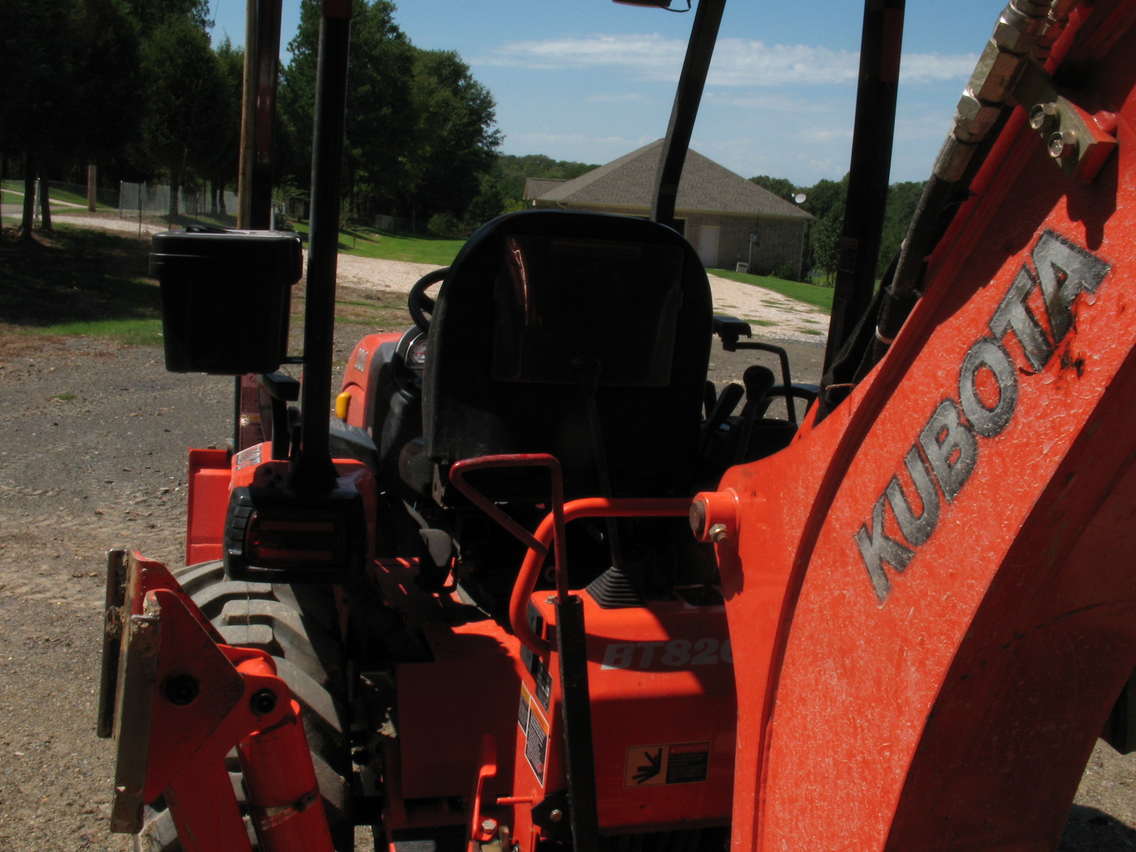

I wanted a small tool box above the fender also, but I used a piece of fiberglass angle attached to the ROPS to extend over the fender and support the tool box. Kind of ironic, but I used wingnuts on the inside of the box so I could quickly remove it without tools if needed, lol. The box has small compartments on the lid which is great for storing pins and small items, which are handy to have extras at the jobsite. I got the angle from my workplace, $6 toolbox, U bolt and a couple 1/4-20 bolts. All in all about $10.

I mounted one to the FOPS on my B26. It is just at eye level so easy to see inside it. Not a real good photo but if you can zoom in it is good.IMG_1129.JPG It is hard to see in the photo, but it has the top platform box for the tool box and then a 45 degree stiffener brace underneath. The frame is all welded together and then bolted to the FOPS. It is very secure. I had to drill 4 holes (1 at each corner) in the bottom of the box to attach it to the box frame.
