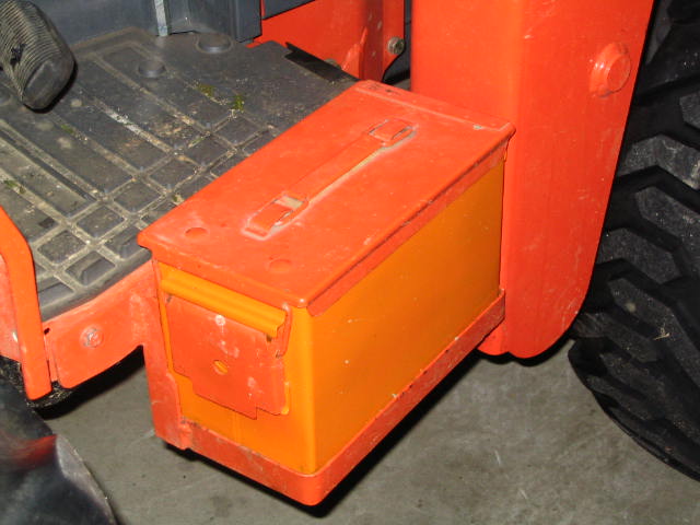

Did likewise with my Kubota L3010 HST. (50 cal. ammo box)
Made a frame for it and mounted it to the right hand side.The right side is a dead spot anyway, the HST pedal,and loader control are there. There is also no step on the right side.I carry a short length of chain(4') plus my lift kit adapters.My storage box has been on for 3yrs.,it's a real asset.

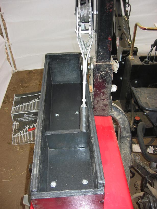

I did the same, only used a metal tool box to keep hand tool in which was from one of my old lathes. I built a wooden box to keep chains in and the top link when using the backhoe attachment. Both are bolted to the fenders with 1/4-20 bolts and "ny-lock" nuts.

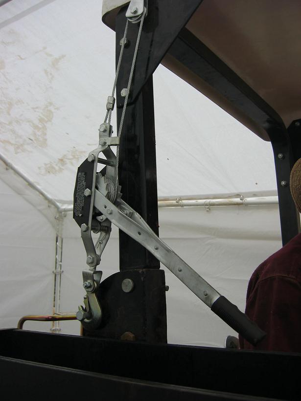

Also had a chance to mount a Come-a-long to the tractor to get my wife out of the same ravine she gets stuck in everytime she gets on the ATV. It is suspended above the tool box between (2) Ø1/2 bolts by tension and a bungy cord to keep the handle from rattling. It's come in handy several times now.

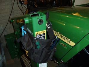

The local JD dealer had a little canvas-like box that fits on the back of the seat. Saw it the last time I was there but didn't ask about the specifics.
I use a tool belt attached to my FEL tower to hold big scissor-type tin snips, folding pruner, channel locks, multi-screwdriver and some occasional Cat 1 pins.
Got another soft case that mounted to the top of the cage they put on to guard the radiator from the FEL. It holds my persuasion hammer, as it's too heavy to stand up in the tool belt.
