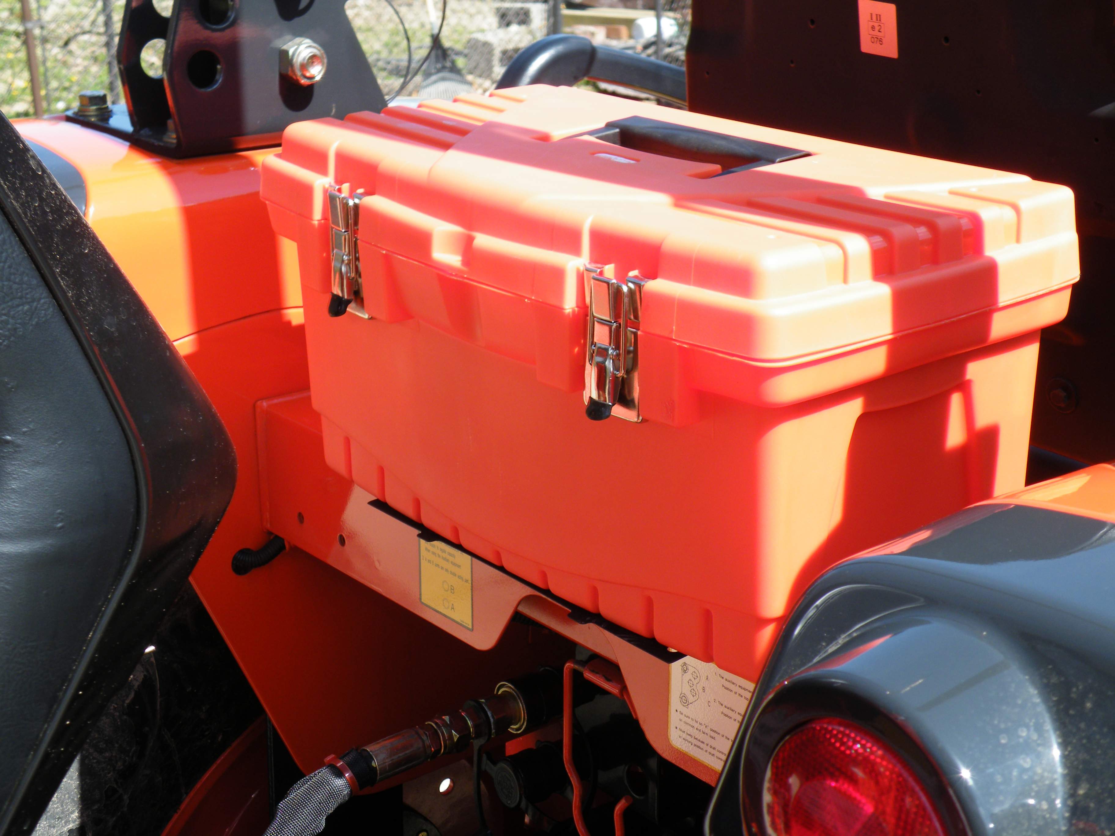

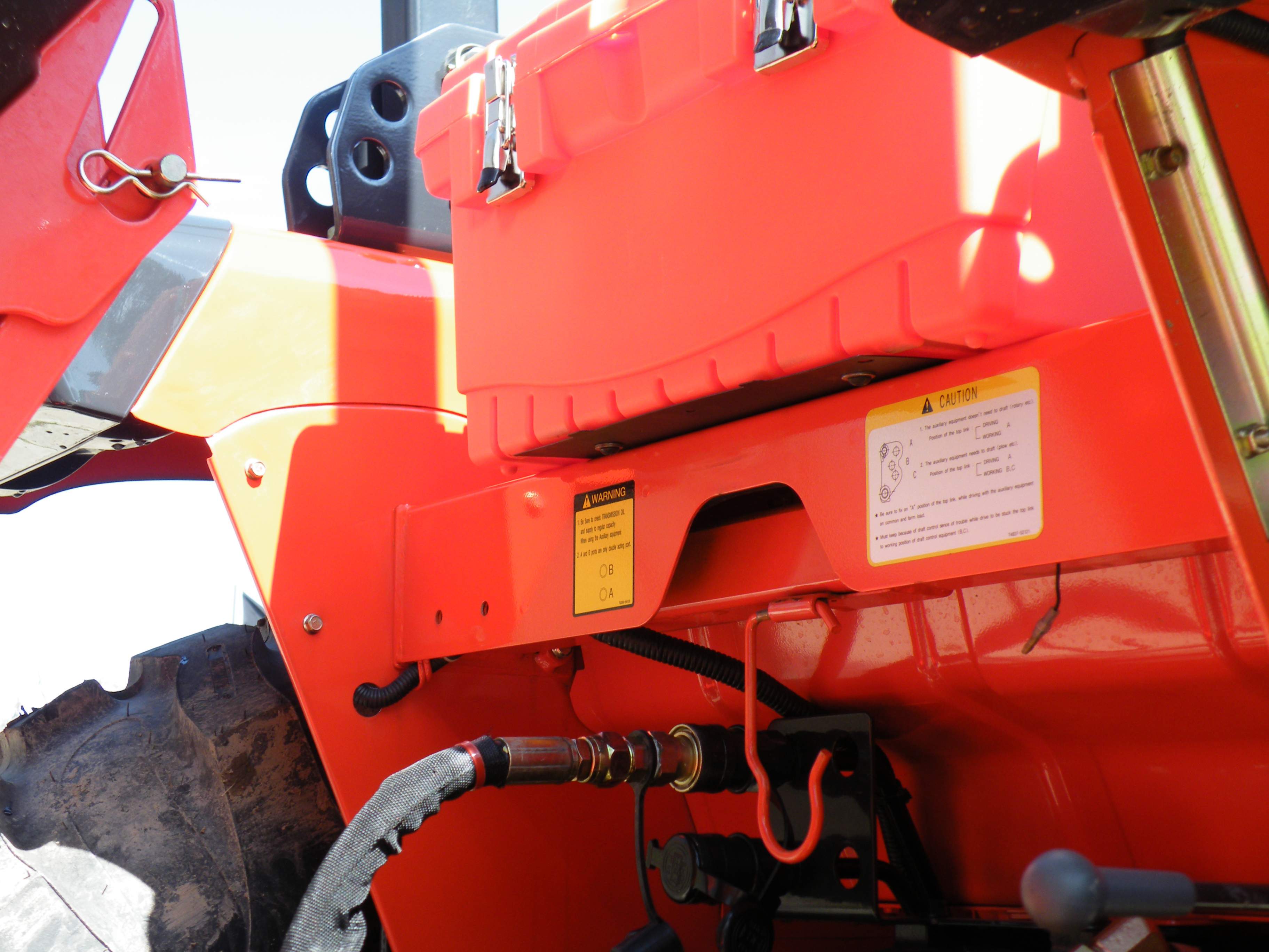

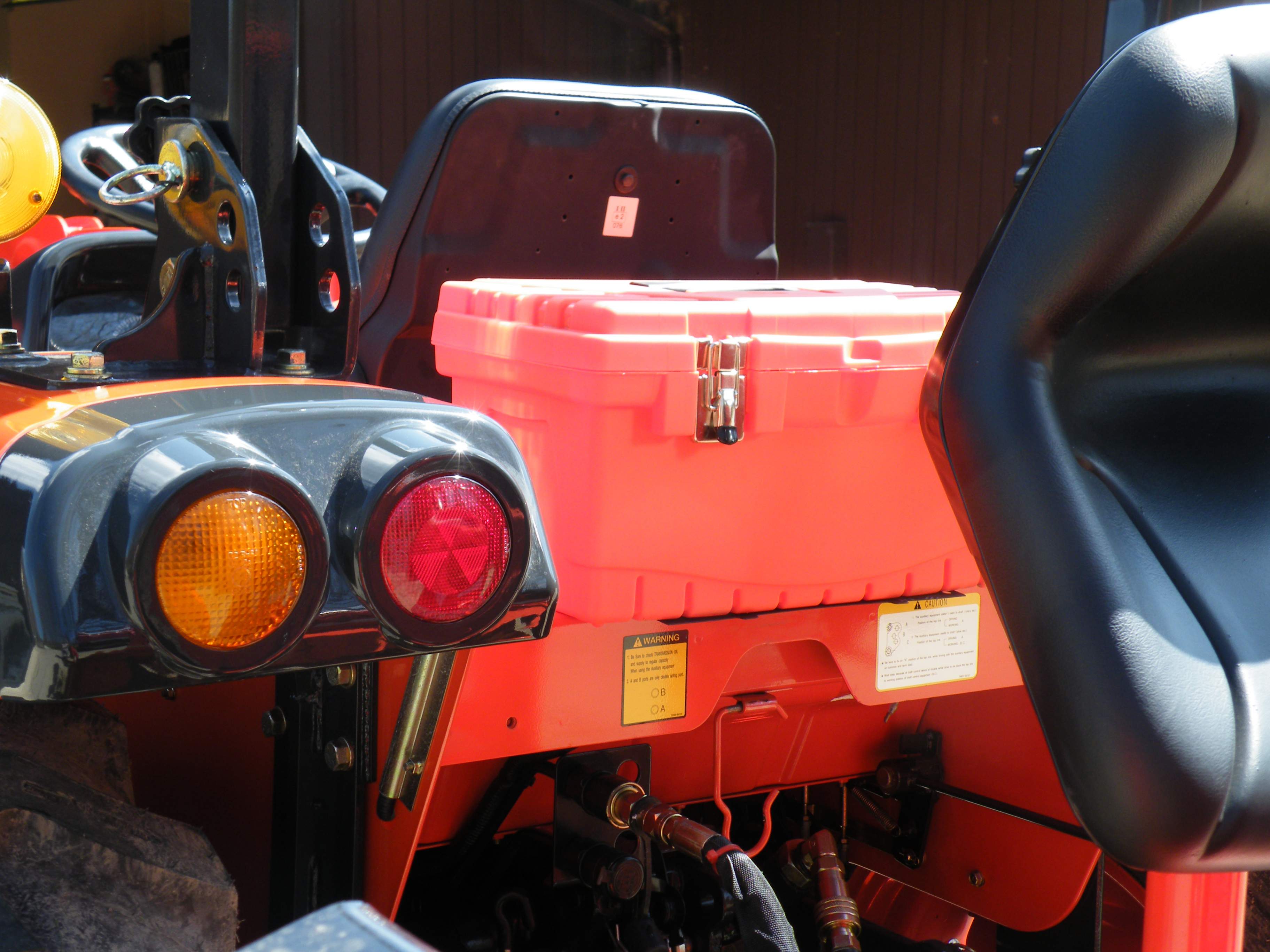

Check out this tool box install,Got this orange box from Home Depot.

Does the backhoe seat rub against it? On my CK35 there is only a few inches between seats when I have the backhoe on so can't see it fitting on mine. :(

Ditto on the hoe seat fitment. We need real life answers-:thumbsup:

Good job on the tool box. I'm curious about your pics though. You have your supply line for the bh plugged into one of the ports of your remote, but pic 1 seems to show a separate return. I have a Woods bh, is that just the way they're set up on the Kioti bh? What is the advantage of doing it that way?
/ Tool Box #8
That is the 'new' way to plumb anything running off the primary rear remote. It is a kit that Kioti supplies with the newer tractors to allow for the return to flow into what was originally the fill/vent port. The vent now goes to the left side and this setup makes for more flow to things like a hoe so that hoe can get more fluid and react faster than the prior setup. I have it on mine, and had it on my DK-35 too, and it works great. I'm not sure how far back it retrofits- check with dealer parts network.

thanks, very interesting. I wonder if it's a DK thing, my CK is 2011 and that's not how it's set up.

I was told the return runs much cooler that way..
