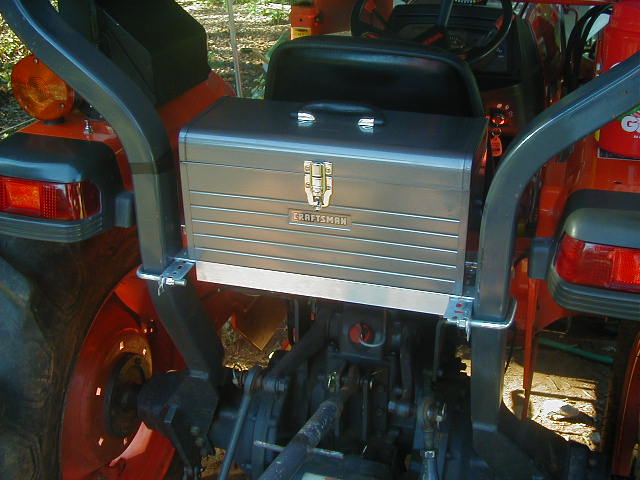

I mounted a toolbox behind the seat on my BX18000 almost two years ago and have not had any problems or damages. I've attached a picture showing the box with the seat pushed all the way to the back position.
/ tool box and box blade #11
Trying again with the file attachment

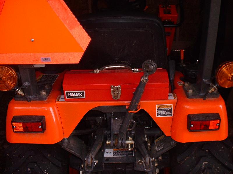

There have been a plethora of threads on mounting a toolbox. I'm not sure where to start but <A target="_blank" HREF=http://www.tractorbynet.com/cgi-bin/compact/showflat.pl?Cat=&Board=owning&Number=42589&page=&view=&sb=&o=&vc=1>here</A> might be as good as any. The magnetic attachment method has been well pursued led primarily by the metal stylings of good 'ol Harv. I built my "Rops Rack" largely based on his design. It is held by magnets and can easily be removed and replaced with just about whatever you want. Of course, being magnetic the rack will hold metal objects a whole lot better!
