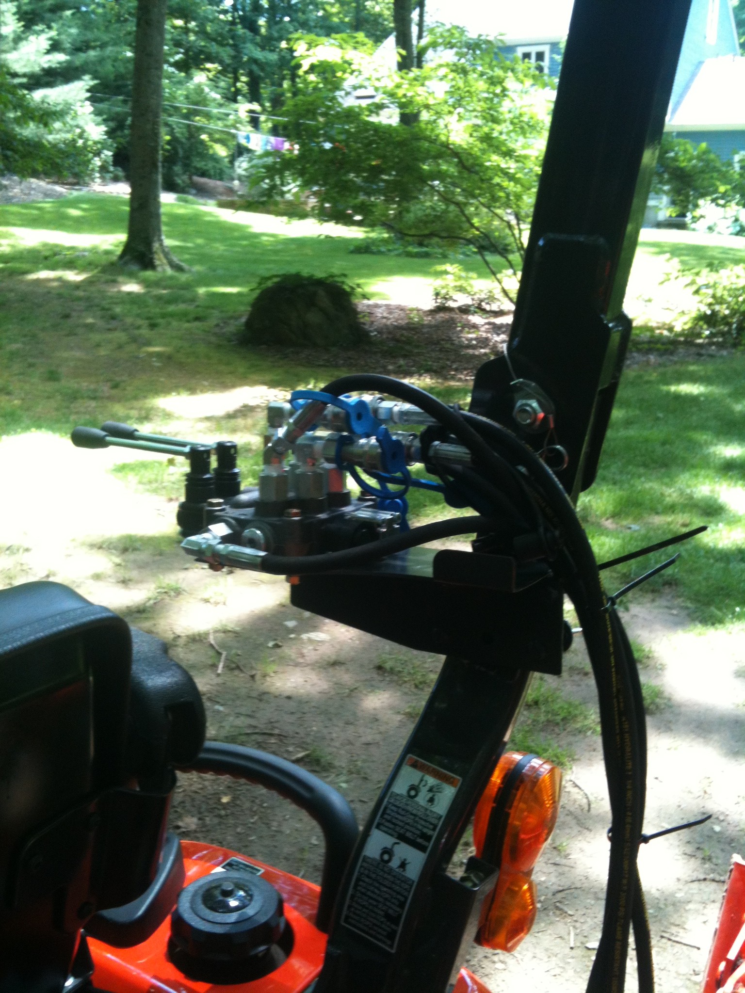

I see you have some auxiliary hydraulics added. Did you do this yourself, or what.

That's my old BX1860 in the pic's. I did add the hydraulics myself, but from a kit that Kubota sells for later model BX's except those with the backhoe (ie., BX24, BX25, BX25d. The kit is pretty slick and wasn't too hard to install. The valve mounts to the side of the transmission and the levers to open/close the dual circuits come up through that open slot on the right side fender. The kit won't fit the backhoe models since the BH subframe interferes with where the valve gets mounted. However, I put together an aftermarket solution for my BX25 with the valve mounted to the right-side ROPS. Not as elegant but works just the same.
Anyway, if you ever want to add the rear hydraulics, see a Kubota salesperson, not parts. It's a wholegoods item and needs to be ordered through the sales dept.
