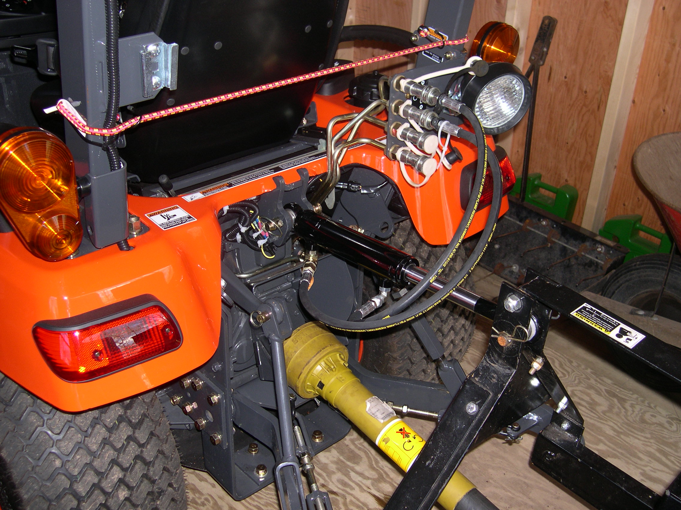

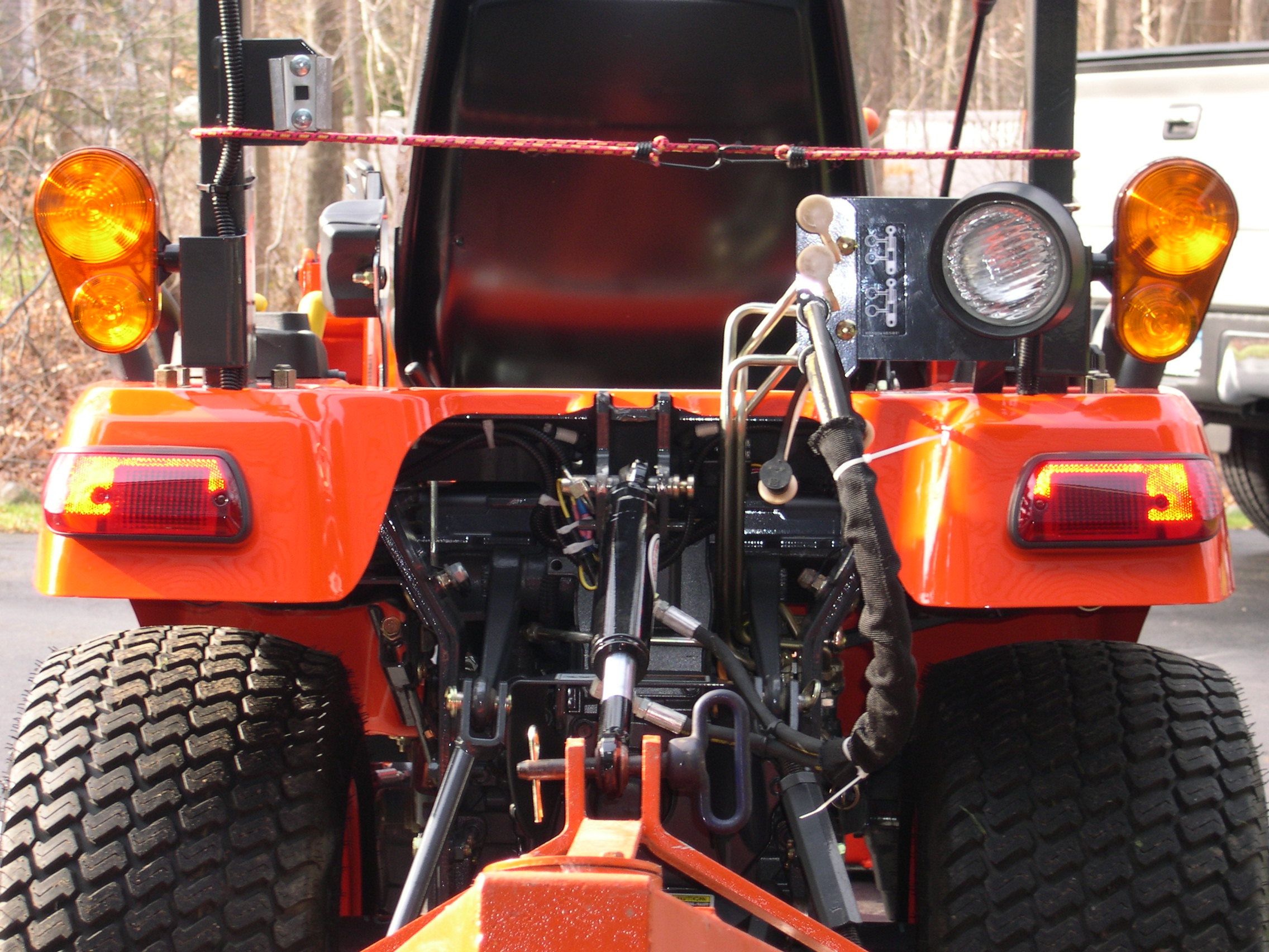

   / too many implements at one time #8
Take a look at the second pic for the hole just above my hydraulic top link. Ignore the first photo which doesn't show the holes, but I couldn't figure out how to delete it. Move your vertical lift links to these holes to keep the 3PH up.
