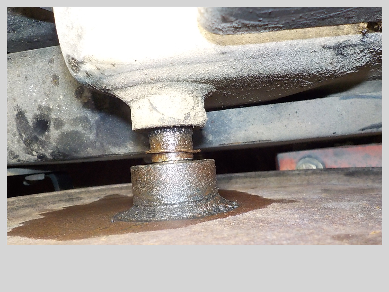

I could use a hand with some suggestions on how to get this pulley off my rototiller.
It's so large that my pullers won't fit. New trans/axle assembly going in, drops down, not up so pulley
won't clear, has to come off. Has a keyway.
Does one just take a block of wood and gently persuade it?
What do you use when you don't have the right tool?...
thanks

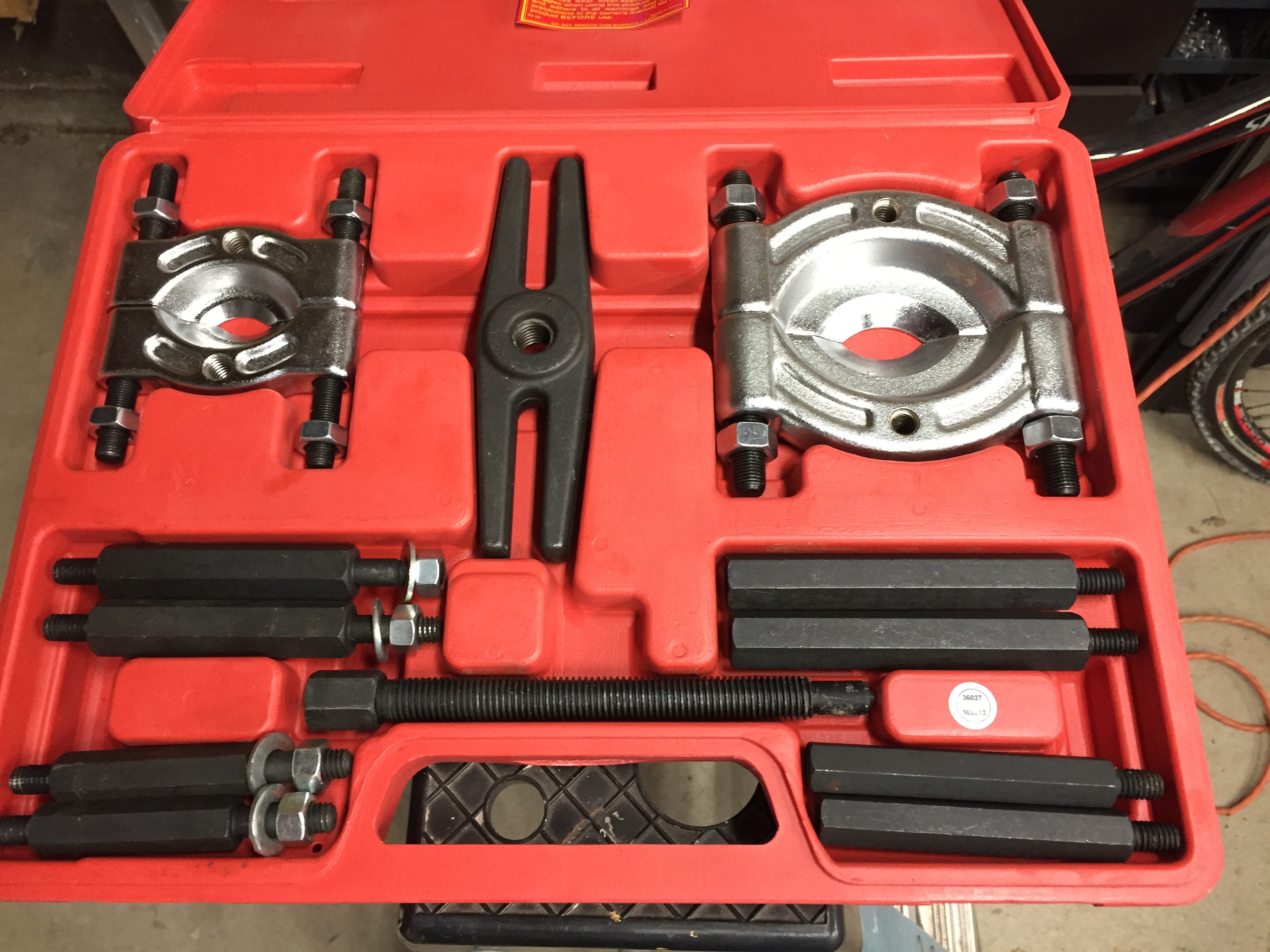

I've used this HF bearing separator for a lot of awkward things. The pieces are easily adaptable to use with longer bolts or rods or just heavy flat bar drilled where necessary.

How about drilling two holes equally spaced from the centerline of the shaft and opposite each other through the pully then using suitable bolts, nuts, and washers affix your puller.
If possible, the application of some heat might expand the hub enough to get things moving.
Reassemble with a slathering of antiseez compound to insure EZ disassembly in the future.
Does sound like a good excuse to purchase a bigger puller however, as the guy who dies with the most tools has the best auctions.

Clean/chamfer the end of the shaft a bit first
You might try a tie rod tool or pickle fork on the backside. It LOOKs like there may be enough room. Might be enough to break it loose then continue with a wooden block or spacers and the wedged pickle fork.

thanks guys, going to use a little heat and see if I get lucky.
pickle fork and wiggle wiggle wiggle....
if not, trip to Napa for an expensive tool I'm sure.

This/\/\/\ and patience.
I had a similar problem on a mower pulley that I could not get off or access.
I first doused it for about a week with loose juice and then
heat, a tapered block of wood and a hammer was the only "wrench" that would fit.
I pounded the bejeesus out of it and it finally gave up.

friendly persuasion did not work, bit the bullet and bought a nice US made 10'' puller.
what concerns me is putting too much pressure on the pulley, I doubt it's very strong

Try to put a couple pieces of flat bar on the back face of the pulley to distribute the pulling forces of the jaws.
Once the puller is under tension give it a few taps with hammer and pickle fork again.
Forget the friendly persuasion. Grit your teeth and cuss. Works for me.

Yep, it’s easy to bend or break a pulley. I know better than pulling on the inside but there wasn’t room under this one.IMG_1415.JPG

+1 on drilling and tapping holes
/ Todays shop time. #816
The pics look like the end of the shaft needs some grinding and cleaning as mentioned but maybe you already did that after the pics were taken. Also as mentioned, I would drill holes close to the shaft as possible and that allow your fingers to fit, then use the puller. Too far out and you will ruin bend the pulley easily. Holes can be filled in with a welder if needed. Seeing you are replacing the gear box I would not be too concerned about ruining that side with a pickle fork. Bang on it, remove and spin the pully 180 and bang on it again, rinse and repeat.
