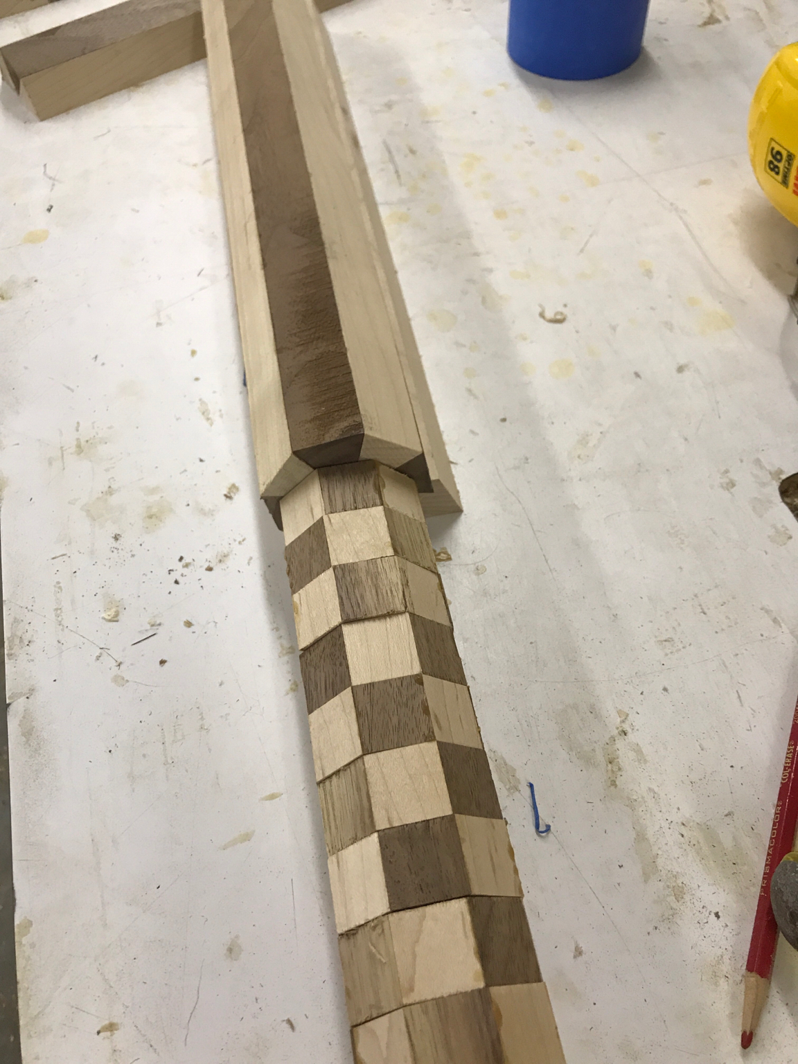

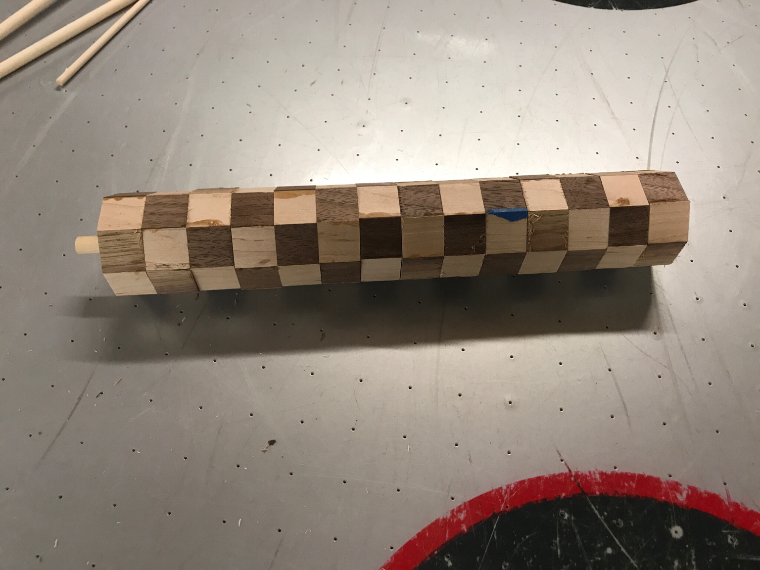

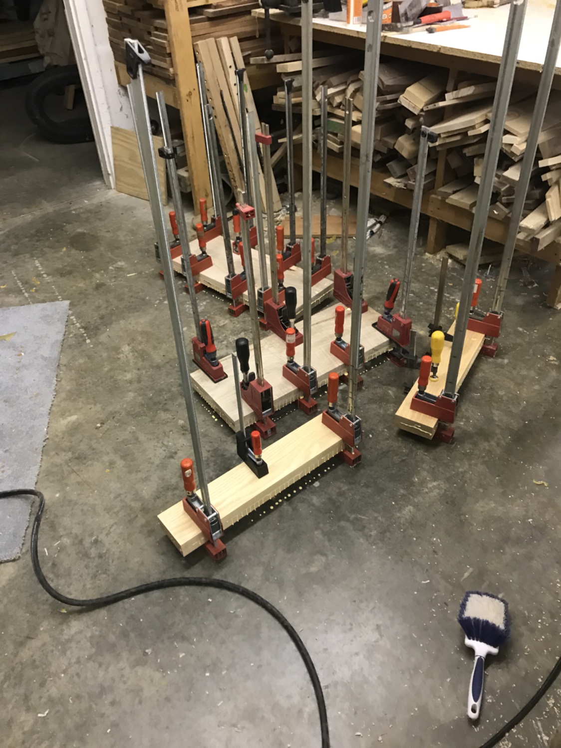

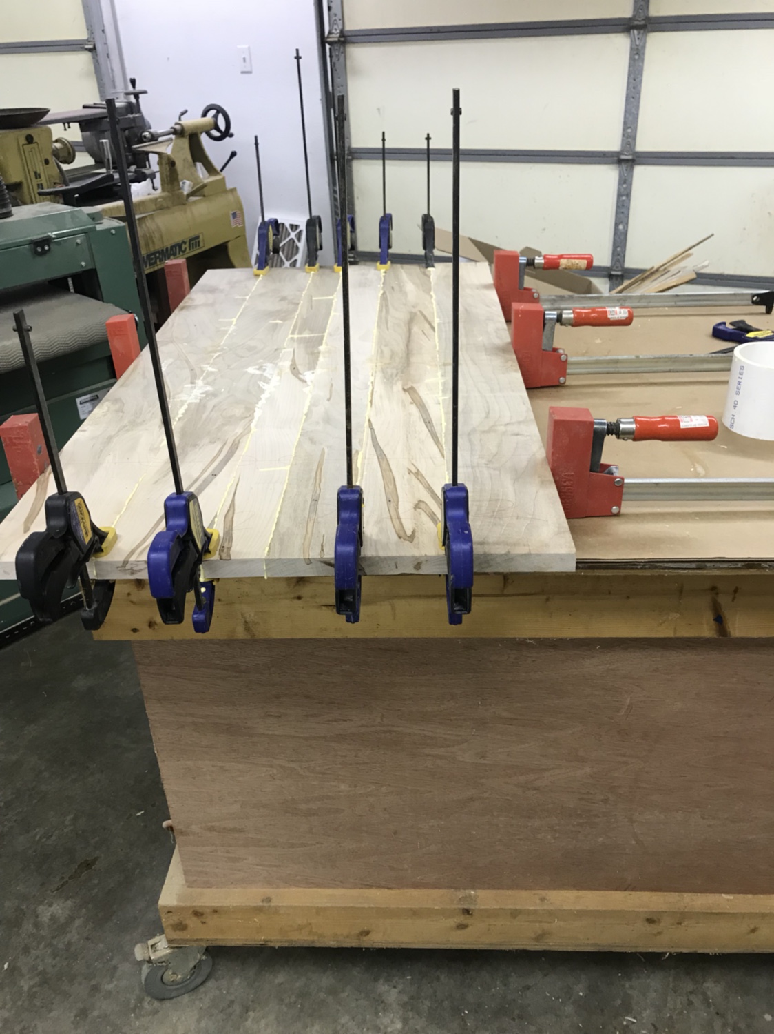

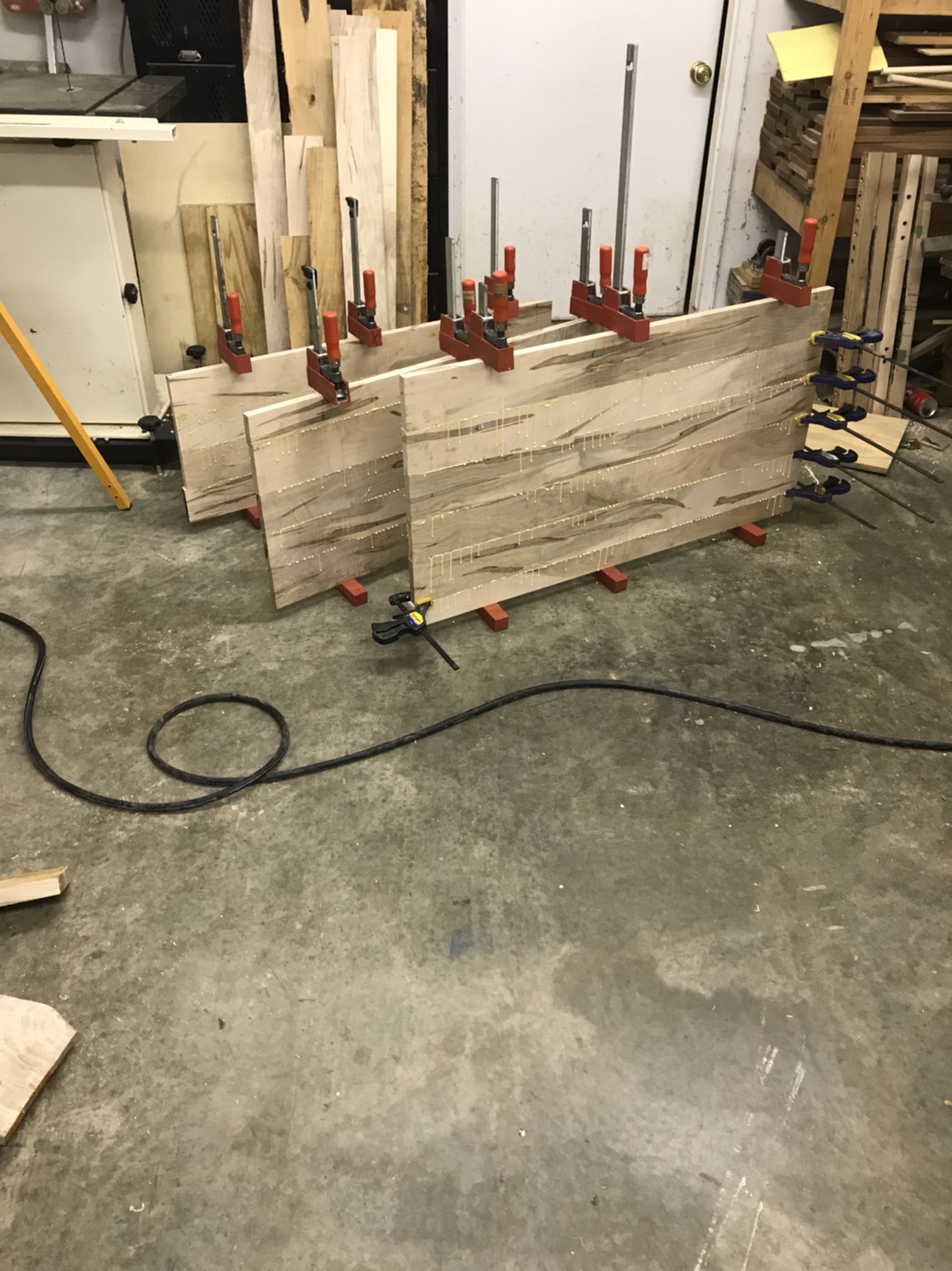

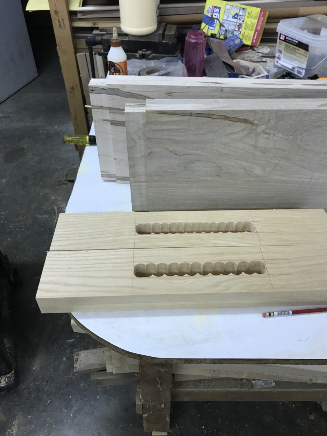

I’ve been working on a table. I’ve got the top glued up in 4 separate panels and I’m waiting on getting the base done before I finish gluing them. I’ve got most of the pieces for the base glued up but it still lacks quite a bit of work. IMG_1343.JPGIMG_1344.JPGIMG_1320.JPGIMG_1328.JPGIMG_1321.JPG

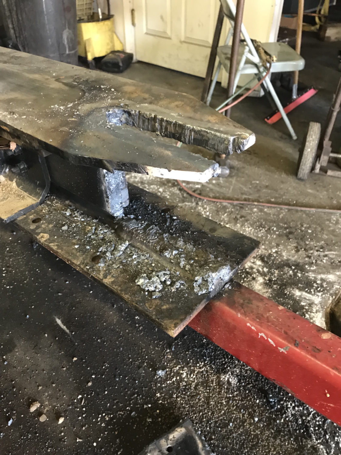

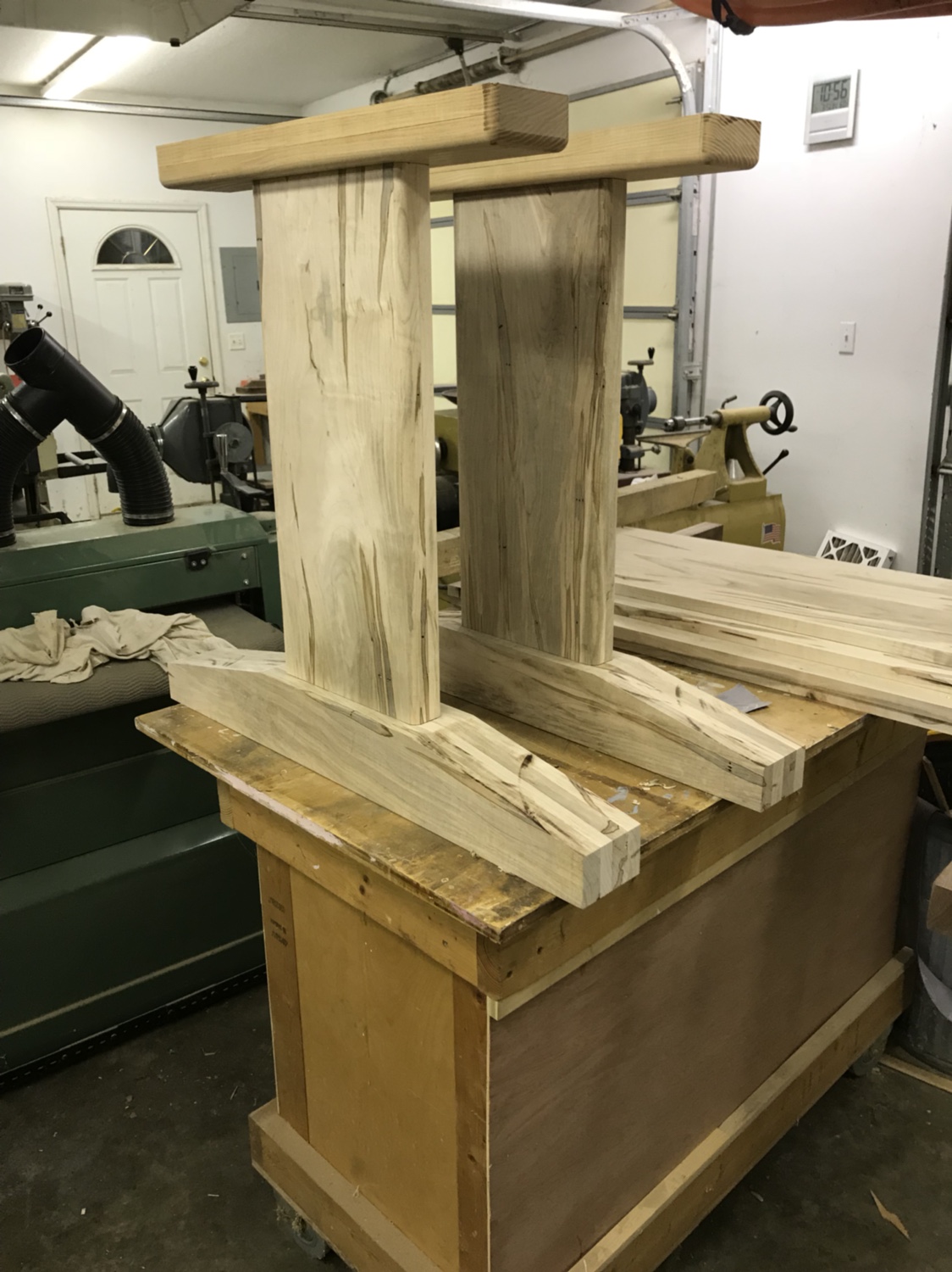

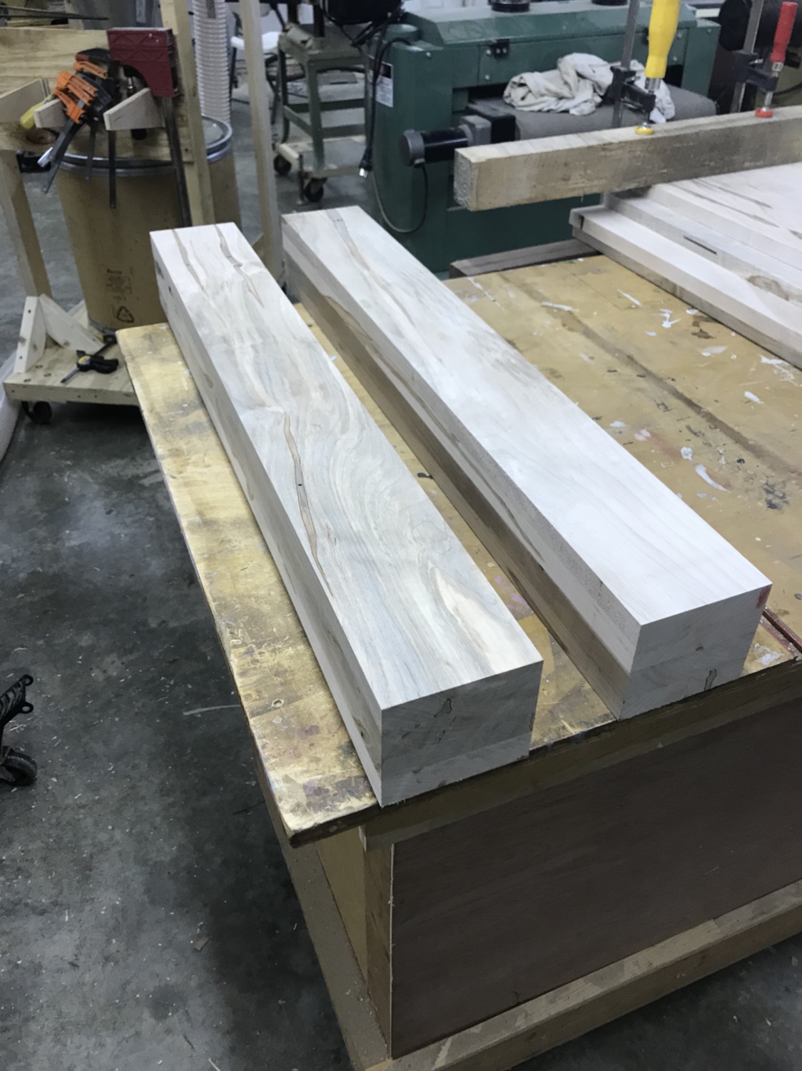

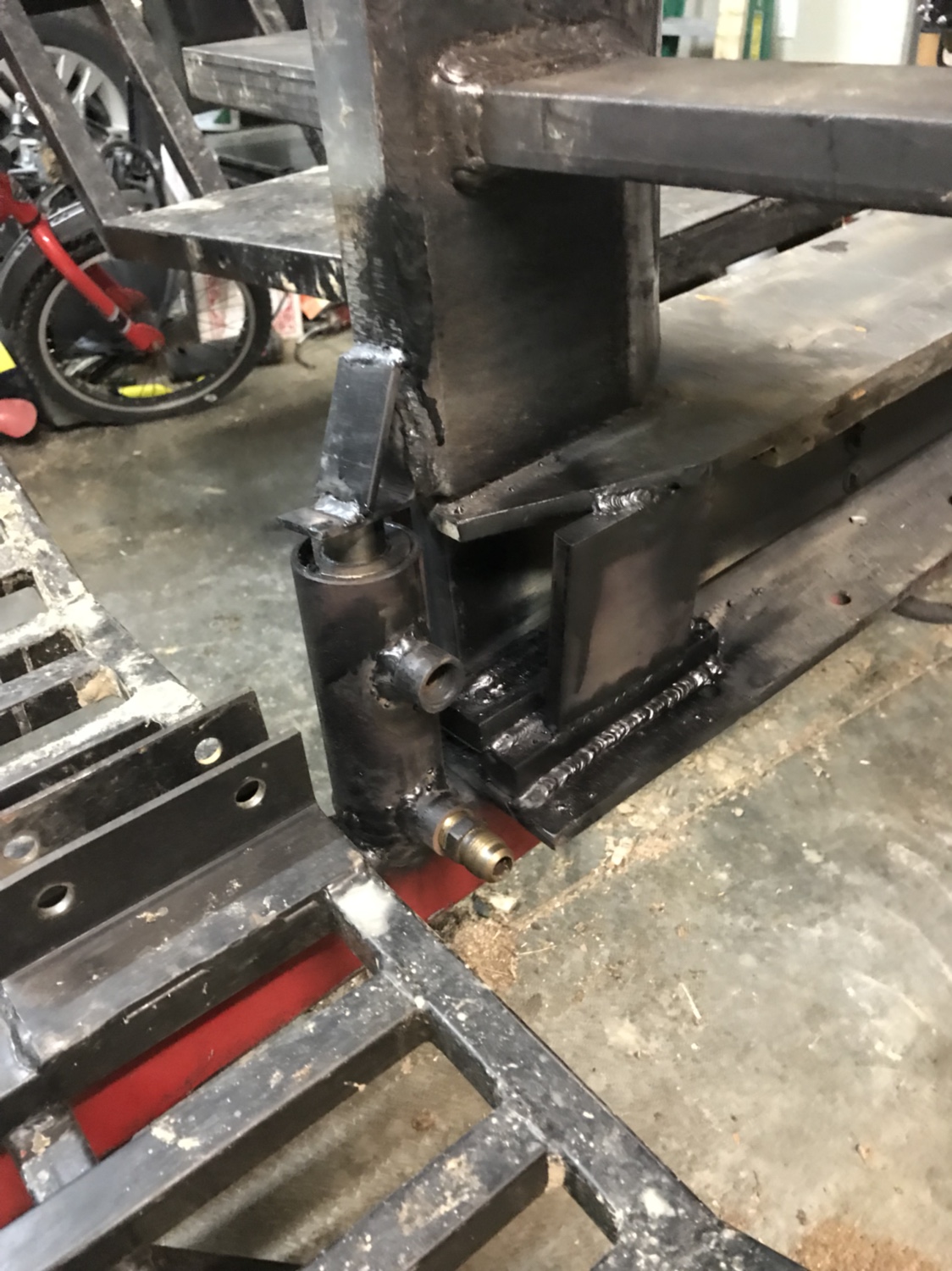

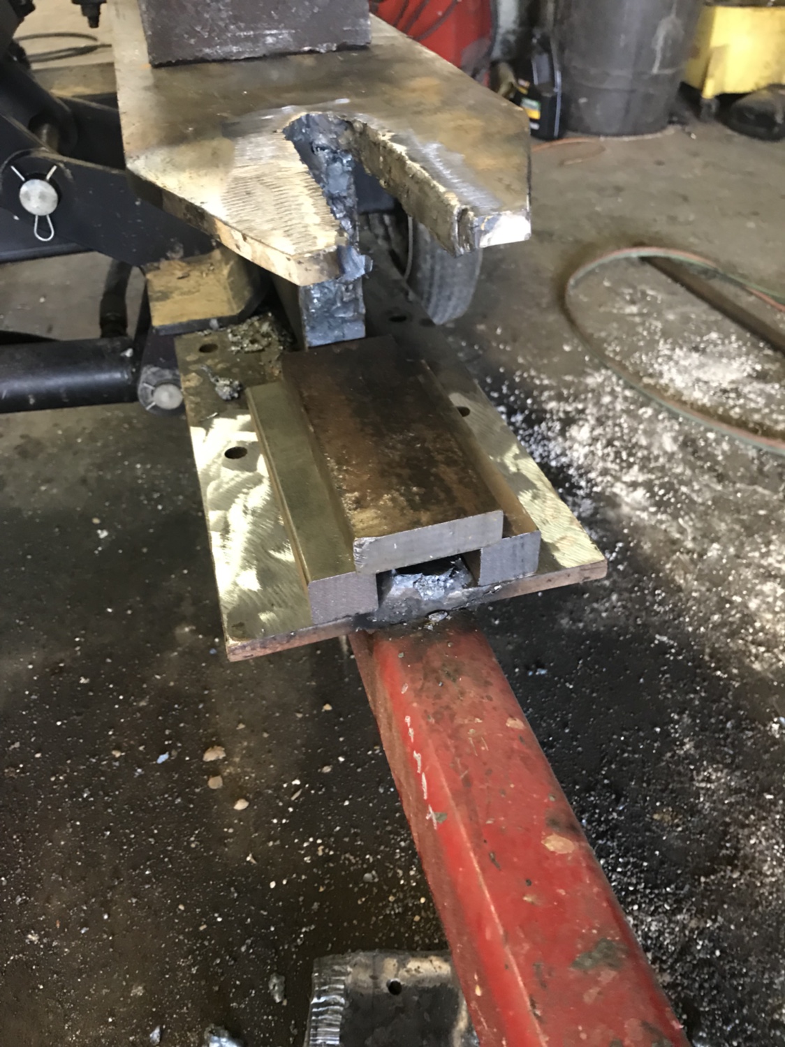

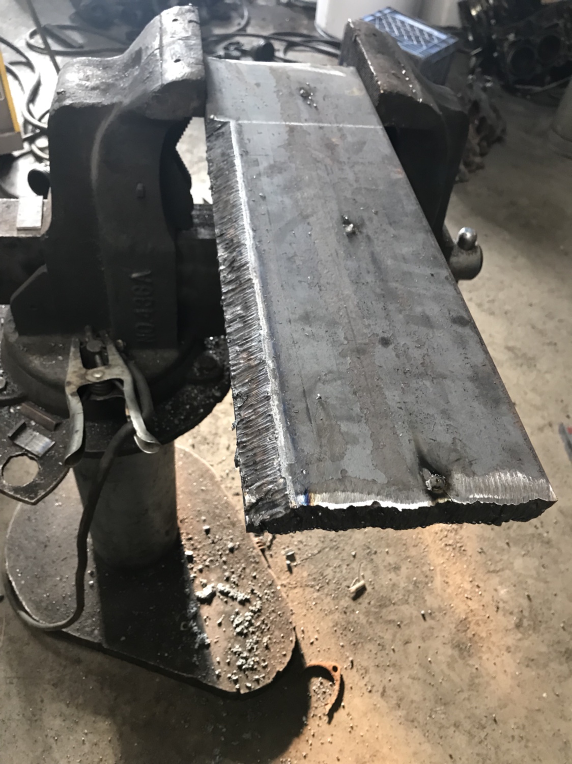

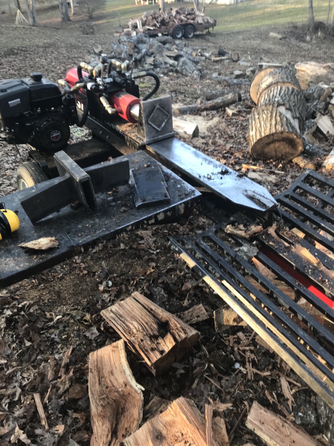

I spent about half a day working on my wood splitter yesterday. The wedge broke off so I cut it out and re welded it. I also added a hydraulic lift to the 4 way. This wasn’t an attempt to make it an adjustable height 4 way and more so I could push an already split piece under the 4 way without knocking a splinter off. And today I got the legs for my table nearly done.IMG_1338.JPGIMG_1361.JPGIMG_1362.JPGIMG_1363.JPGIMG_1367.JPGIMG_1378.JPGIMG_1387.JPGIMG_1384.JPGIMG_1385.JPGIMG_1374.JPG

I'd like to see more of your wood working projects. Nice work and very interesting how things go together and the joints you make. I've worked with wood all my life but I didn't learn much about furniture building with a chain saw or 20 ounce Estwing.

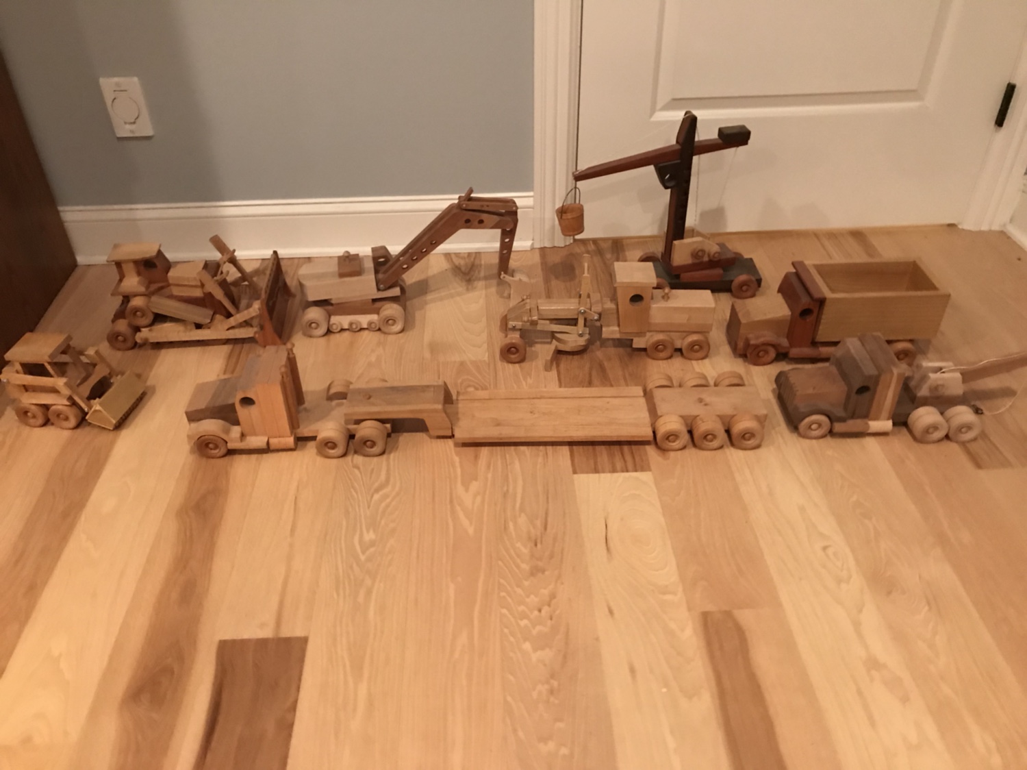

Here’s my wood construction fleet. I’ve been wanting to build a more advanced model and I never have. IMG_1402.JPG

They look familiar. Do you have a subscription to Wood Magazine? I think I still have most of the issues with those toy plans. I keep saying, one of these days I'll start building them.
/ Todays shop time.
#789
Not anymore but that’s where those came from.
/ Todays shop time. #791
When I was a kid I HAD a wood train set like that but it was commercially sold not hand built like yours. Iwould had given up my little brother for those.:devil::D:thumbsup::drink:
/ Todays shop time. #792
Love the wooden toys. I still have a bag of them from when I made stuff like that for craft sales, thirty five years ago. Grandson still plays with them when he comes over.

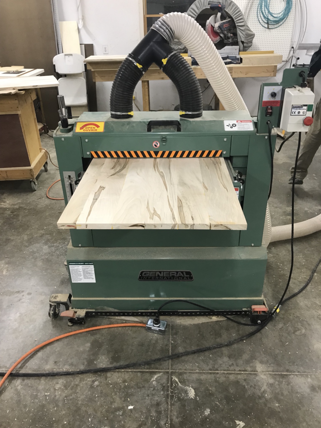

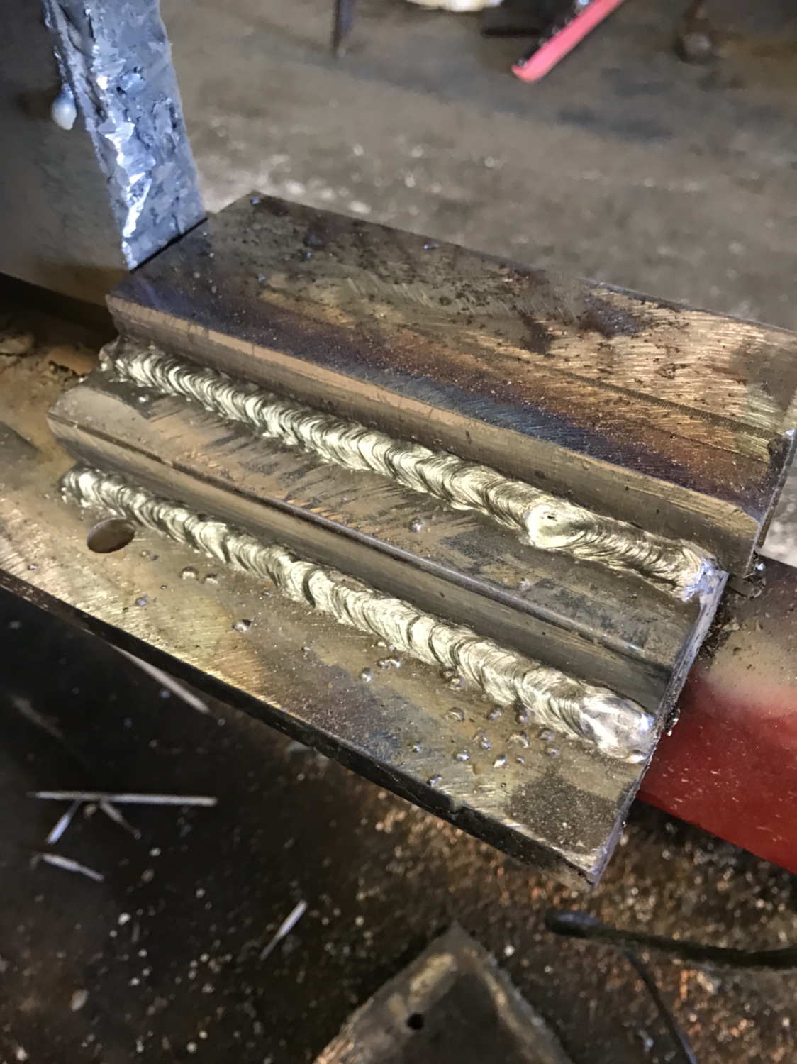

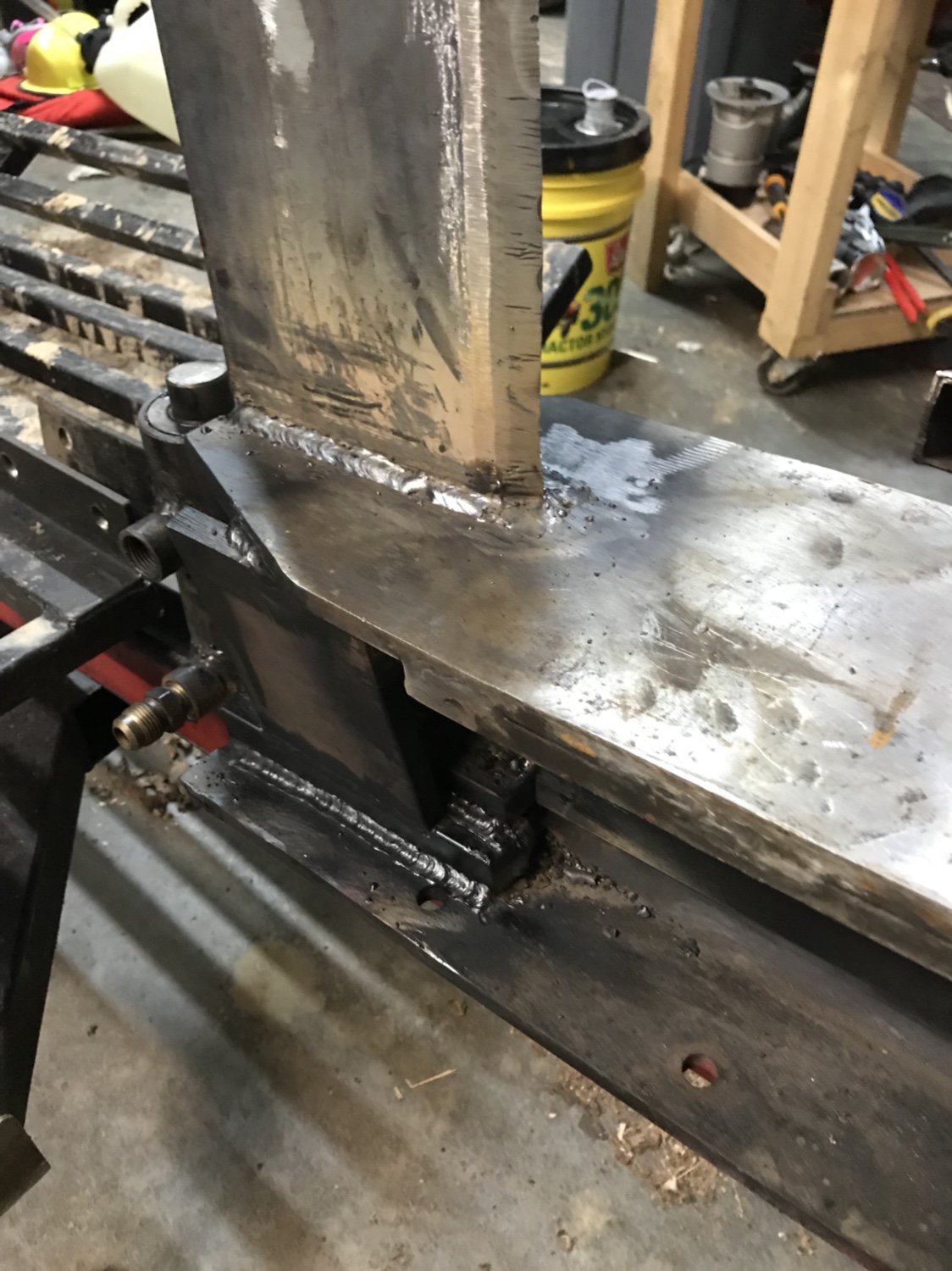

I had to weld some more on my junk wood splitter. The wedge I had to replace broke loose again. I had 12” of weld in shear strength so I only ran 2 passes because I didn’t think it would take much. I welded it back a little heavier and in the process I noticed the cylinder mount on the other end had a crack in it. I didn’t see any good way to reinforce it so I just welded it more and hoped for the best. Then I worked on the table. I hit 2 more bullets. I’m glad the soft lead doesn’t hurt anything because that makes 3 on the table saw and one for the jointer. IMG_1427.JPGIMG_1438.JPGIMG_1440.JPGIMG_1445.JPGIMG_1441.JPGIMG_1448.JPGIMG_1437.JPG

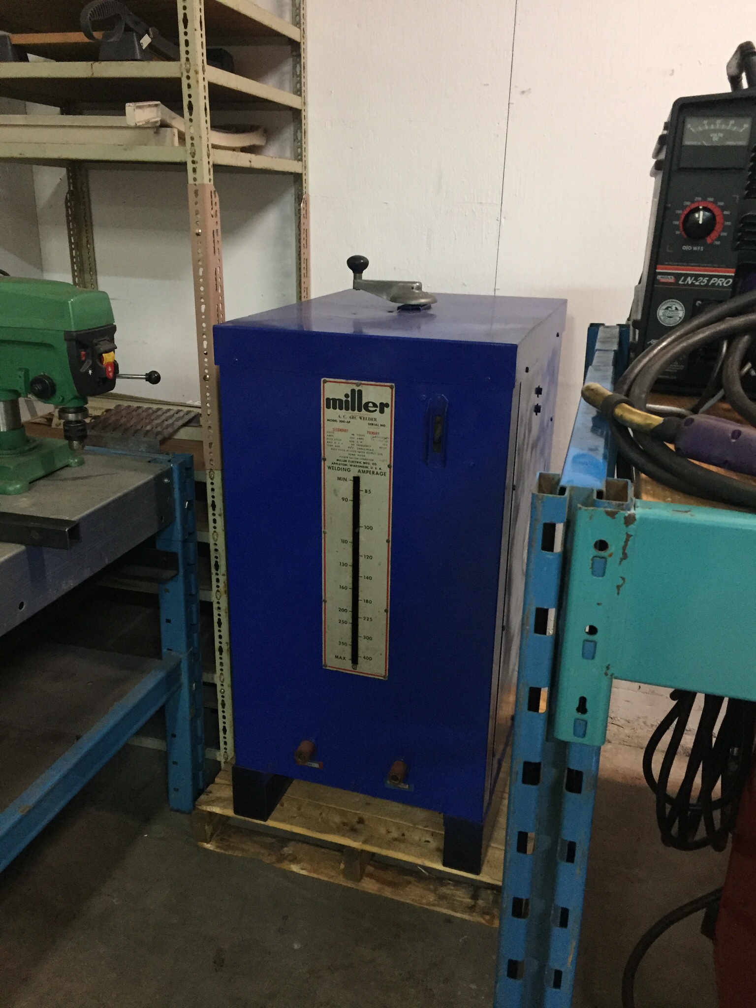

My ancient industrial Miller stick welder.

An old Dialarc ?or AC buzz box like mine? OR?
I love old welding machines.
/ Todays shop time.
#797
/ Todays shop time. #799
How old is that thing?
I think I checked the serial number for age at one time but can’t recall offhand. Probably from the 1950-60’s if I had to guess.
It was among a bunch of welding stuff I bought a while back. A real power sucker. It was wired to a hundred amp breaker.
/ Todays shop time.
#800
I don’t know how many amps mine pulls. I think it’s wired on a triple stack of 60 amp breakers. The maximum output is close to 500 amps. I’m not sure how big of a rod it would take to utilize that. Maybe an air gouge takes that kind of power.
