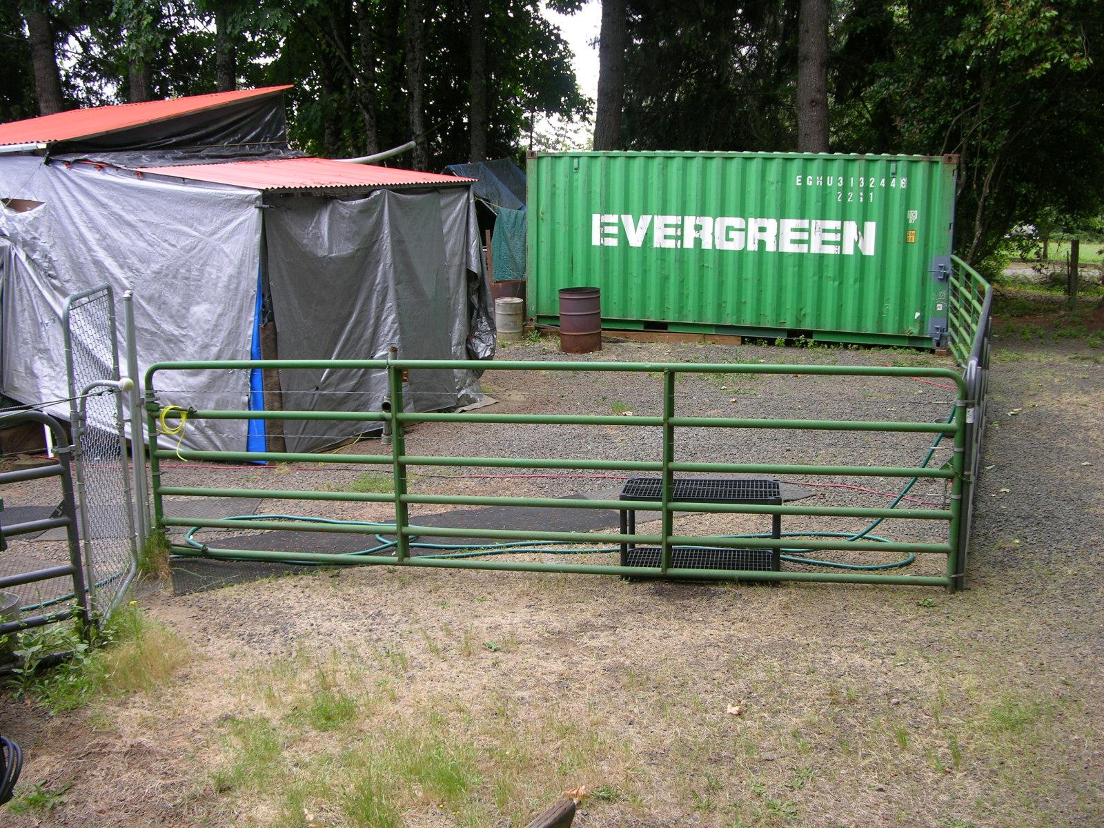

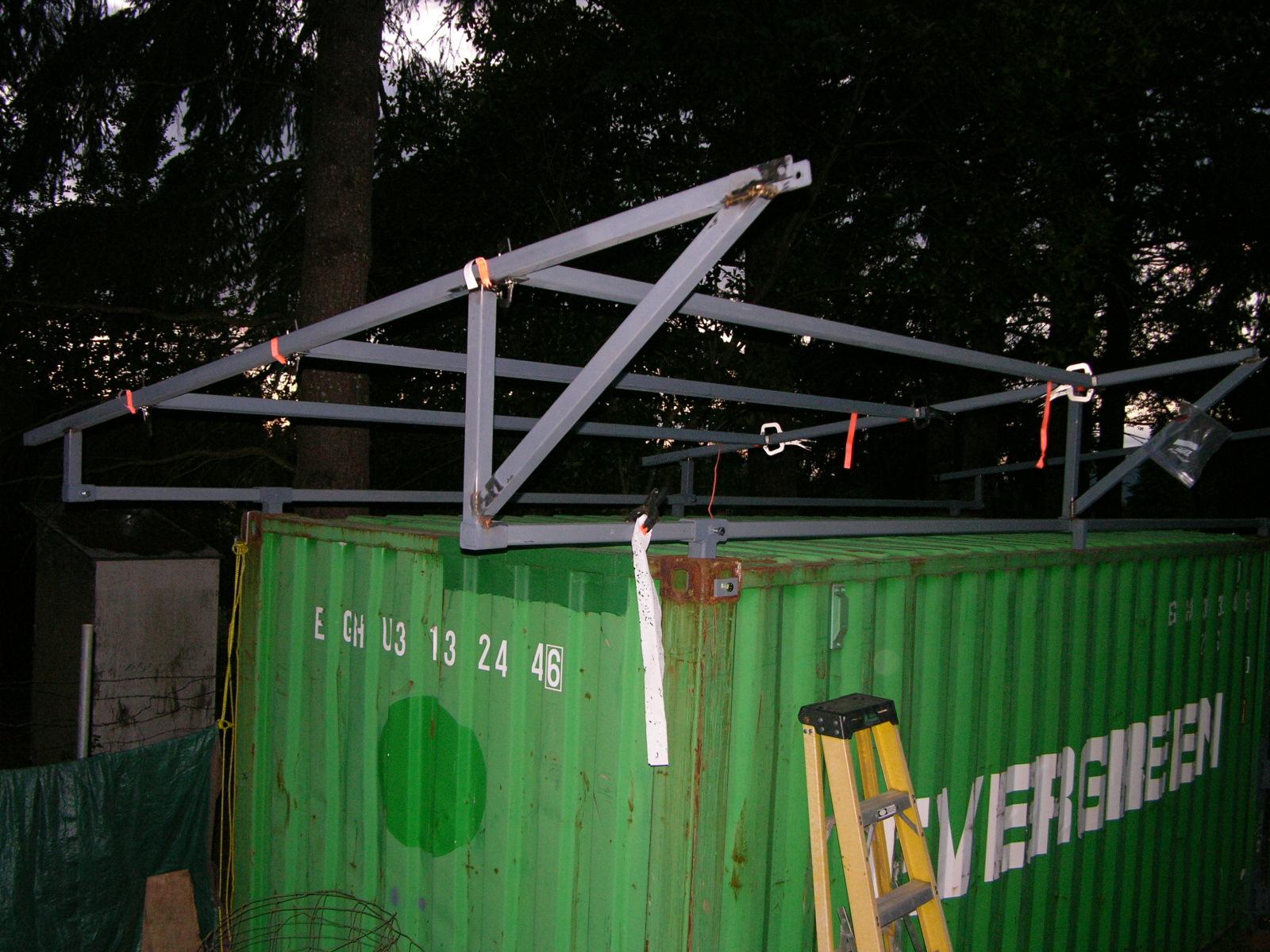

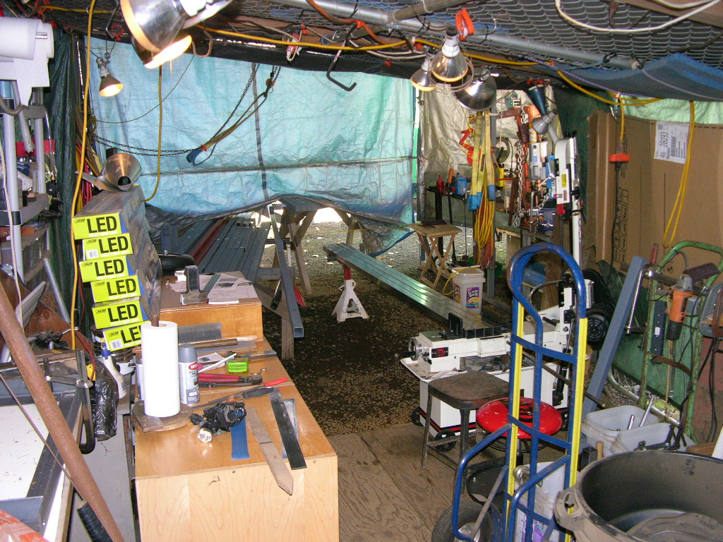

Here's a few shots of my "Hybrid" (part tarp, part steel, part fiberglass) metal/machinery work area, SORT of in chronological order -
Inside - DSCN1844.JPG - Outside(s) - DSCN2058.JPGDSCN2079.JPGDSCN2175.JPG - Roof over conex, + 14x24 work area, slab and (steel framed fiberglass) enclosure still to do - DSCN2206.JPGDSCN2235.JPGDSCN2306.JPGDSCN2308.JPGDSCN2805.JPG
Not shown are more tarps (til I get more time/energy, etc)... Steve
Oh, and yes those posts in the last pic WILL be vertical, lagged into the (not there yet) slab...

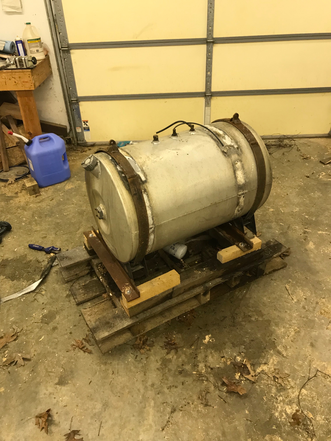

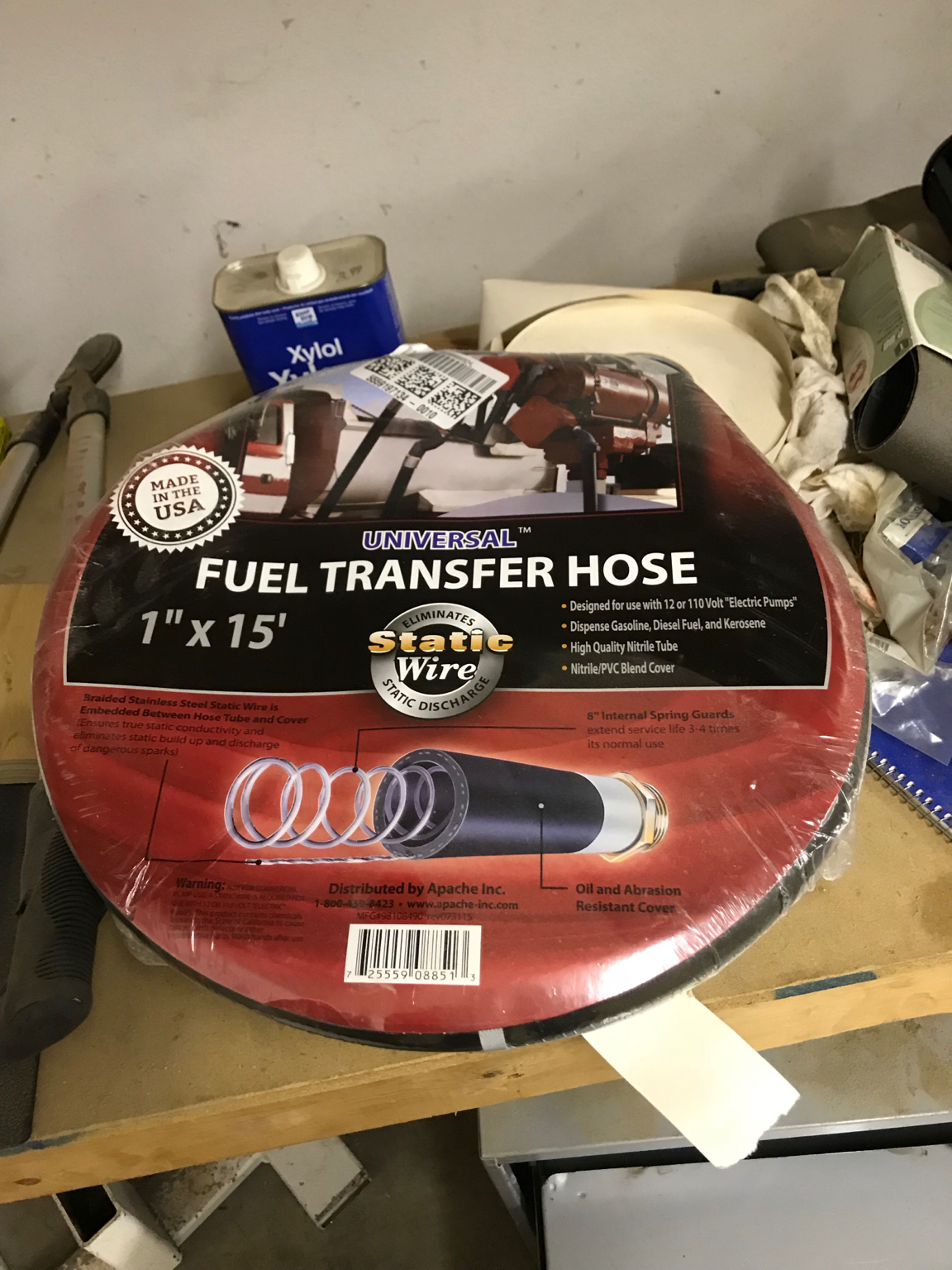

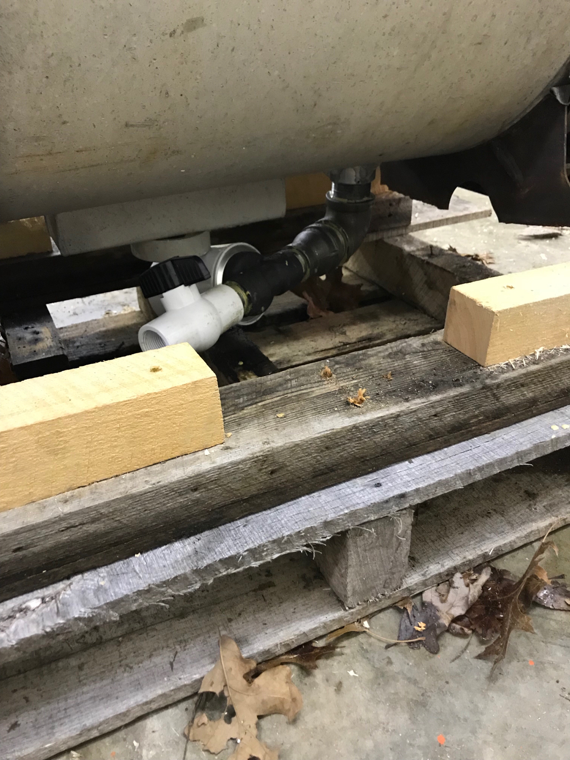

I worked on my fuel transfer tank. It’s a retired semi 50 gallon tank. It originally only had a 3/8 output. That wouldn’t be much flow. Now it’s got an 1-1/2” pipe thread. I’m hoping it’ll gravity flow through the filter, but I might have to take it out. IMG_0942.JPGIMG_0943.JPGIMG_0944.JPG

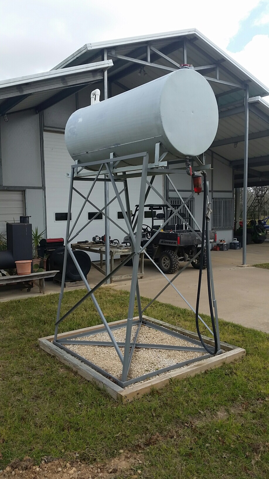

My 300 gallon bulk diesel tank is elevated 7’ above ground. My piping is all 3/4” thru ball valve then Golden Rod Filter to hose. Out flow is at least 5-6 gallons per minute all on gravity flow.

If it was in a permanent spot I could get it 7 feet off the ground. I was hoping I’d have decent flow into the CTL from the back of my truck which is about 2 feet drop. Plan b was to pick the tank up with the loader to get more elevation.

Perhaps a stack of pallets to raise your tank? 50 gallons of diesel weighs about 350 Ib. plus the weight of your tank, filter, hose, etc.
How high is the fuel filler on your CTL?
My stand was about 5’ High when I got it used, I added 2’ of height and enlarged its base for stability.

It’s about a foot lower than my truck tailgate. I’d planned on strapping the tank at the front of the bed and lifting it up some. ( dump truck ) The tank is about a foot high on its mount so I’d potentially have 4 feet elevation difference. If that doesn’t work I’d just lift the tank with the loader and it lifts about 12 feet high.

If you use much fuel at all, that will get old real quick.

It’s the best option I have short of buying a several hundred dollar pump. There’s a 2 foot elevation change from the bottom of the tank to the CTL fill lid. If the filter restricts flow too much I’ll take it out. When I don’t need fuel somewhere else I’ll set it in the barn loft and that’ll take care of the tractor and lawn mower. The backhoe I don’t currently own and the CTL will hold over half the tank so lifting it twice with the loader doesn’t seem like that big of a problem. I welded mounts for a clevis on the tank bands to make lifting with a chain pretty trouble free.

Get a Golden Rod filter and you won’t have flow restrictions.
goldenrod filters from Northern Tool + Equipment
You can get them on Amazon, at Northern Tool, Tractor Supply.
/ Todays shop time. #453
Oh I understand, at least you will have a good start on a transfer tank if you ever decide to go with a pump. I also agree with Rick go with golden rod filters.

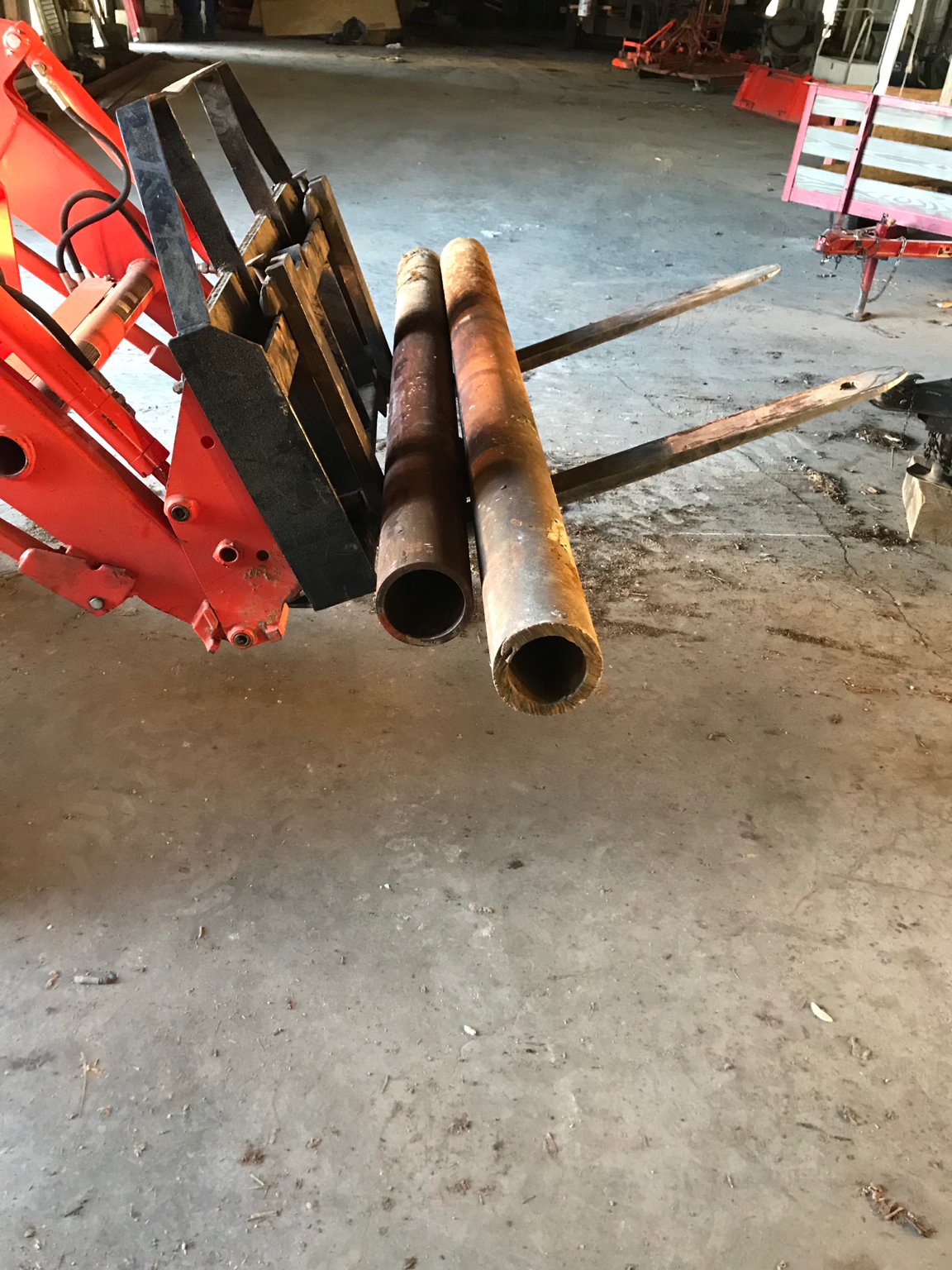

I scored 2 gate post. I’ve got 3 more but I’ll have to wait until I’ve got the CTL to get them out of the ground. IMG_0953.JPG

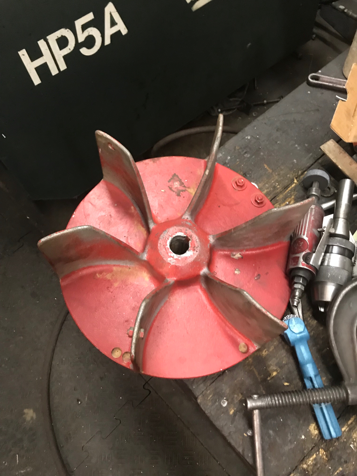

I made a bushing to put an impeller on a smaller shaft motor. This is a monster 3phase dust collector conversion into a less monster single phase dust collector. We’ll see how that works out. At least the price was right. IMG_0981.JPGIMG_0982.JPGIMG_0983.JPG
