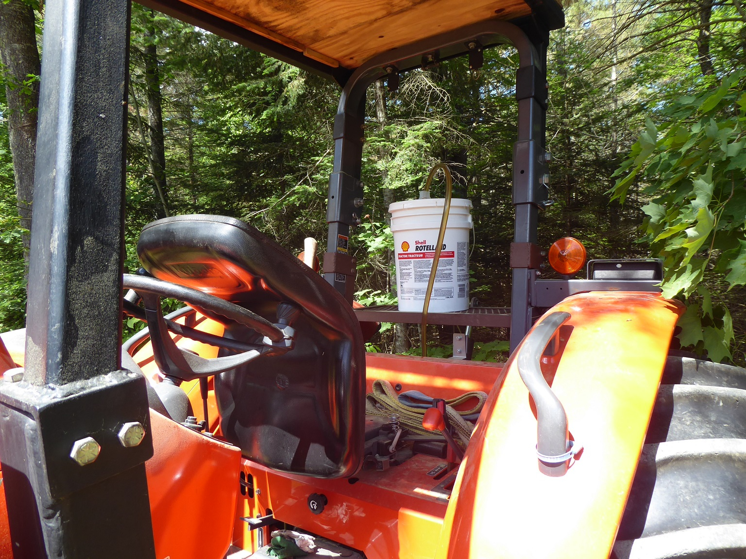

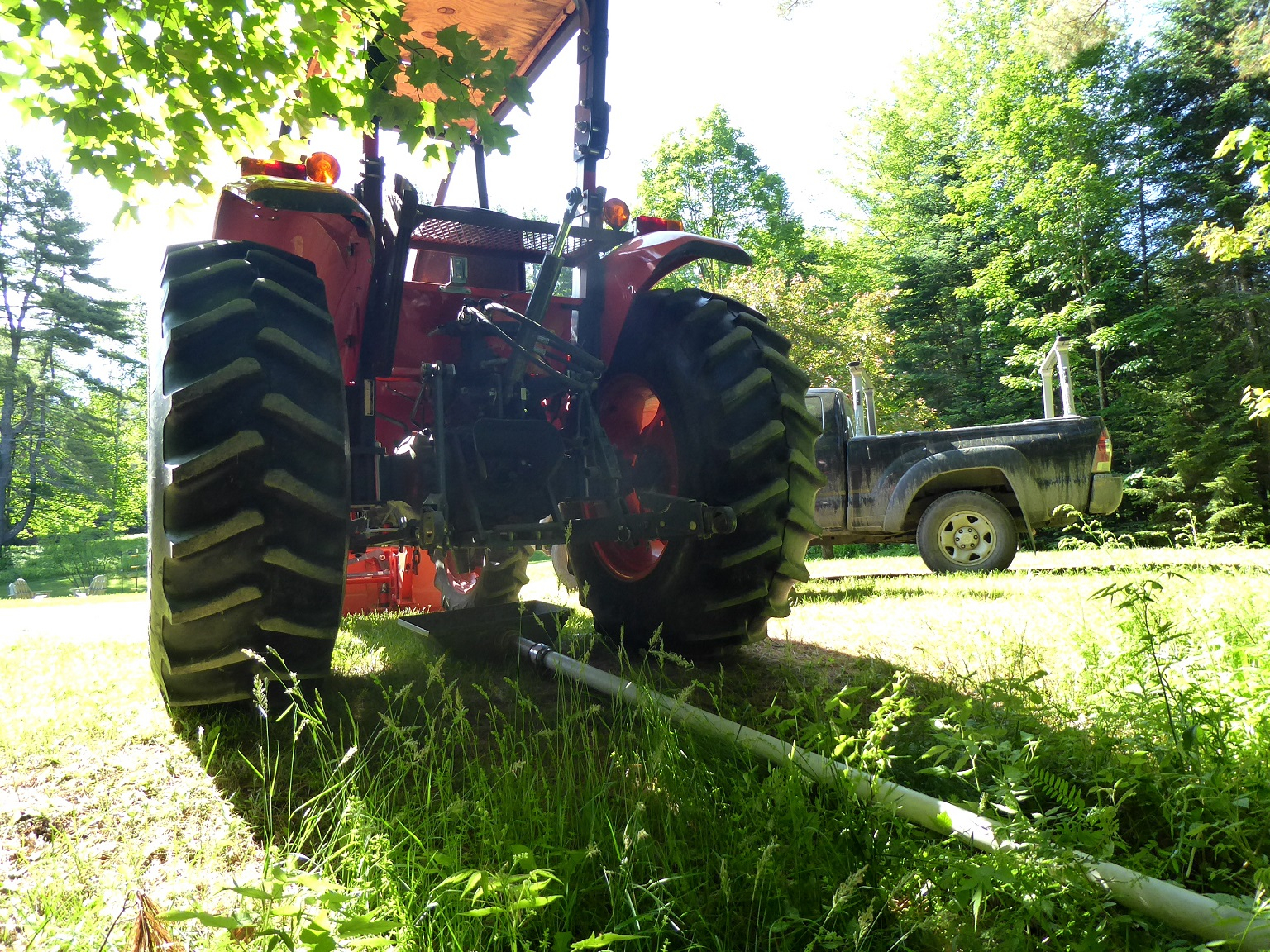

I did the 1200 hr maintenance on the M5640 which included transmission oil/filter and front axle oil changes. Iv'e put this on before, 600 operating hrs ago I guess, but this is how I handle 42 Quarts of transmission oil. Put 3 buckets down over the bank and run a pipe from the drain pan to them.
I use a rattle syphon to refill the new oil. It's a lot slower then fuel which goes pretty quick. The hydraulic oil takes a little over 20 minutes for 5 gallons but there is lots of other stuff to be doing while that happens. And, I don't spill any or have to mess with getting a funnel into an impossible place.
I have a geared transmission and I run run Rotella HD in it. I use SAE 80-90 gear oil in the front axle.
