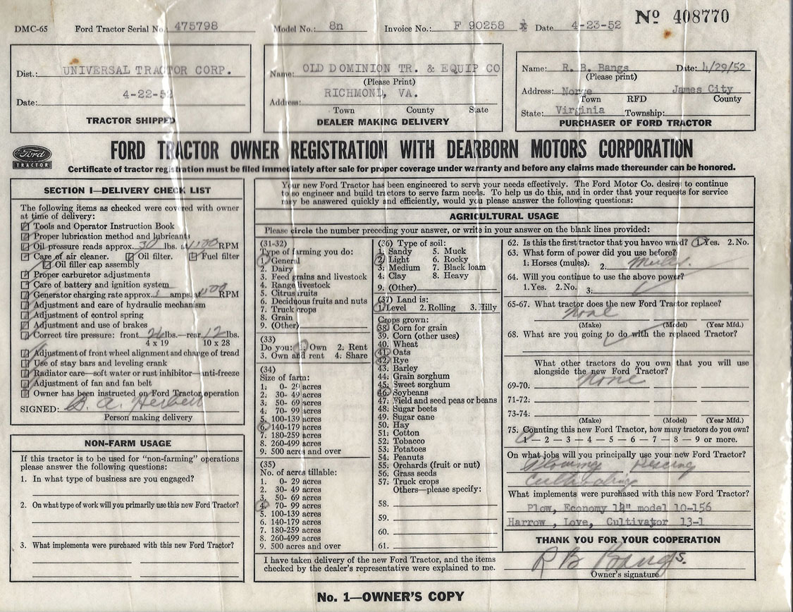

I have a 1952 8n I bought from a 95 year old man about 15 years ago. The man told me when I got it he had gotten tired of "little things" breaking so he recently took it to a tractor shop and had it completly "gone through" he told me the reason he was selling was "son I just cant get on and off of it anymore". I have about 4 acres of land that I currently bush hog. I was using my Pepa's old 5ft bush hog it broke, and I went off and bought a 6 foot hog, I just figured bigger was better. I also maintain the driveway with it using a 5 foot heavy duty box blade with rippers. Tractor is the orginal 6 volt system that can be kinda irritating at times, but my Pepa had a 528n and I wanted one. I wanted to get peoples thoughts on what I should do. Should I try to upgrade to a newer stronger tractor or run the old 8n with the 6 volt system. I would really appreciate everyones thoughts. Thanks in advance.
I also had an 8N (1952) and it also had a 6 volt (irritating) system. It's interesting because I bought my 8N from an older gentleman and I kept it for almost 20 years. I upgraded the 6v to a 12v system (pre-Amazon!) I believe I bought the kit from a place called Kennedy Tractors. I see now that Amazon has a complete upgrade kit for $177.....worth every penny! Eventually I upgraded to a New Holland TC29. The bucket and 4-Wheel drive were well worth the upgrade. I have now had my NH TC29 for 21 years.....never looked back!!! Good Luck!
