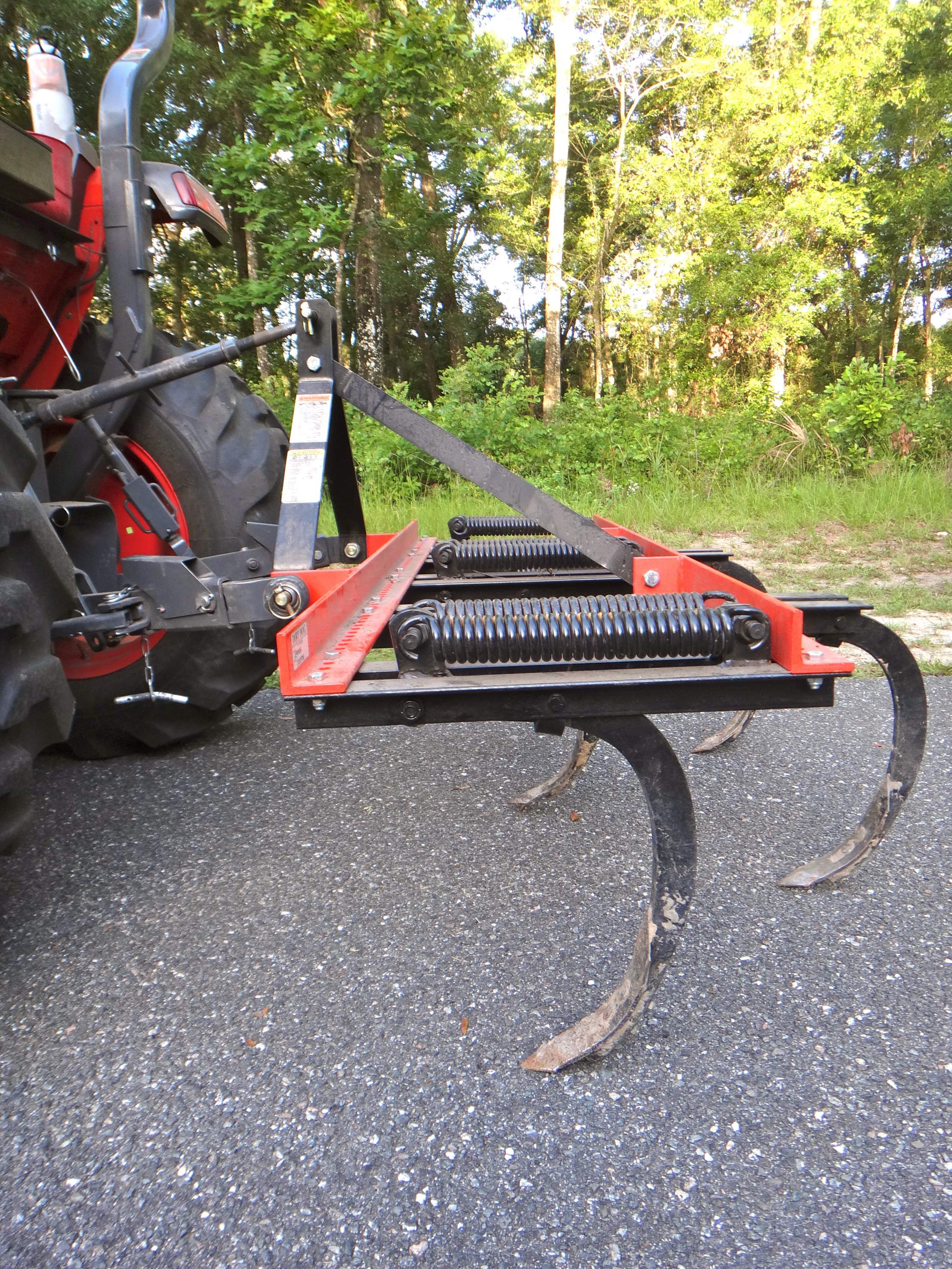

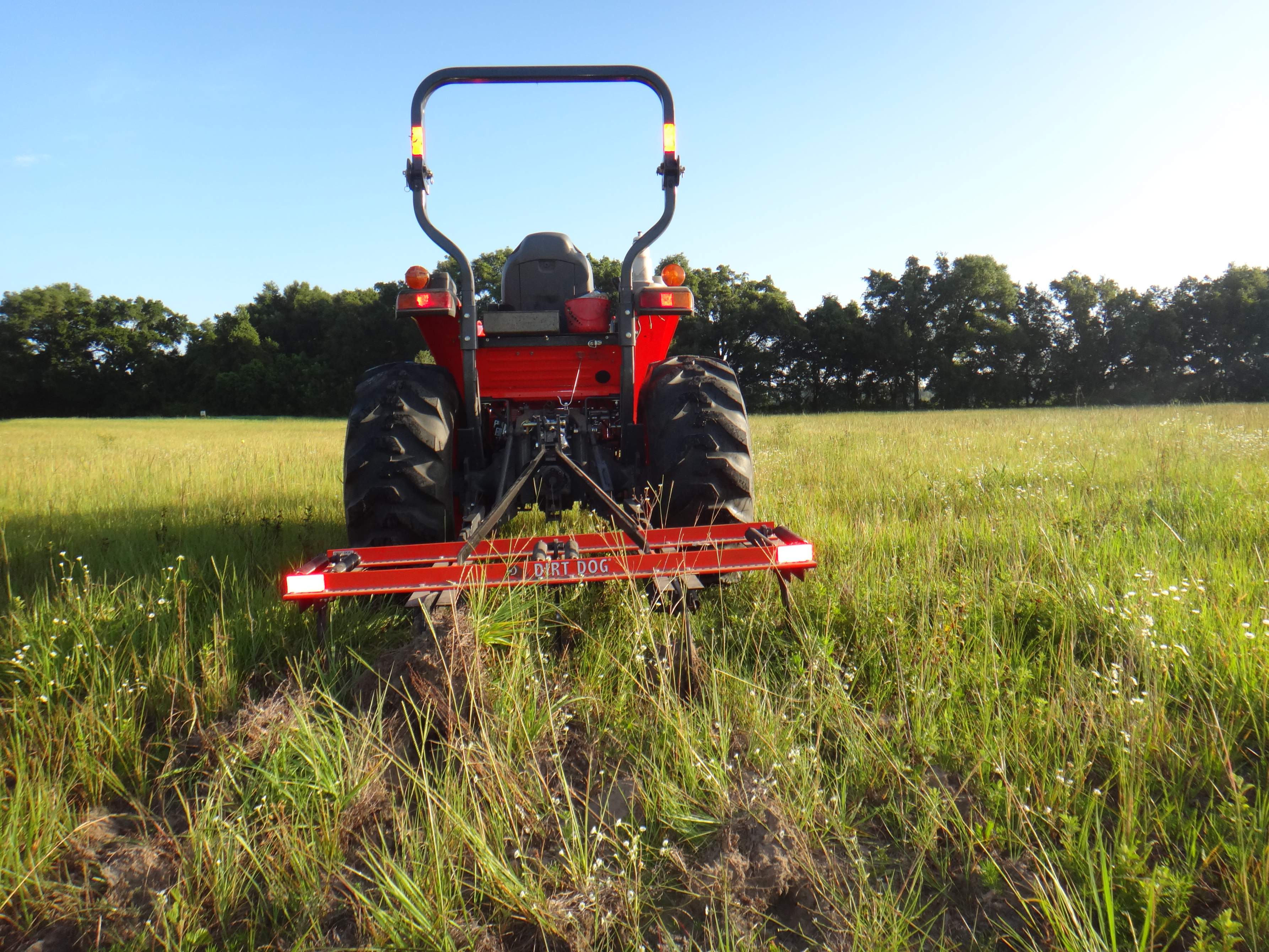

Further west, in the Great Plains, where wind erosion has to be seriously considered, Chisel plows are the norm, which are conservation plows. A light duty implement relative to a Chisel plow, for SECONDARY tillage, which performs the same function behind compact tractors, is the Field Cultivator.
Field Cultivators were among the first implements (mid-1930s) designed for the tractor Three Point Hitch.
