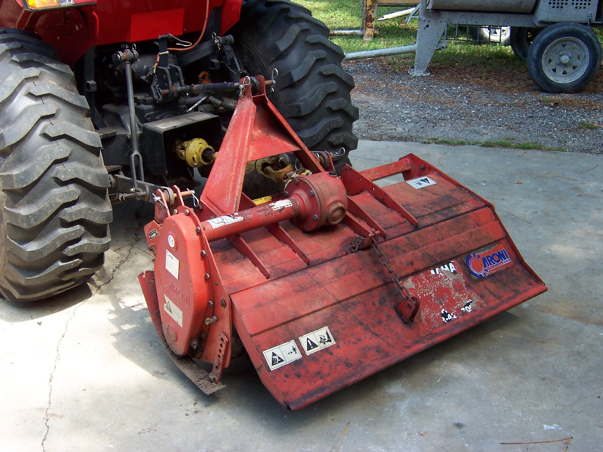

   / New Garden, First Attempt at Plowing #31
I snagged this 4' Tiller Saturday off of CL for $600. and it does a fantastic job! Worth every penny!
I can't believe how well it blends the soil, way better than a walk behind tiller.

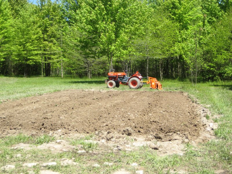

#33
Now that you have a tiller the plow is not required!:D
It looks like you are right, Egon! I went out and tilled it up 3 times and it was looking good! Tilling Video
Reluctantly, I'll be putting this Dearborn back together to sell on Craigslist. I'm not sure if I should put a new shin, share, and coulter disk on the other bottom, or just sell it like it is.
It's surely for the best, even at a single bottom this thing is still too big for my B7100! I still want to plow, so I will be keeping my eyes out for a smaller plow.
Thanks for all the help,
Jim
