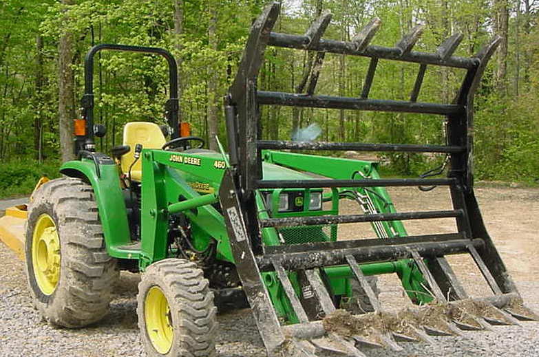

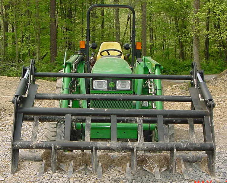

I went through the same decision making process as you before I settled on the WR Long root and brush grapple. The reason I went with this set up is that I have a lot of brush to deal with and when using a bucket with an add on grapple you will grab a lot of dirt with the bucket that you really don't want to have to deal with. With the RBG it rips the roots out of the soil and leaves most of the dirt in place.
The WR Long setup is heavy duty and they offer a hydraulic kit that consists of all hoses, quick disconnects, and an electric divertor valve that gives you a thumb swith mounted on your joystick to work the 3rd operation for the grapple.
I'll post some pics of my setup. It takes me less than 3 minutes to change from the loader bucket to the grapple. Of course I do have a QA bucket.
If you are dealing with a lot of brush on a regular basis this is a must have.

Another.
