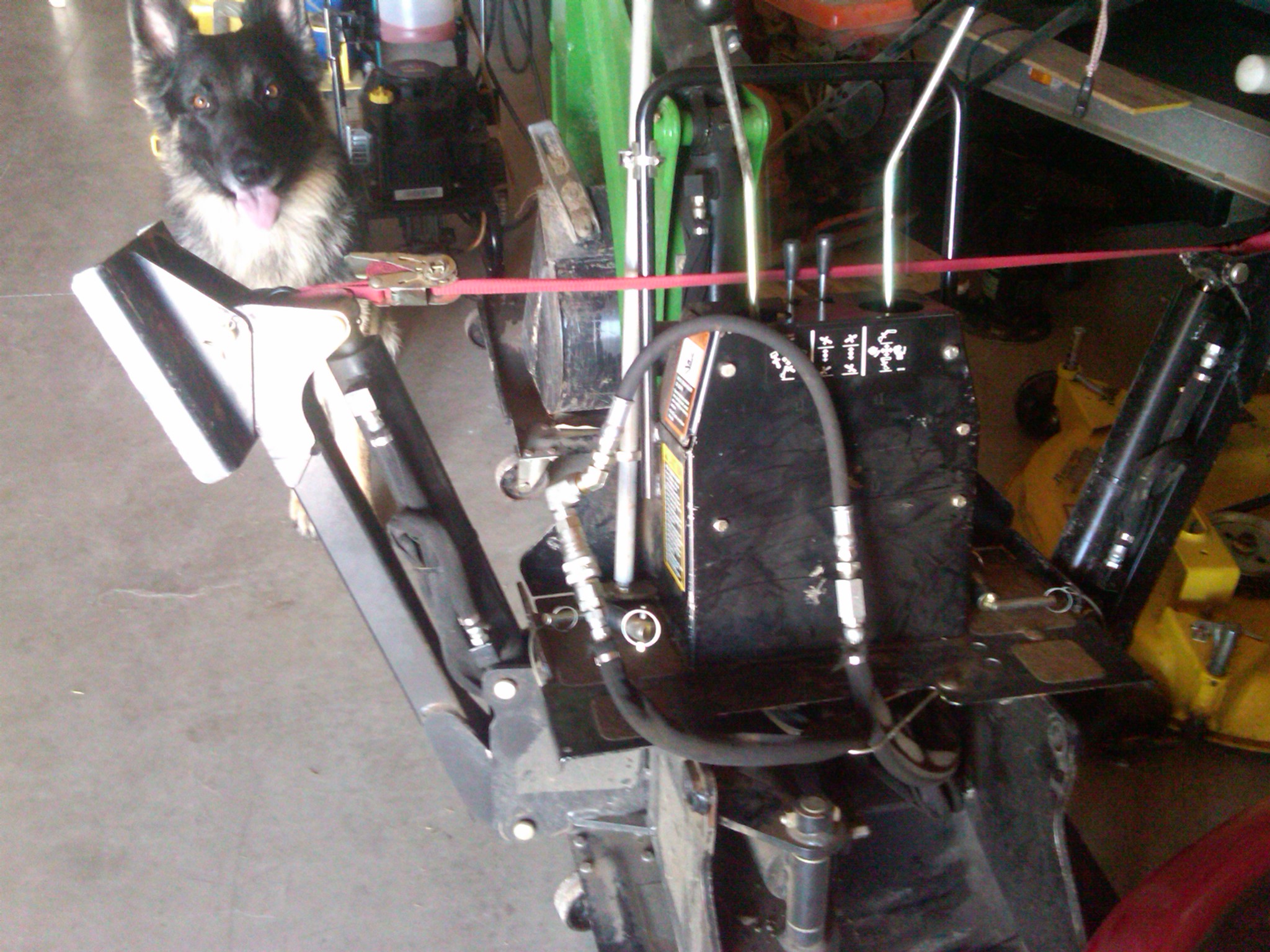

I have 2305 TLB + CCM TNT.
Very happy camper.
I made the following consessions with my install:
1. The 3PNT operation handle hits the valve body at full up stroke. This doesn't bother me because there is never an operation time where the handle is in that position constantly. It DOES NOT interfere with anything in the handle neutral position.
2. I use the rubber "mat" cover because this assembly gets HOT when mowing and under extended high RPM operation.
3. The BH connection moved to the valve from the power beyond factory location. I couldn't find a way to be happy with plumping not doing that.
4. My quick hitch had to be "modified" for the plumbing that exists on the cylinder itself.
5. My tractor had to be "modified" for the worst case travel range of the TNT and 3PNT.
CCM:
Great folks, quality stuff, quickly shipped, works as expected.
I used the PRNICE MB21BB5C1 valve.
Seemed pretty well sized to what little this tractor offers in HYD throughput.
This picture sort of shows things from a stand off view. The seat swivels fine (I do have the 2nd gen seat swivel) I am not crowded by the valve assembly (I am just under 6ft @ 165-170 lbs).
In this picture you can see the valve doesn't crowd the seat in any terrible way.

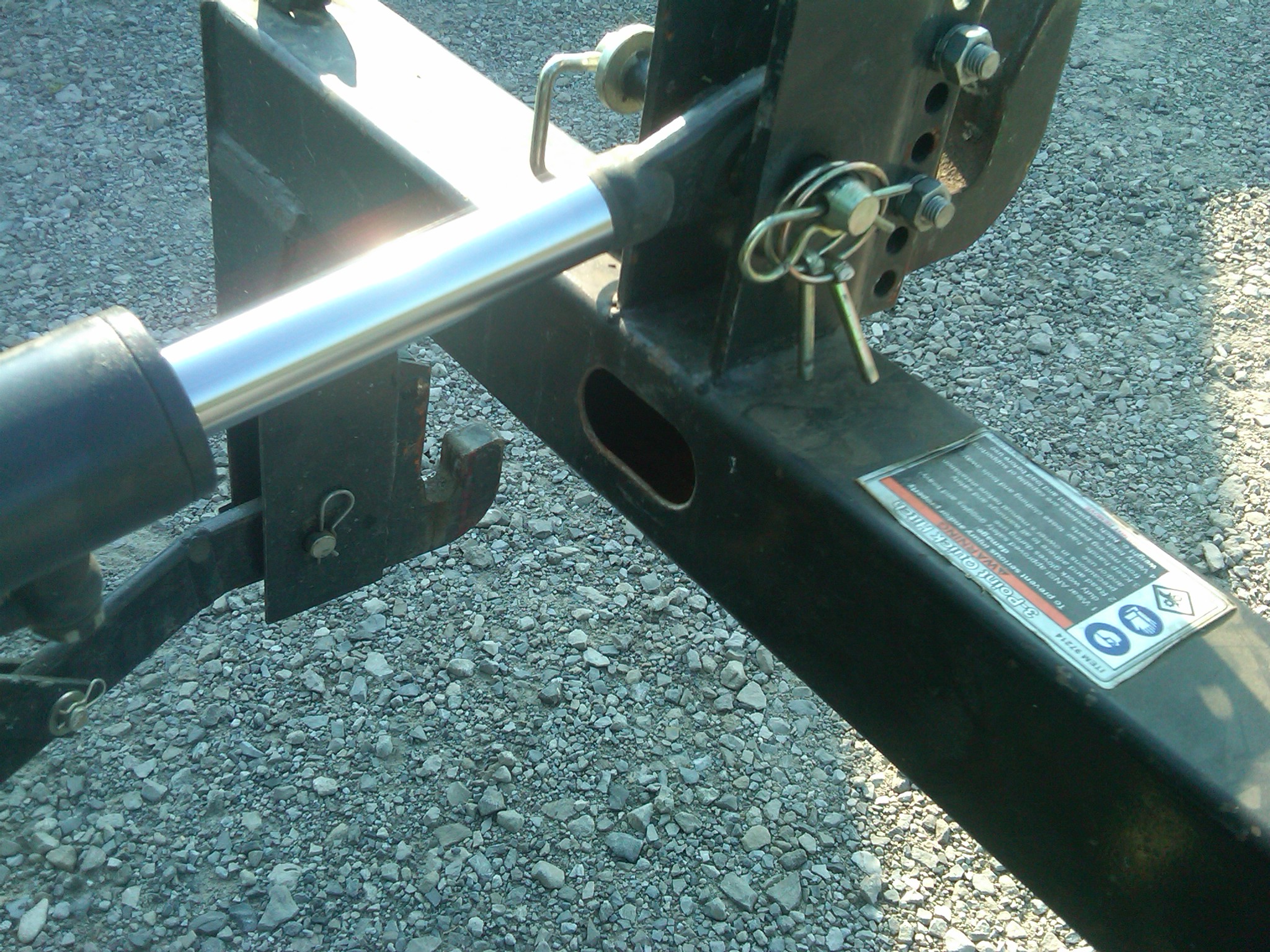

This picture shows the issue I had with regards to the full range of operation. The tractor fender "skirt" needed trimmed to account for the complete travel of the TNT. I clamped a board behind the skirt and used a hole saw piloted into the board in order to make the round cut and not "hack" the tractor up doing it. It is also worth noting the hose routing in this view. I tried several things and this seems to have worked the best long term. Cylinder MUST be upside down or you will crash the pilot check valve stuff into the fender skirt. As it stands I "bend" the fender skirt just a bit at worst case travel for the 3PNT and TNT.
This picture shows the plumbing from a different direction. From this picture and the last you should be able to tell how I mapped things in with the power beyond. Note my backhoe connection is now the BIG connector on the valve assembly. That "loop" unplugs and the backhoe goes in-line. I flipped the couplers around on the BH to get a MALE connector on the top of the valve. I didn't want a female connector peeing on my tractor with every connect - disconnect operation. I retained the quick connect stuff for the factory power beyond, it's just swapped around a bit to get the plumbing I wanted.
Here we see the coupler arrangement I use on the BH. I have extended one hose as required to reach the top of the valve. You can see this and the directional nature of the quick couplers in the picture. The direction of the couplers is so the hoses are not up by butt when I operate the BH.
This picture shows where and how I cut my quick hitch to deal with the plumbing on the cylinder for the travel range.
This is probably the best picture I can give (without removal) of the bracket I fabricated for the valve.
Note the loop you see here in this picture is playing the part of the factory power beyond loop when the BH is not installed.
I think that about covers it. I opted for the 2X valve so I can drive some loader side stuff (thinking grapple or "other") and / or drive something HYD AND use the TNT.

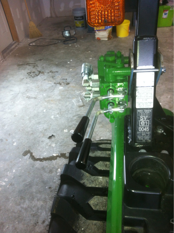

I added top n tilt to my 2520 last winter. Since you have the power beyond, which I didn't have, half the work is done for you. I attached a couple photos of where I attached my valve. I believe it is a prince 2 spool open center SV series valve. You can see in the pics how I bent the control handles. I really like the location as it doesn't interfere with the cupholder or the 3pt control. You would just need to plumb the valve into your power beyond quick connects as you would your backhoe! When ordering the cylinders try and get them with side fittings for the top link, as mine with the top fittings had some clearance issues. I ordered the top n tilt cylinder kit from mtnviewranch. Just search him on here. Money well spent!
Sent from my iPhone using TractorByNet

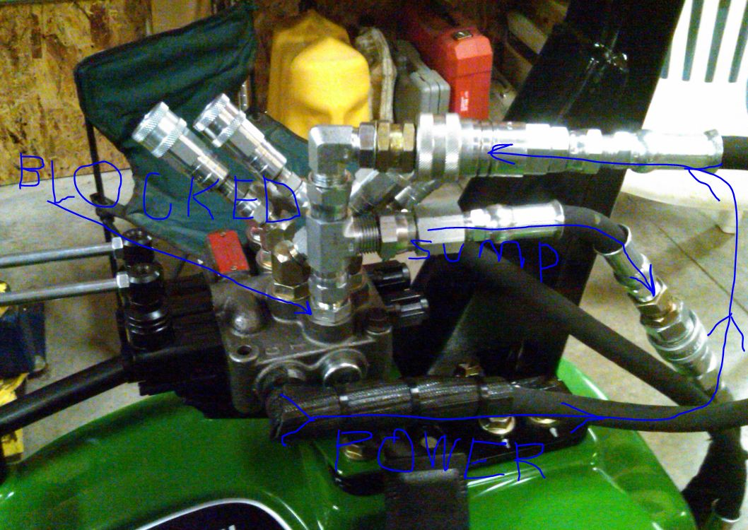

Parts and information list:
INFORMATION:
1. What I have going on here is a bit "off campus". Someone may not understand the plumbing, in the absence of HYD experience. Allow me to explain.
Lets go over the plumbing.
For explanation I will refer to pressure and flow as power?
1. I used a valve that can be configured for OPEN or CLOSED center. This means either the power flows thru the valve or stops at the valve (more or less). Because we want to operate the BH AND the VALVE a switchable valve turns out to be important.
2. In the configuration I use the valve is CLOSED CENTER! Now, before everyone freeks because the tractor needs OPEN center, we must think about what is going on here. Again, we want the VALVE AND the BH at the same time. This makes things a bit different than if we were just adding a valve without the BH.
3. The valve in question has the option (WHEN IN CLOSED OPERATION) to pass the power thru the valve and continue it on. That is EXACTLY what we are looking for in order to have the BH AND the valve at the same time option.
4. We CLOSE the valve (install the set screw inside to block off) in order to turn on this pass thru of the power?
5. In one of my previous pictures you can see the valve with a fitting connected to a port marked P. This is the power coming from the tractor side. Now, normally when the BH is not involved this power just flows thru the valve in a straight forward way. We need that power to be in the valve AND continue on to the BH. Regardless, make note the power is incoming from the tractor to the P port on the valve.
6. Because we have configured the valve CLOSED the port used to return the power to the tractor no longer works. This is sort of a problem, we have all this power from the tractor and it needs someplace to go. The outlet port on the valve no longer works.
7. Because we have a CLOSED valve, the extra power port is now enabled. This means that the power is now not going to the return port, it is going to the extra power outlet. This is the LOOP you see in the pictures. The side of the loop NOT having the quick disconnect is the side the power is coming from.
8. Now given #7 we can possibly begin to see what is going on here. We see that I have a T fitting connected to the standard return port on the valve. However, I have previously stated this port is dead by configuring the valve to be CLOSED.
9. When we think about #8 we go WTF? The valve is closed why on earth did this ****** Sean plug fluid into it? Well, because I need something to hold things in place :) The default outlet port is being used to connect / hold other lines and fittings in place BUT IT IS NOT OPERATIONAL! Again, the VALVE IS CLOSED! Remember I said the power is now in the loop you see headed for the large quick disconnect that sits on top of the valve. This is due in part to the restrictions on space that exist with the swivel seat. We cant have a bunch of stuff extending out of the valve in the direction of the seat.
10. Now when we continue to look at the T connection we see the last outlet on the T we have NOT already discussed is directed back to the tractor (this is the power return).
11. The loop is now emulating the factory power beyond loop with nothing connected to it. This power needs a place to go when in operation (open center systems). This is why it plugs back into the T that is returning fluid to the tractor sump.
12. Now when the BH is required the loop is disconnected and the BH is connected to the fitting at the top of the T and the female quick disconnect shown on top of the valve in the pictures. Thus, when the BH is connected power flows thru the system just as if the valve was not there. HOWEVER, because the valve is inline it can use the power to do work at the same time the BH is in operation. Disconnecting the valve is not required. When the BH is not attached, the loop is simply connected to the top of the valve (drain / return) and we have an operational valve and no BH.
Again, the BIG thing/s to note here are:
1. THE VALVE IS IN CLOSED OPERATION!
2. THE VALVE RETURN PORT IS BLOCKED! This is why the T is REQUIRED! The T becomes the path for the power to return to the tractor.
3. The T is installed for the purpose of holding the return line to the valve and providing a place to put a quick connect for the BH return. There is no power flowing out the bottom connection of the T that is attached to the valve.
This picture helps illustrate the concept:
I can fill in more information about the setup as required. I do assure you it has been working just fine for over a year now.

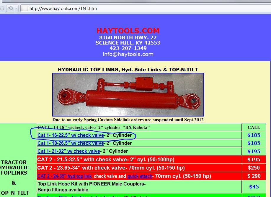

I used the CCM cylinder shown in the attached picture (web link in pic too).
From what I learned it would seem a round cylinder would work better in the tight space of this tractor. I suspect there are other vendors that could provide such a cylinder.
Don't hesitate to shout out any questions. I didn't have a template when I did mine, if you can get some value from my setup even if it doesn't work "exactly" how you would need that is good by me.
