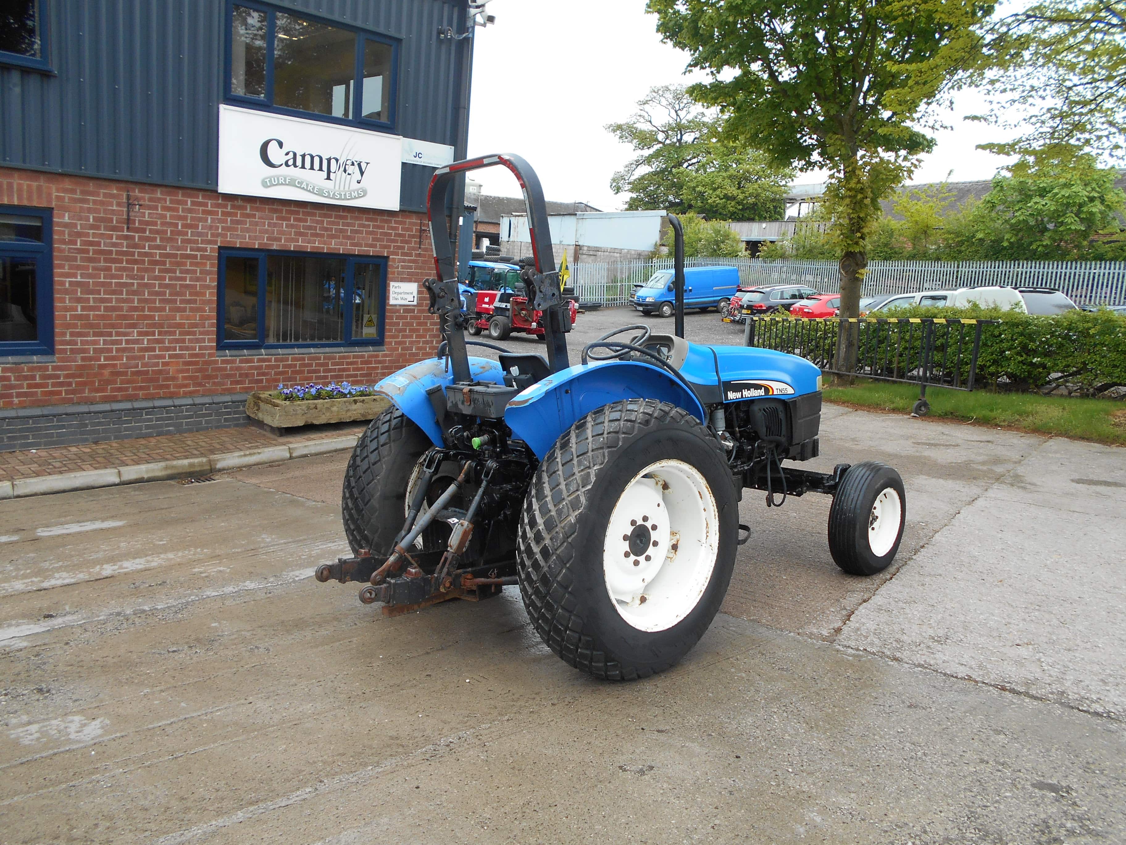

I have just bought a New Holland TN55S, with no prior knowledge of tractors, and no manual.
I am fine with the three point hitch, but I cannot figure out how to lower the towing hook so I can tow a trailer.
Can anyone out there help?
Thanks in advance.
Mike

I'm a little bit puzzled to be honest. Is there not a drawbar on it? You may need to acquire a pin for it.
   / TN55 - no manual! #4
I thought so. If you have a look here you can see the drawbar between the lower links. That's what you need.
   / TN55 - no manual! #6
I managed to find it this morning. This is what you should have.
Messicks, I believe applies to Americaland (though no reason not to use it for clues) whereas what I've linked to applies to Englandland. Probably worth your while, Mike, to register there.
EDIT: Hmmm, that link doesn't appear to be working. Let's try this
EDIT 2: Not having much luck with my links. Looks like you'll have to start here.

Here's a link to a photo of the hook that I cannot work out how to lower or extend:
https://www.flickr.com/photos/16629153@N05/21563501484/in/dateposted-family/
Any ideas very welcome!
Thanks
Mike
   / TN55 - no manual!
I have worked out how to do it - a combination of the float control and a valve lever- so now I can buy myself a trailer!

Mike,
I don't know the purpose of the solid horizontal piece below the PTO shaft.
My TN55 (standard model) doesn't have that piece. I'm no expert, but I don't recall seeing anything like it on other tractors.
I can't tell from the photo -- is it bolted in place?
Steve
   / TN55 - no manual! #10
I'm probably less of an expert than smstony but, to me, that setup looks very strange.
