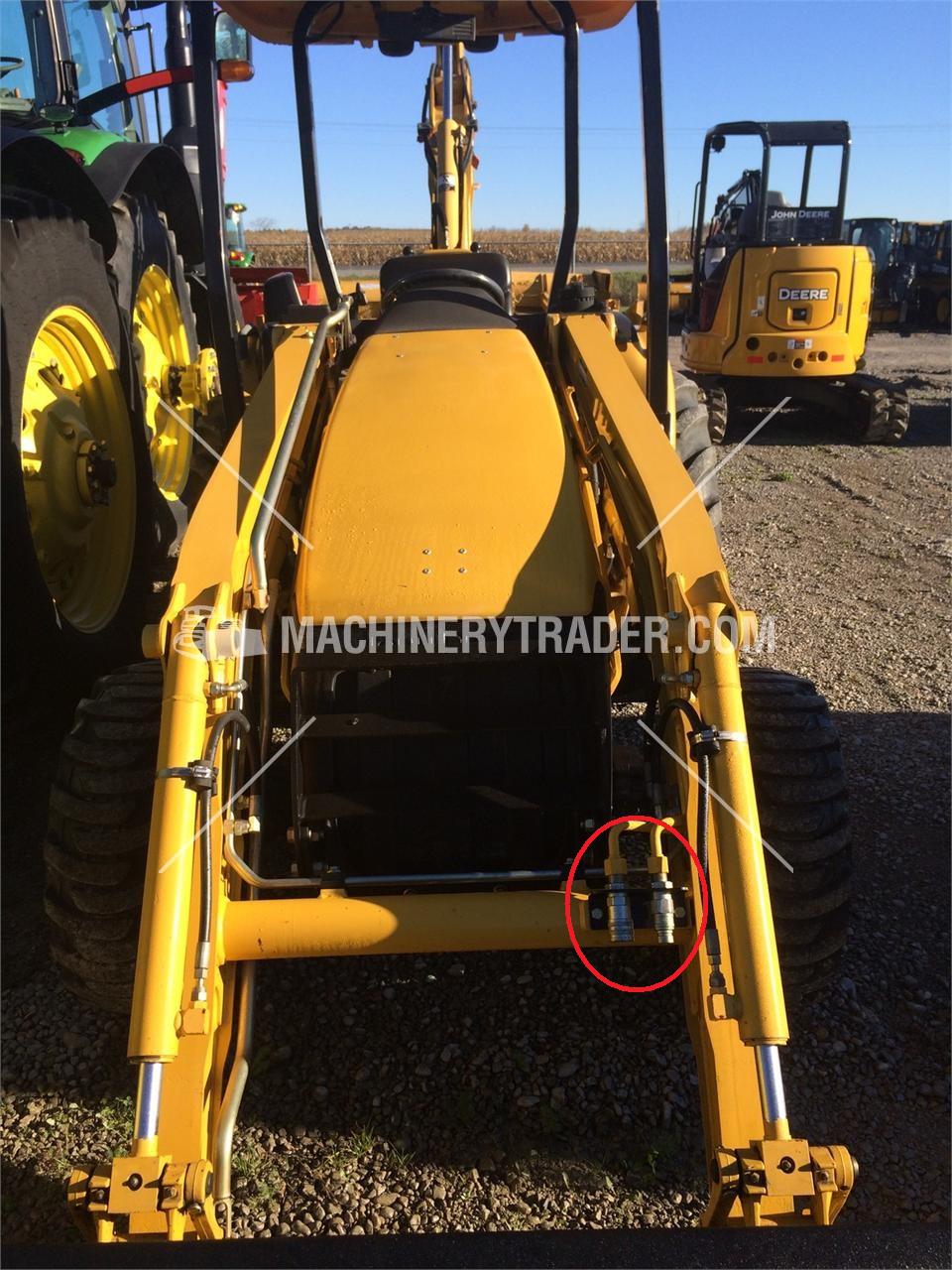

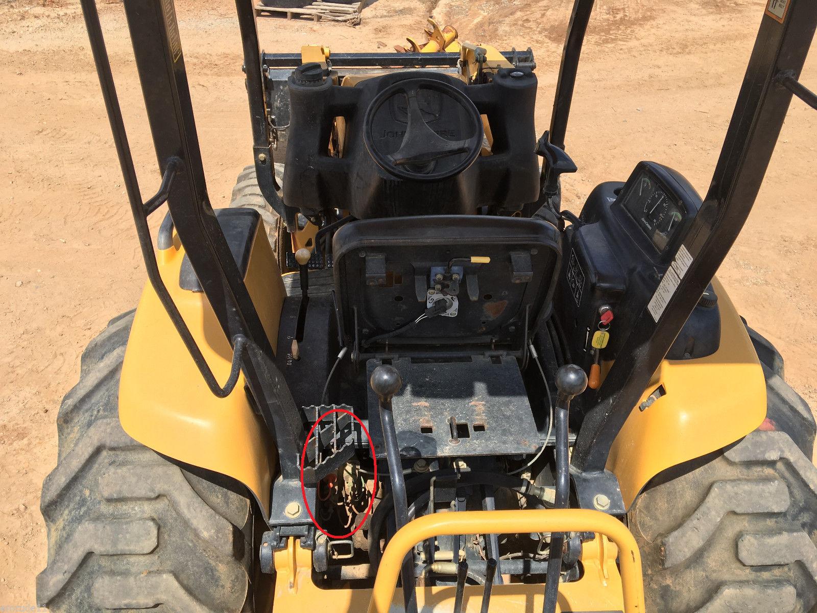

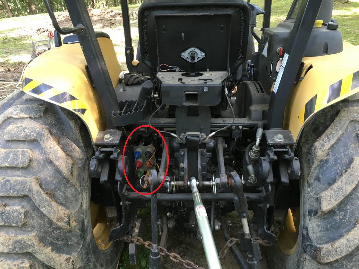

It took me two years to find the a 110 with all the options that I wanted. Here's a few photos that will help you in your search.
front hydraulics
Rear hydraulics

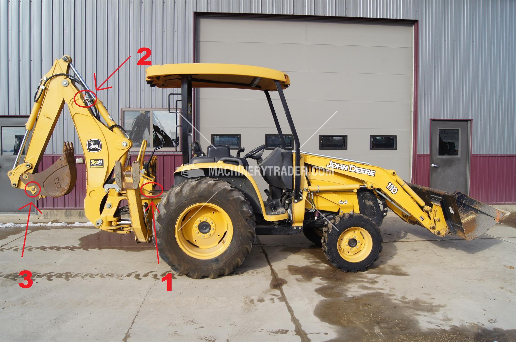

/ TLB 110 #6
1 Foot pedal to control the thumb
2 Hydraulic Hook up for the thumb
3 Quick connect bucket

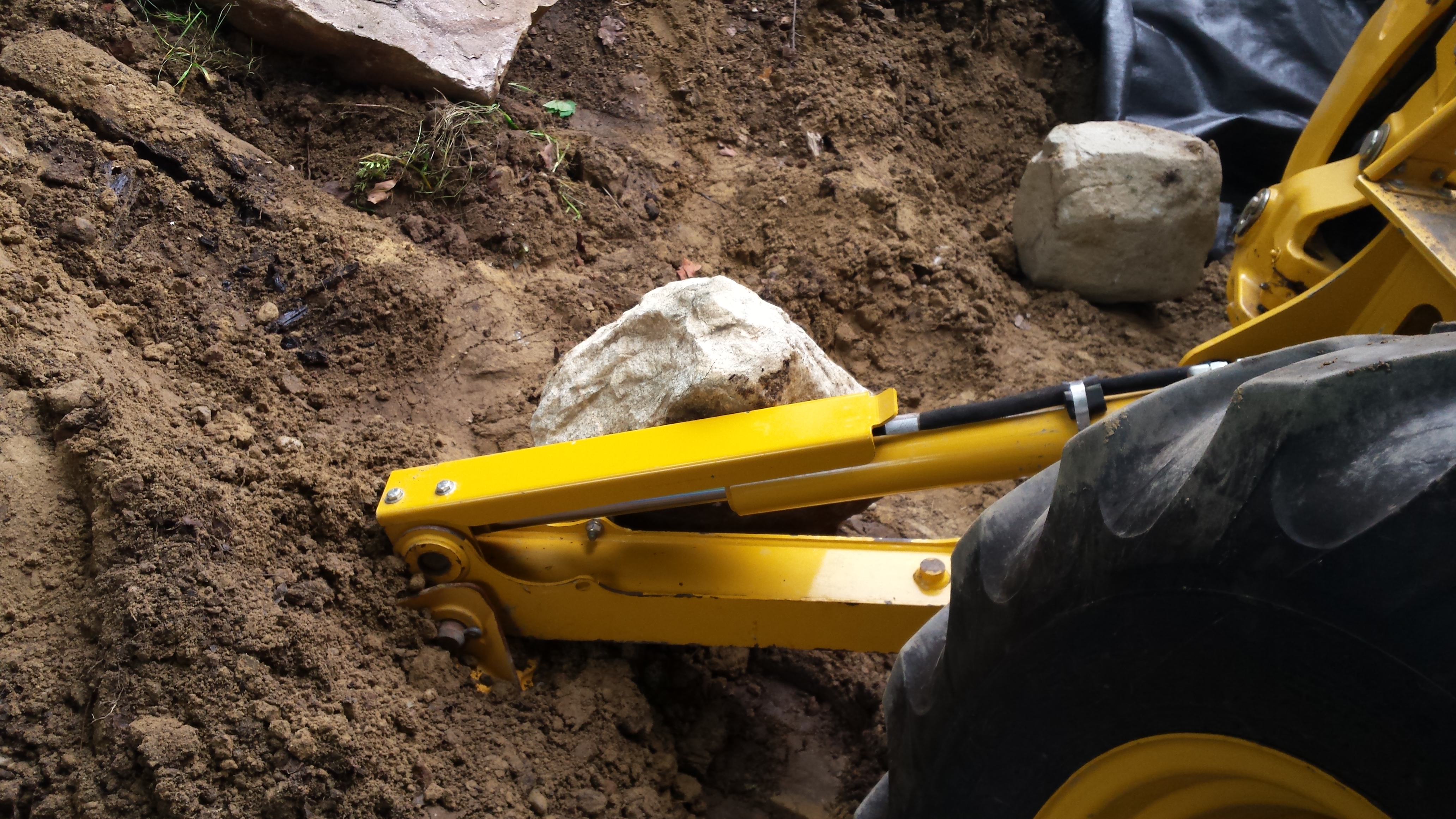

Installed the stabilizer cylinder guards a year after I bought the tractor, I'm glad I did. Dropped a rock on one of my
cylinder guards!!!!

/ TLB 110 #12
I need to order the guards for mine as I'm about to rebuild both stabilizer cylinders from seal damaged caused by niks and scratches.
Matt
/ TLB 110 #13
Cost of the stabilizer cylinder guards was $132. and the Skid Plate was $490. plus $190. shipping
GR Manufacturing would not take orders from the customer, I had to go thru a JD dealer
