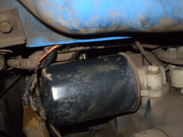

I am one of those poor souls that bought an iseki tl3200. I can find nothing for it.Anywhere. I need a hydraulic filter canister and filter. It was so tight I put a hole in it loosening it.ANY filter numbers for it would be so great. Bill
   / TL 3200 #5
Can you post a pic of the tractor & the area the filter is located ? Some of these models are very different #,s but very similiar tractors from what I,ve been seeing latelly .
If Your filter is located obove the left rear axle like in this pic , it may be like mine & use a this which is a hastings # HA HF 993 . Hope that helps . ;)
BTW , if new members would start a new thread other then posting in a very old unrelated thread they might receive more replys . ;) Best of luck .
