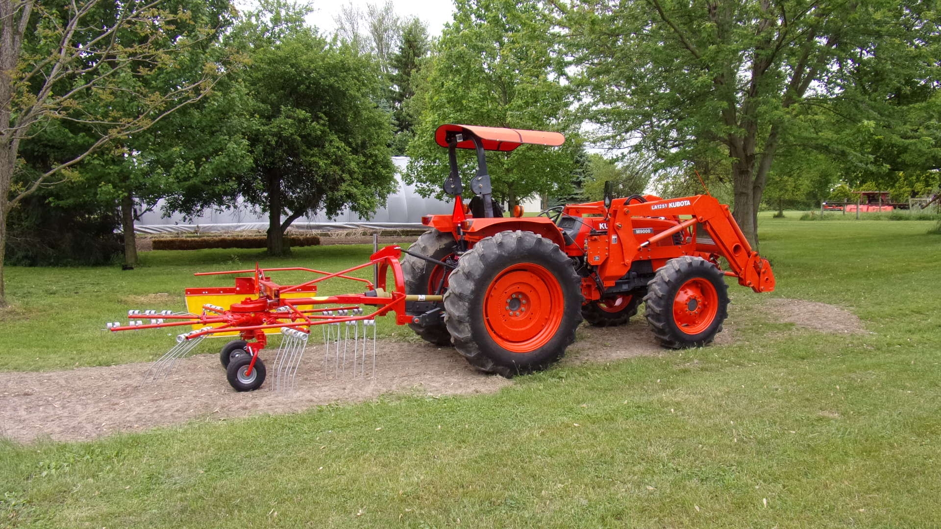

Sure does. I could install an I-Match SSQA adapter on either of my M9000's and they are classified as farm utility tractors last time I checked at least. Both in the excess of 92 stub horsepower and not a compact by any means.
I can install an I-Match SSQA on either and limit myself to only I-Match attachments or I can (and have) installed a normal SSQA two pin quick attach and mount anything SSQA. Why most SSQA attachment's have the extra slots stamped in the mount plate... so you can mount anything including I-Match attachments.
Sure looks like a farm utility tractor to me... How about you???

Your pictures are all showing rear mount equipment that looks to me like a farm application for hay.
