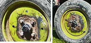

Sort of relevant:
I don't know what the previous owner did to break these front wheels but he made a mess of them. And one is a replacement obviously salvaged off another Yanmar. It still shows "$25.00" written on it.
I was told this tractor was used for mucking out riding stable stalls for its first 10-15 years. Maybe the owner kept sliding into curbs or something.
I've had the steering wheel wrenched out of my hands a few times which I thought might at least bend these patched wheels, if not crack them again.
I bought a pair of replacement wheels so I'm ready if one of these cracks. But so far, six years, I haven't needed to use them.
