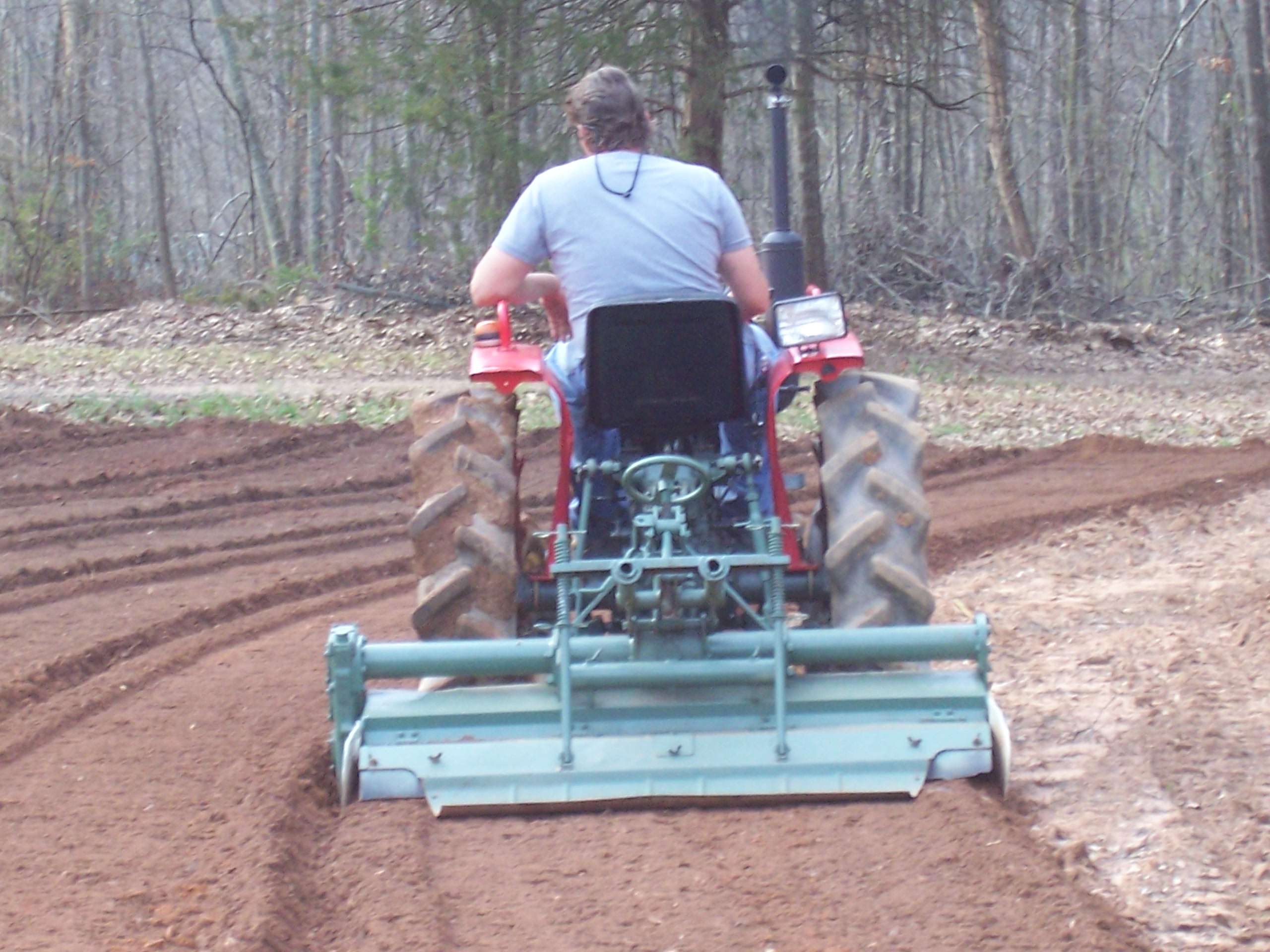

Here is a pic. with a YM2000 and a RS1400 tiller with the tires reversed.I will note that the valves are not as easily accessible.

CArey that is the pic i wanted , i can see enough diff from mine that im sure i want to do it now.

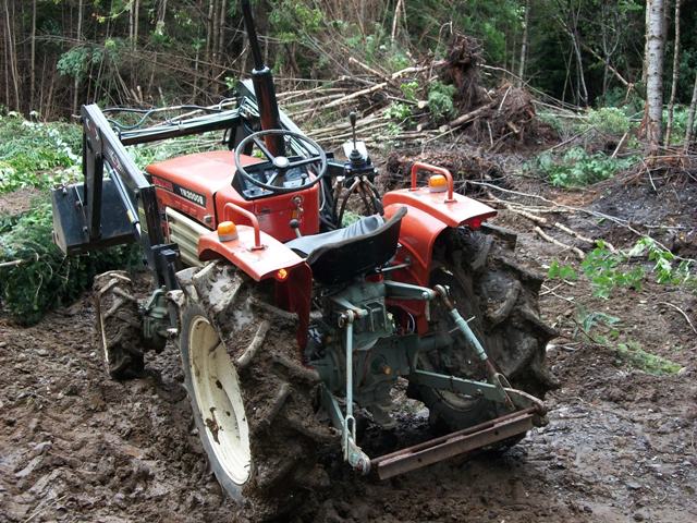

Finially swapped them thismourning. I figuried that i would post some pics so that anyone searching this thread can see the before and after in the same perspective on the same tractor.
After fooling at forestry forum adding my pics there (just rememberd that i could put them on this site) to post here. Would be a lot easier if i could just add them from my computer.
-Nate
displayimage.php
displayimage.php
And me bushhogging?
displayimage.php

very noticeable, wouldn't it by nice if the rear fenders would move over as well, some of us could use all thr room we can get:D
Oh! have you reverse the front wheels?;)
/ tires in wide stance #16
I've read, and agree, it's not a good idea to reverse the front wheels.
In stock configuration the load is centered between the inner and outer wheel bearings. Reversed, the load is concentrated at the tip of the spindle. Yanmars (and other tractors) occasionally snap off spindles and drop the front corner of the tractor to the ground. On a bad side slope is where the spindle bears the greatest load, and that would be a poor place to break one.

yes this was a bit of my concern when I installed the extra weight of a FEL
however while no extra weight on the front of the tractor I didn't relize would be that much of a concern, and while now with the FEL on my tractor i can feel the handleing difference when moving the wheels back to stock, it does not feel good when cornering, the wider stance seems to ballance the FEL better, though I do realize I am asking for problems if left this way, I am on the search for some larger wheels that will have center offset/backset,
approx 5 1/2-6" wide x 13"-14" wheel, the kicker on finding these wheels are the wide 5"x 4 bolt pattern, and also the large 3"center hub hole, I may simply have to custom build some wheels using the center plates of these old 12" wheels,.. here is the stance of the front wheels being reversed, Thereare approx. 4 inch wider span, some tractors have wheel weights and cannot reverse the wheels,
