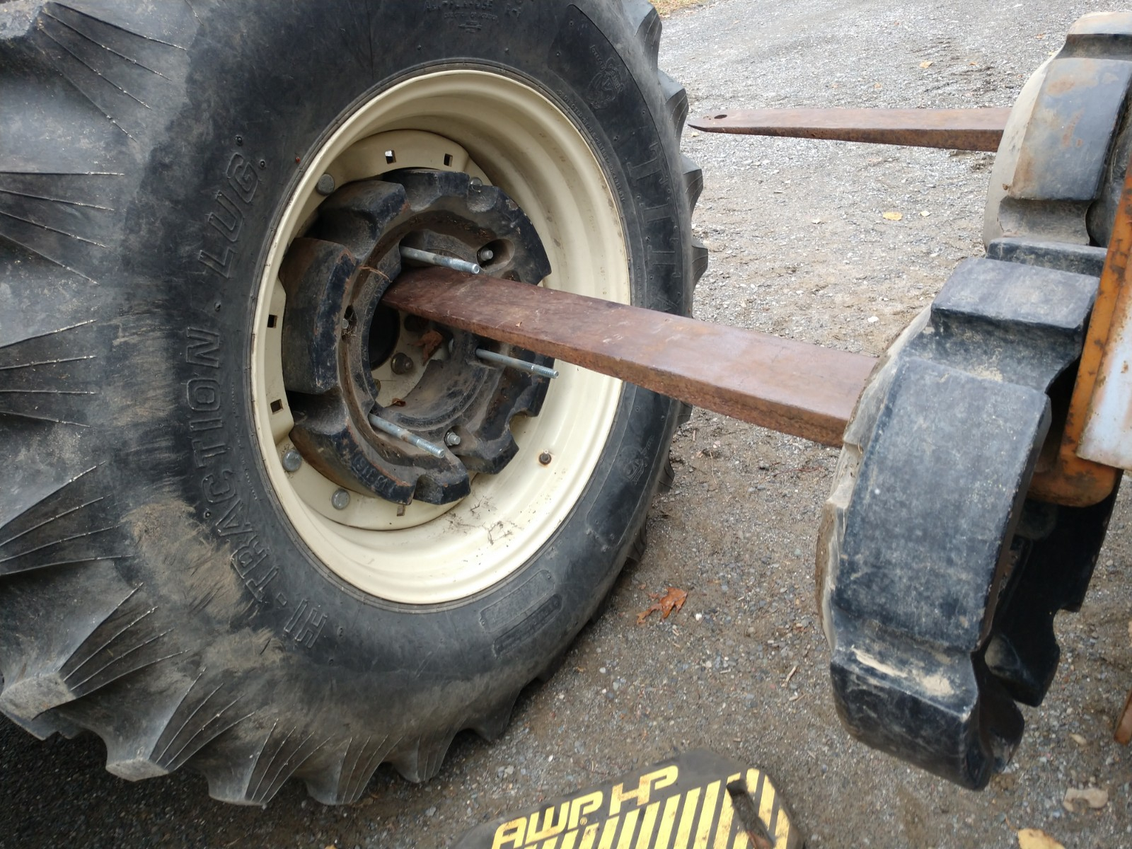

Yes, it costs a bit more initially but I'll stick to my cast iron.
When I got the weights for my Branson the were about a buck a pound, it's around $1.50 per pound.
these are 300# each, but not bad to work with
