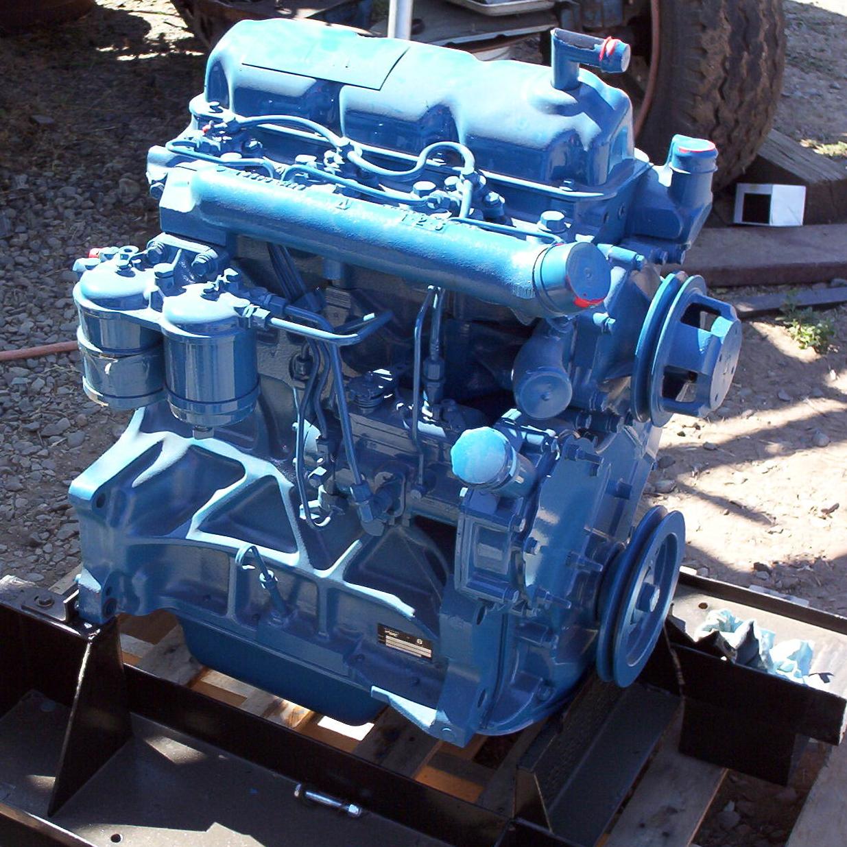

4630 engine- pic of the 'new' re-man engine

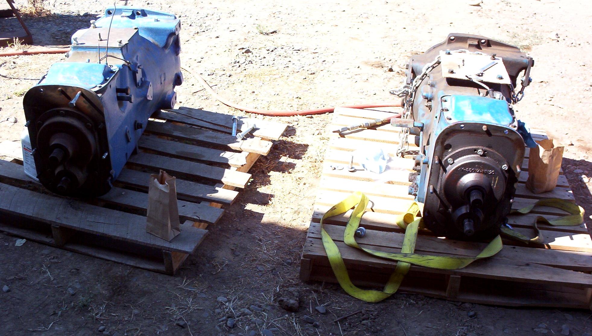

tranny- one on the left is the 'new' one, on right is old

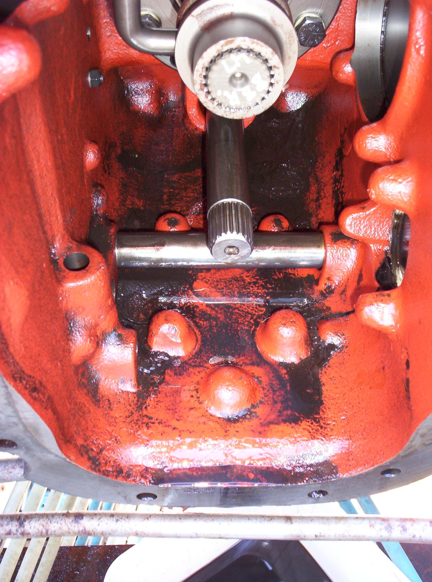

oil- bucket was new, white, clean. What you see is what came out of the rear case
case gunk- just what it is. This pic is after it was cleaned up a little...I tilted the rear end for ward (lowering it) and it drained more. Also wiped out some gunk w/ a shop towl. It was like 1/4" thick...

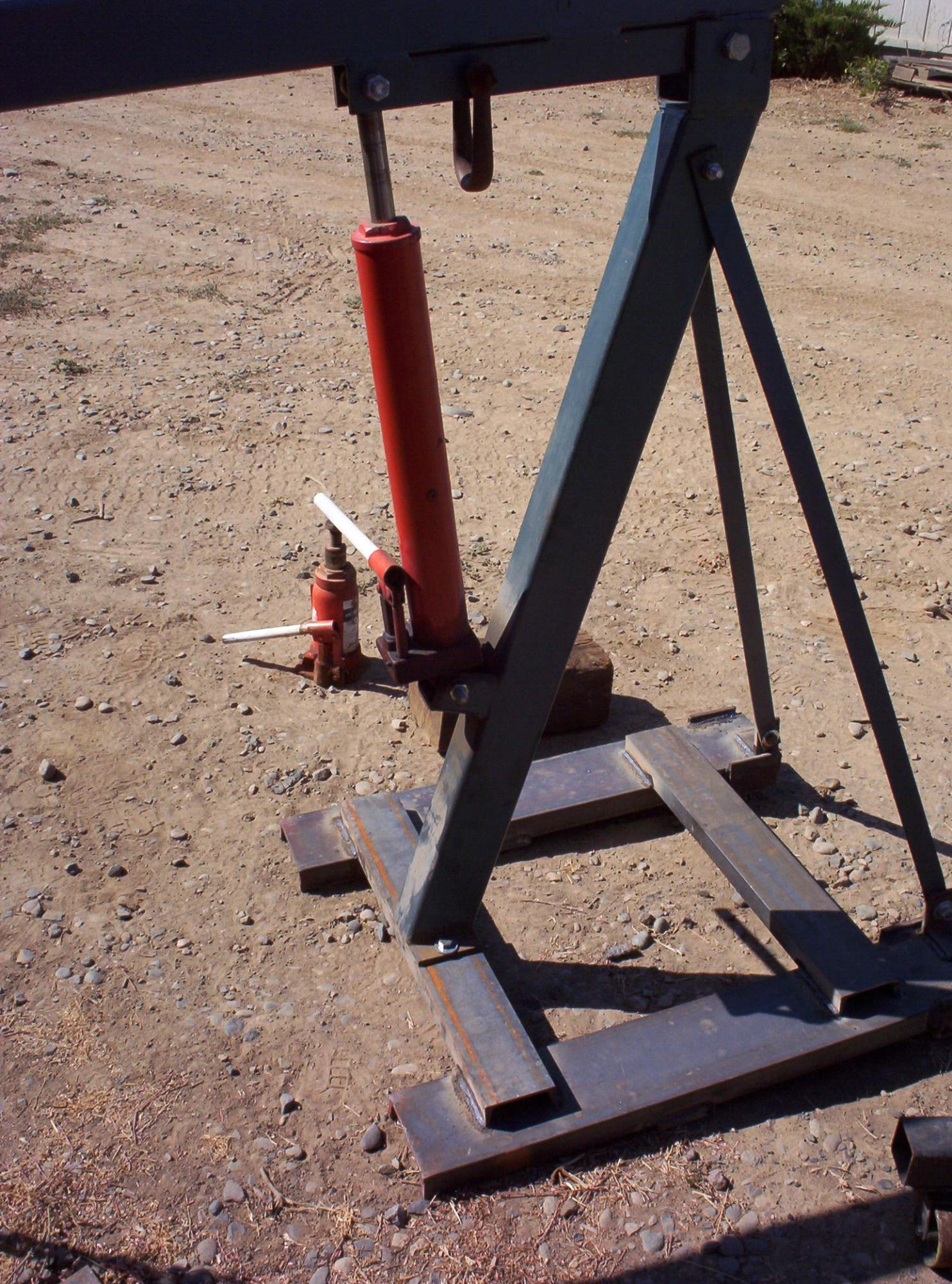

hoist- pick of the custom mount I made for the cherry picker. Goes on to a forklift.....the project couldn't be possible w/out this!
I'll have to pour some clean oil in to see if I can wash out the case. Case drain is stuck, so I'm stuck to letting it drain from the front.....
Was going to assemble engine/tranny on ground, then insall whole. I think it would be a bit heavy to do it that way.... So it'll go up seperately.

The only "issue" I had was, the studs I got were a bit short (4 of the 6). Had to match the studs since the OEM were odd sized. Should have went next size up, but was afraid of clearence issues. The other 4, the stud is just a shy from sticking out of the nut. But the tranny is in. All the thing will be doing is sitting up there. Case is held together primarly by the two top and bottom bolts. Figure I'll check the bolts now and then to make sure they don't work loose. Torque setting was lower then I thought it would be.
The pic, that's my buddy and his brother. The "younger one" was running the forklift, lifting and tilting while we "old farts" lined everything up and hoped not to mash threads and fingers. We were surprised the tranny went in as smooth as it did.
