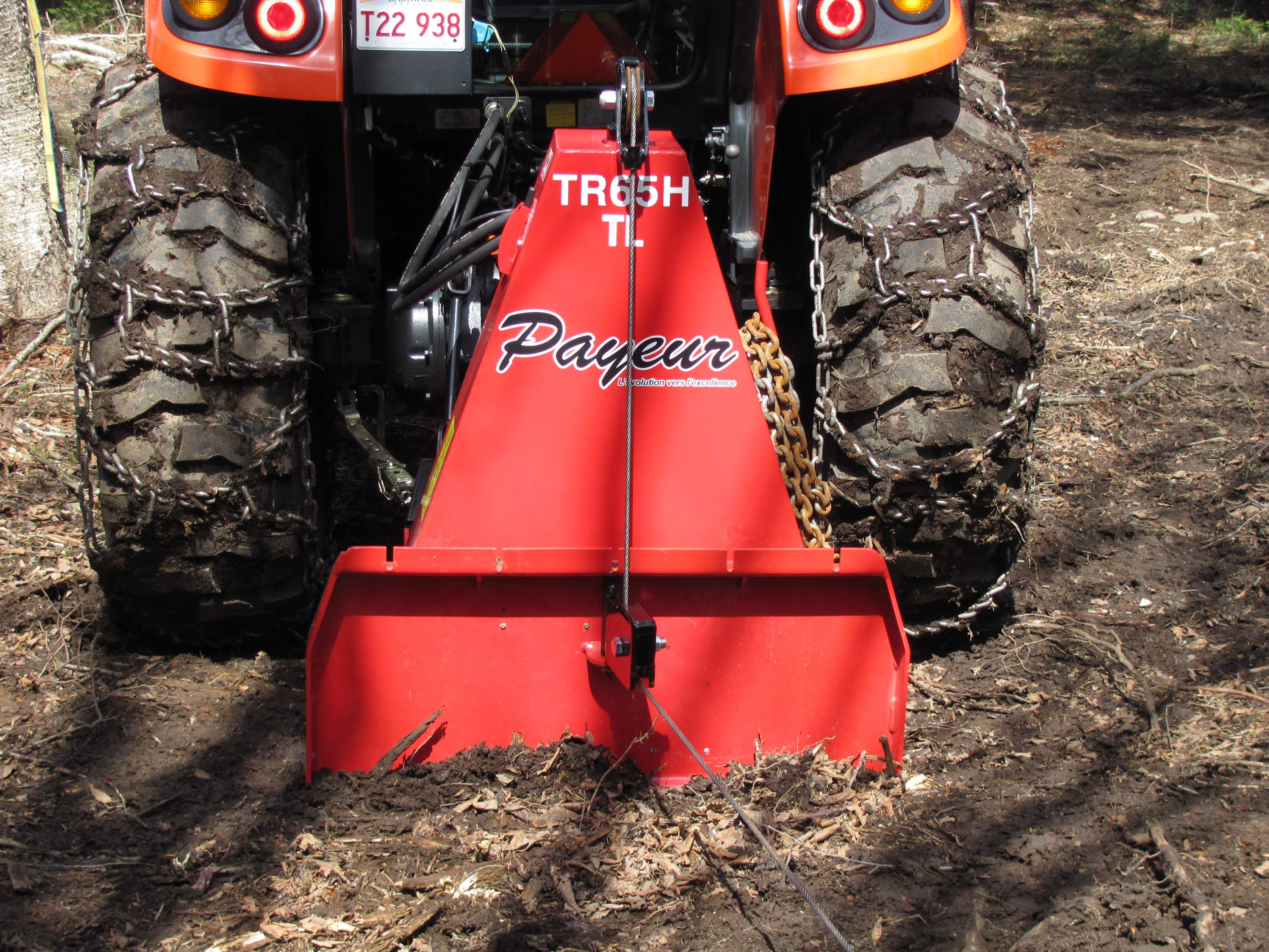

GM,
What is that attached to your 3ph ? :confused3: I'm trying to figure out if it is for pulling something VERY heavy, or something else ? ? :confused: Looks cool ! ! :cool2:
Dave
   / Tire chains on DK35SE with cab #5
GM,
Dave
Thats a logging winch.

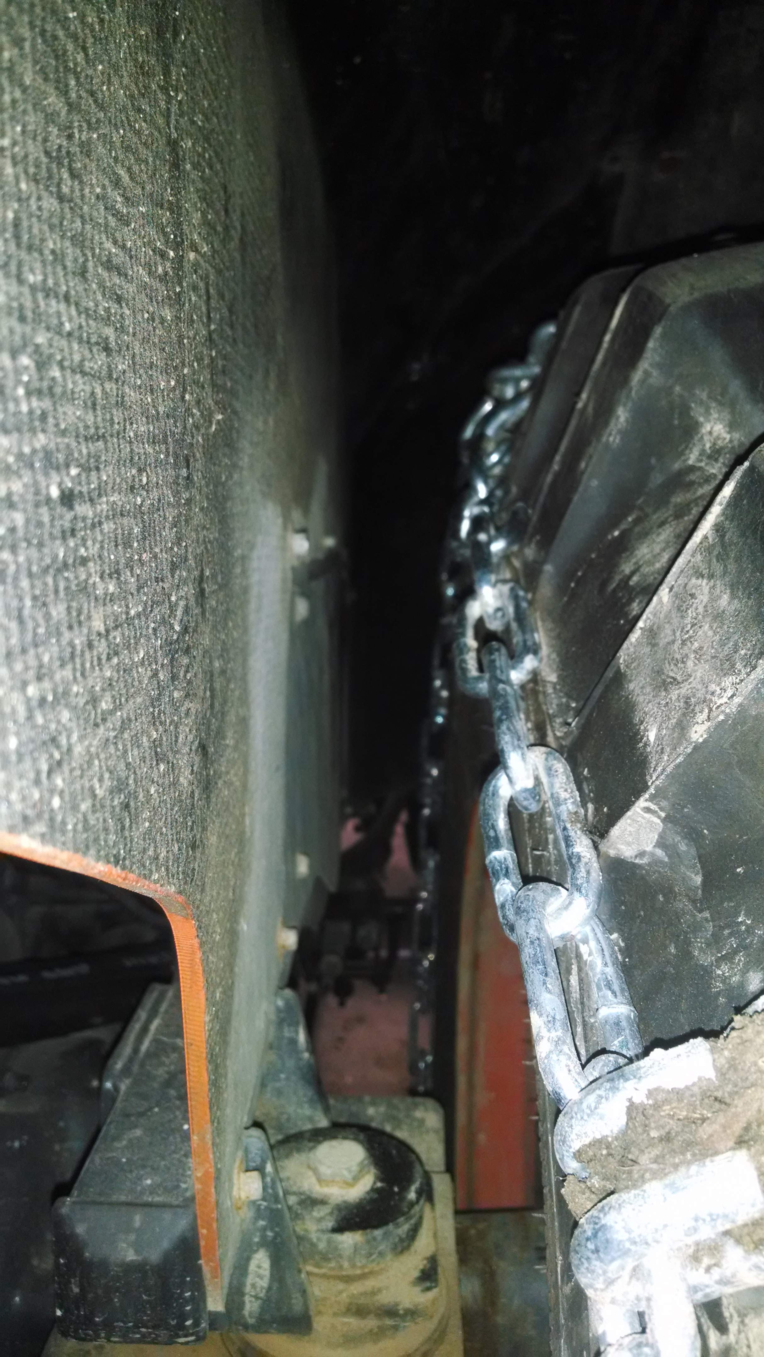

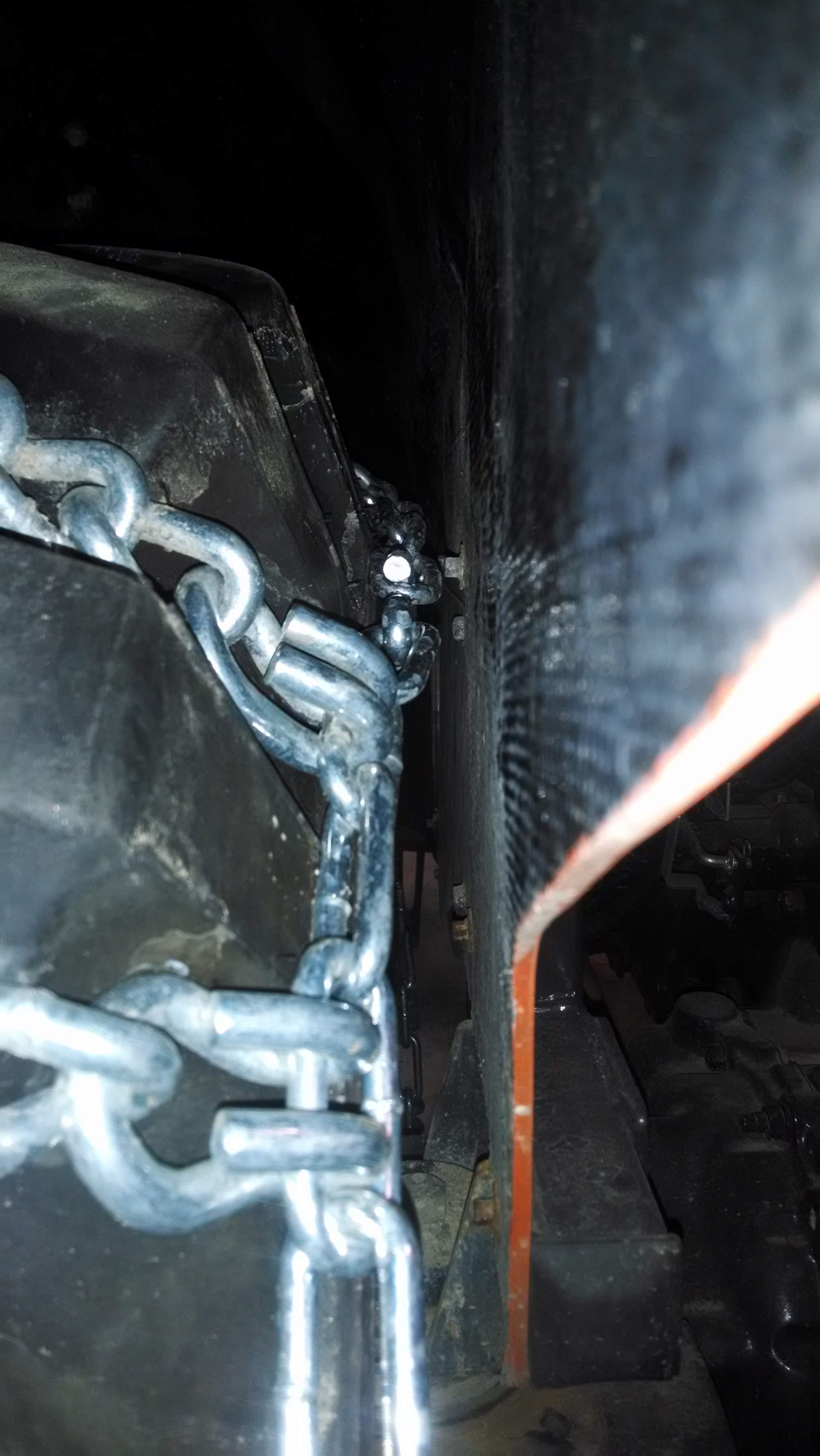

I think the chains TireChains.com or others specify for the 27x10.50x15 will not work on the DK35 with R4's. Here is a link showing my front chains:
http://www.tractorbynet.com/forums/...nly-front-chains-post3135822.html#post3135822
They are small truck chains with the cross links high on the sidewall, and yet have small clearance to the front end components. I was going to order skid steer 2-link square-link ladders for the front. But upon measuring with the old truck chains I had on hand(which were similar in crosschain length) I found they would be too long and interfere with front end components. You also likely want lighter chains with smaller cross hooks for the fronts rather than the heavier DUO's whose cross hooks require more clearance.
Although the suppliers specify chains that fit the tires they don't know if they will work for specific machines.
