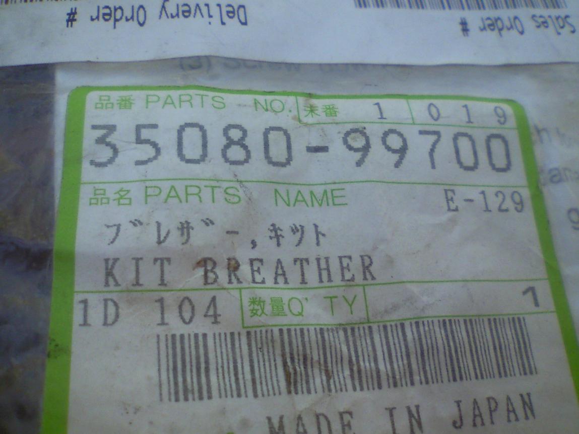

Sorry off topic but...I can try to find the part # they make a front axel vent that stops pressure in the from axel I installed one this summer and not one leak since!! Had been leaking both sides as well as drive shaft seal. You would think Kubota would let us in on these things part was $20.00 bucks from Kubota.

RedNeckRacin, I think the owner's manual specs 80/90W gear oil. I will have to dig that out and check. And Ole Orange, I did not know there was a vent available. My drive shaft seal is dry, at least. The fluid level does not go down very fast. The front tires are always oily, more than anything.
