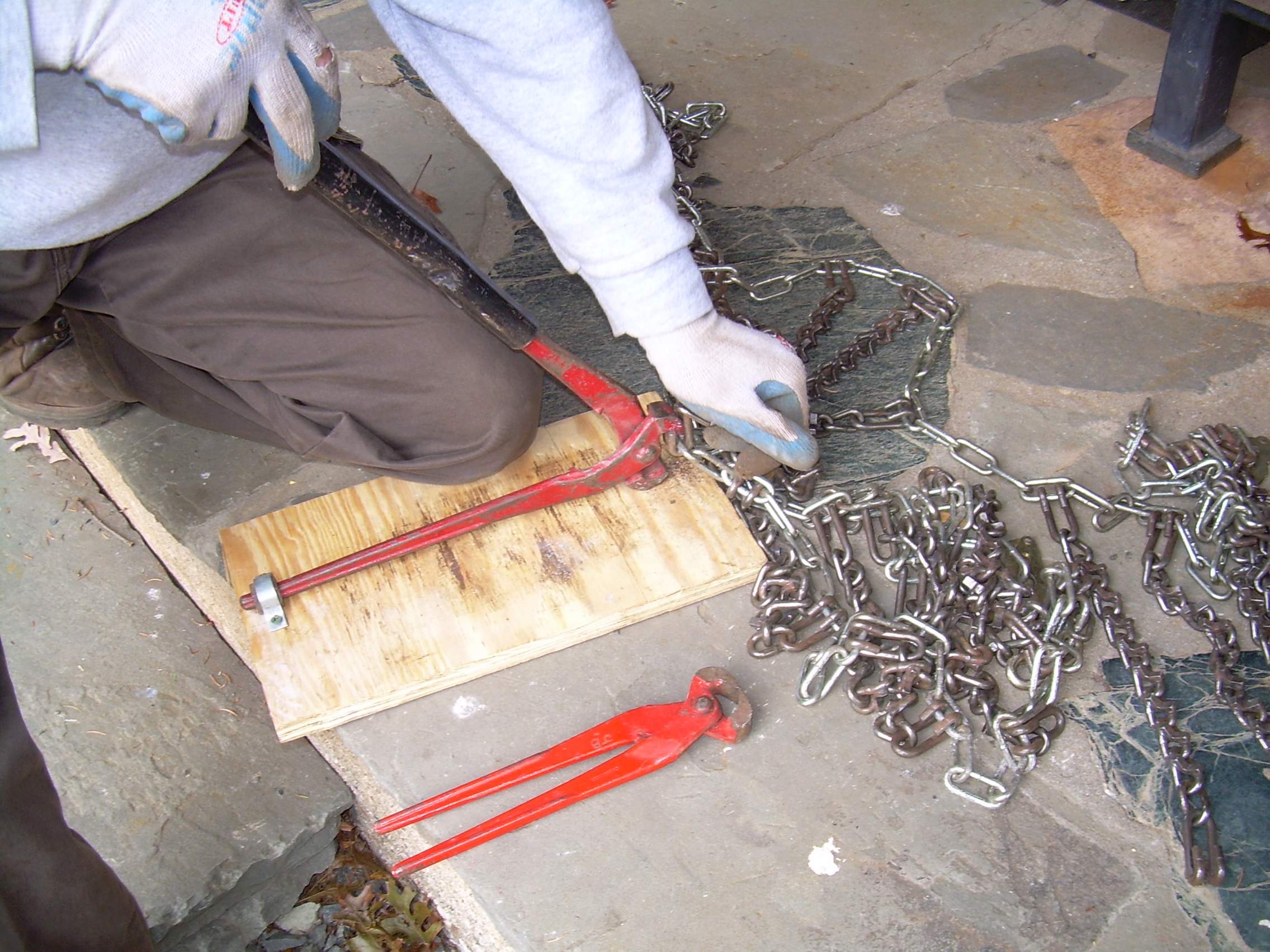

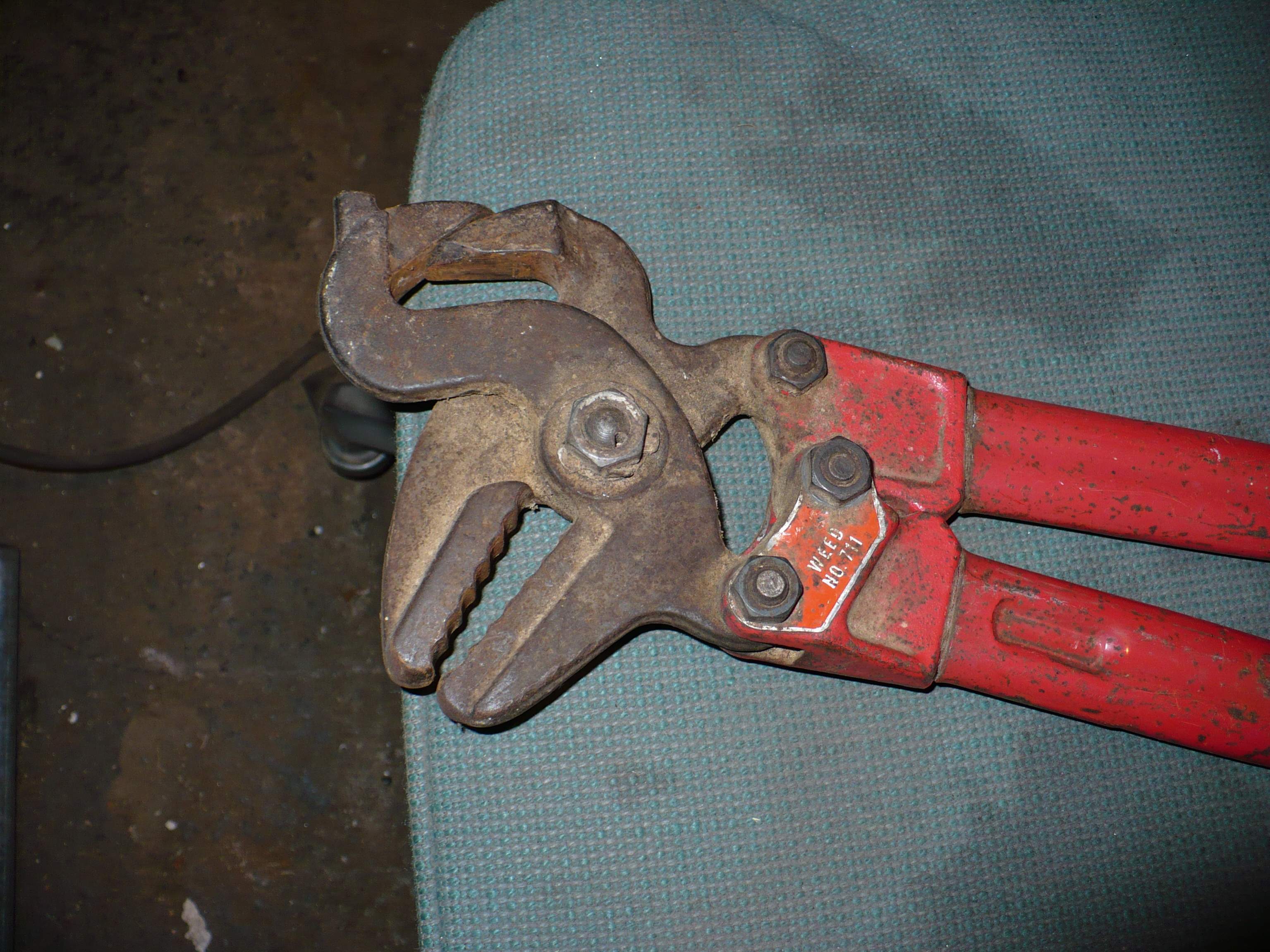

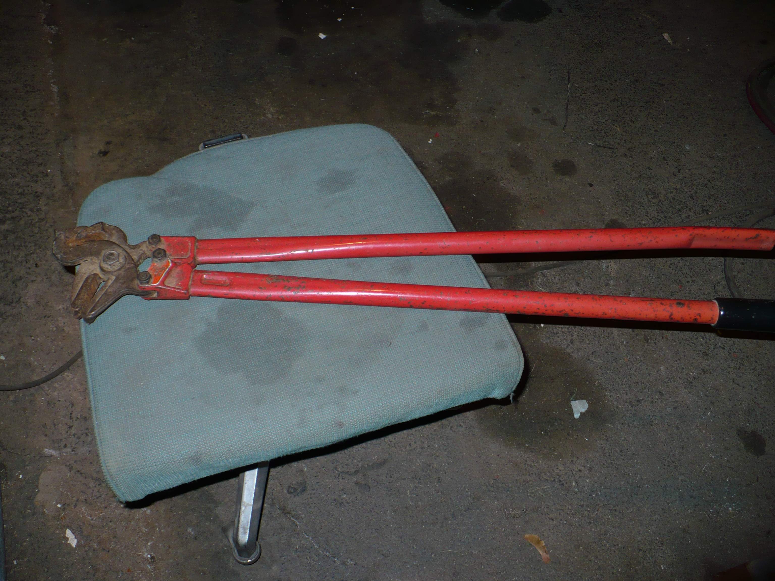

I have a set that was purchased by my grandfather, and given to me by my Dad. They were originally purchased for 20" truck tire chains, but were used on farm tractors, pickups, lawn tractors-you name it. We've widened, lenghtened and repaired chains from 12" to 38". Every time the milk tanker got stuck, we had chains to repair the next morning. Wouldn't want to be without them.

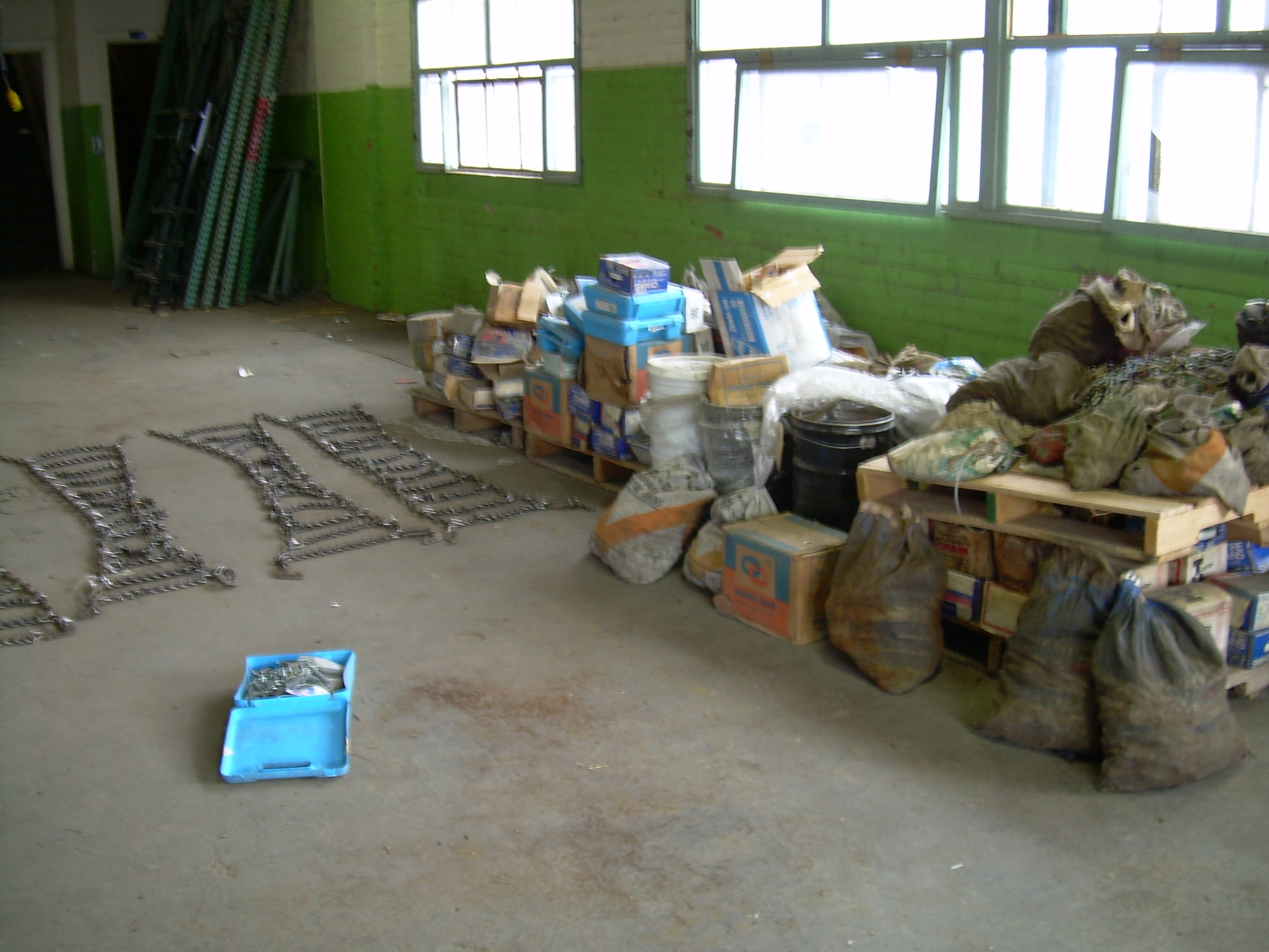

A couple of years ago I found a place selling surplus chain, it was an old auto parts warehouse. I could of bought the whole lot (3 pallets) for little money. but I didn't want it at the time, so I just bought a few sets cheap, had to mod all of them so we made a crude tool of our own.
I'm still kicking myself for not taking the whole lot :(

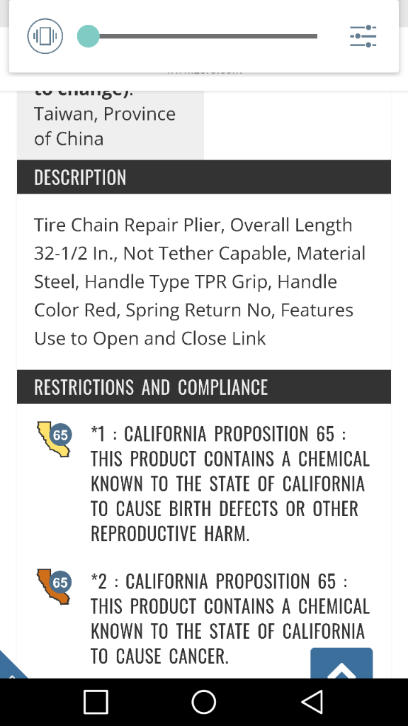

Caution, they cause cancer and birth defects in California
