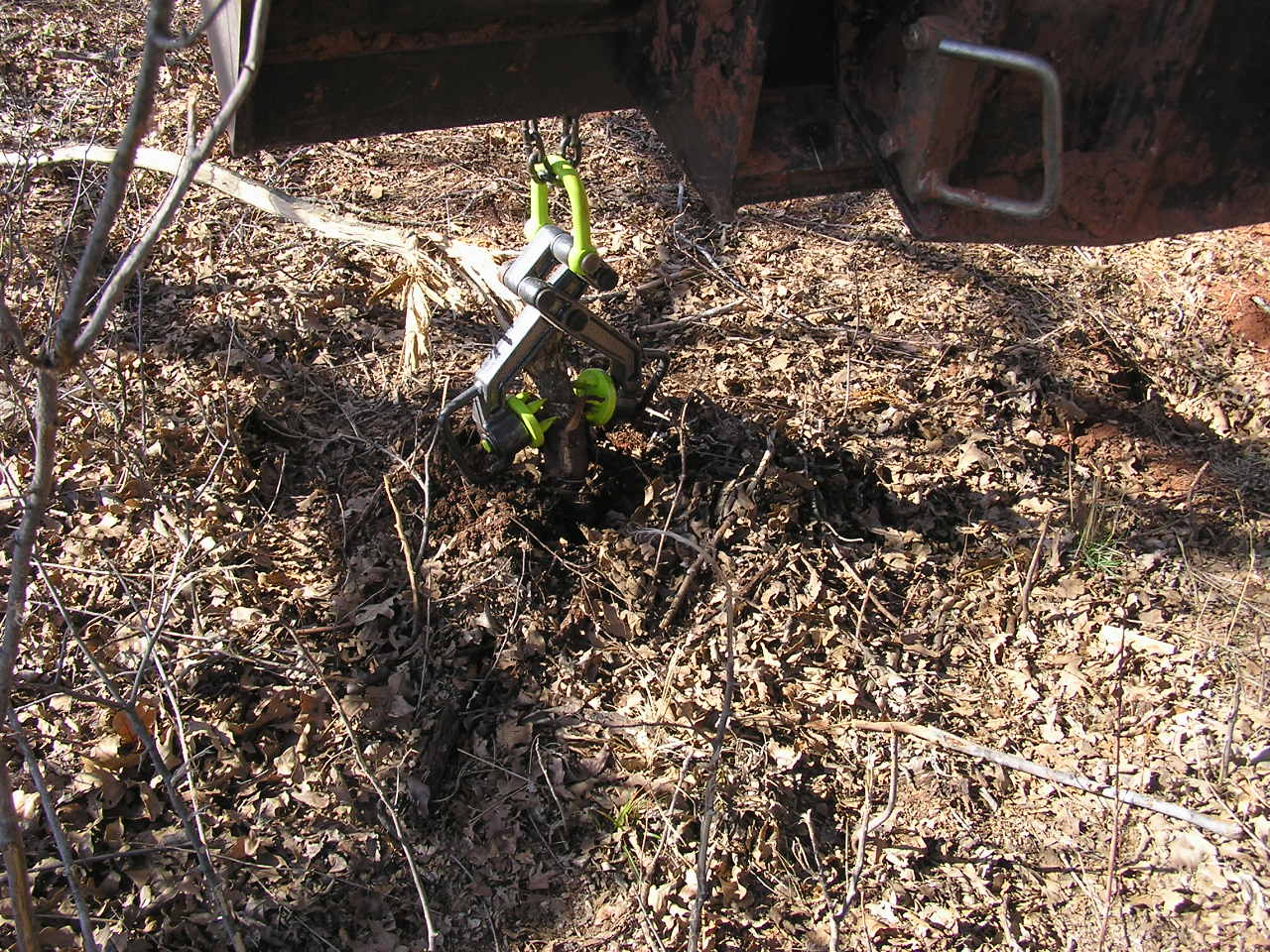

One of the bigger Brush Grubbers should do it: BrushGrubber | Brush Grubber Products
Works on small trees:
