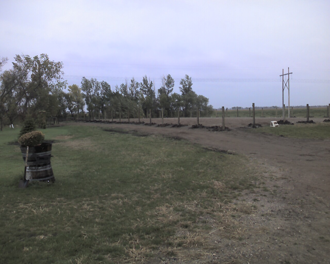

I am building a 140 x 70 outdoor riding arena, which will require about 40 posts. I am putting 5-6" 8' posts, 3' down into clay.
I have found that by using a 6" auger, I can save about 70% of the work involved, by not having to backfill the hole much. (Its terrible trying to backfill clay.) I just drop down a sack of quickcrete around the post. However, when digging that precise a hole, I have found it has to be exactly vertical, since there is too little play to make corrections (which is maybe why people don't do this).
As I drop the auger and drill, the reach on the arm grows, tipping the bit past vertical. I can back up to compensate, but have had difficulty getting it right. I suppose a person could put the bit a few inches in front of vertical, which I might try, after working with a plumb bob to see how far forward the arm moves.
Has anyone already solved this issue, other than using a bigger bit leaving more play? (The one situation where more play means more work.) Thanks for any thoughts.

We have always put the clay back down the hole, but its an incredible job. (Part of our problem has likely always been holes that were too small.) Clearly, the posts are there to stay that way.
However, for a job where a little speed is required, wow, did it work wll to use the pea gravel! Wife and I put in 45 posts in day and a half. Each post will be held to the next with three 2x6 rails. I do not think they will be going anywhere. Worked out great.
